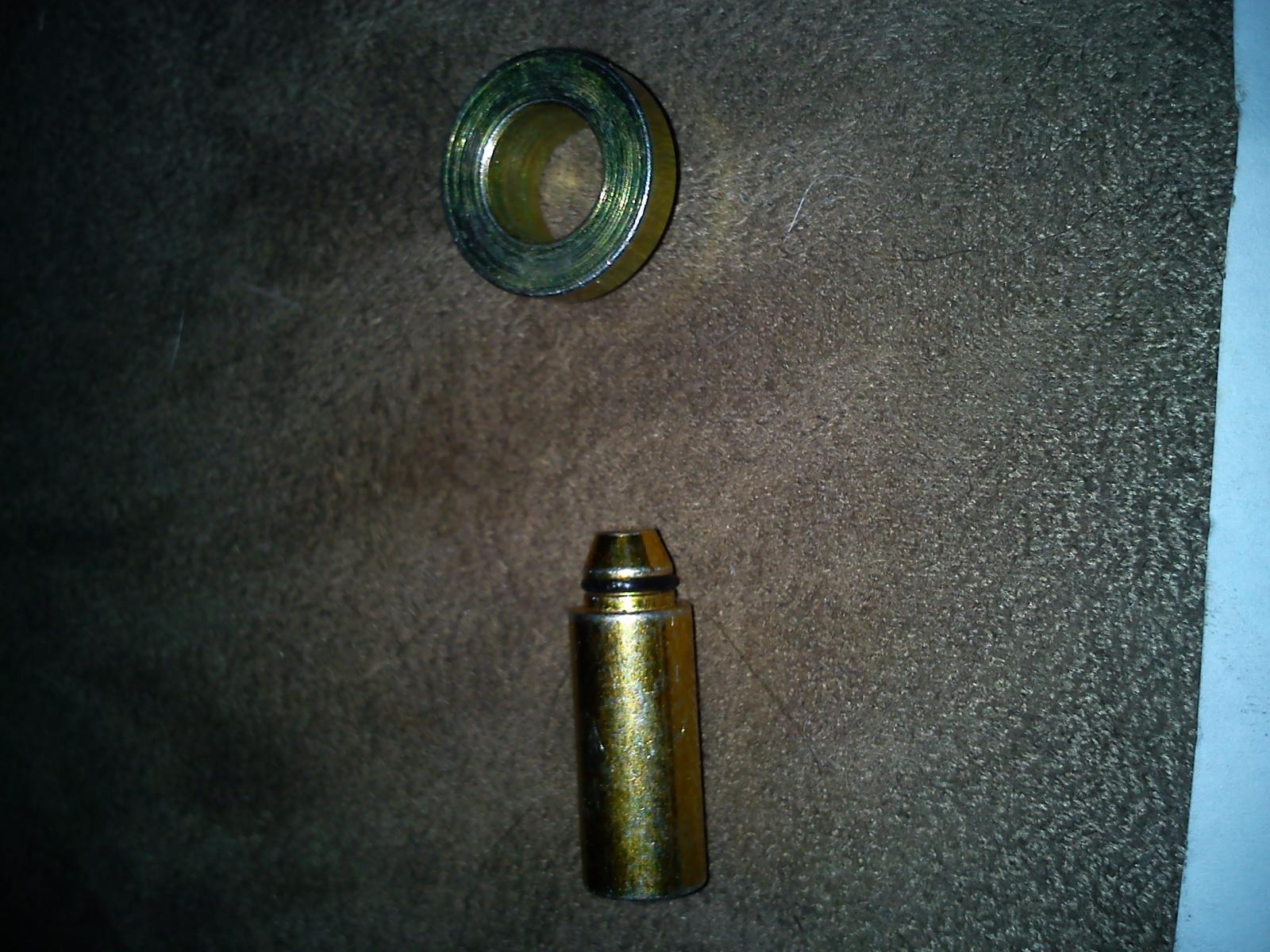

meltboy1 Posted June 26, 2012 Author Report Posted June 26, 2012 Ok, so I changed the vacuum modulator today after reading some posts on tgpforums about a very similar problem to mine and it's better and worse at the same time. It shifts much better but anything over half throttle and I get a shutter like it's misfiring. But when I am in park and revving the engine it revs just fine so I don't think it's a misfire issue, plus I have never had that hapen before either. Â Is it normal with the front end jacked up off the ground for the tires to spin slowly in neutral? Â I used MD28 and it came with a couple extra little parts that I didn't use because it didn't look right with the extension and ring it came with. It didn't look right so I didn't use them. Quote
