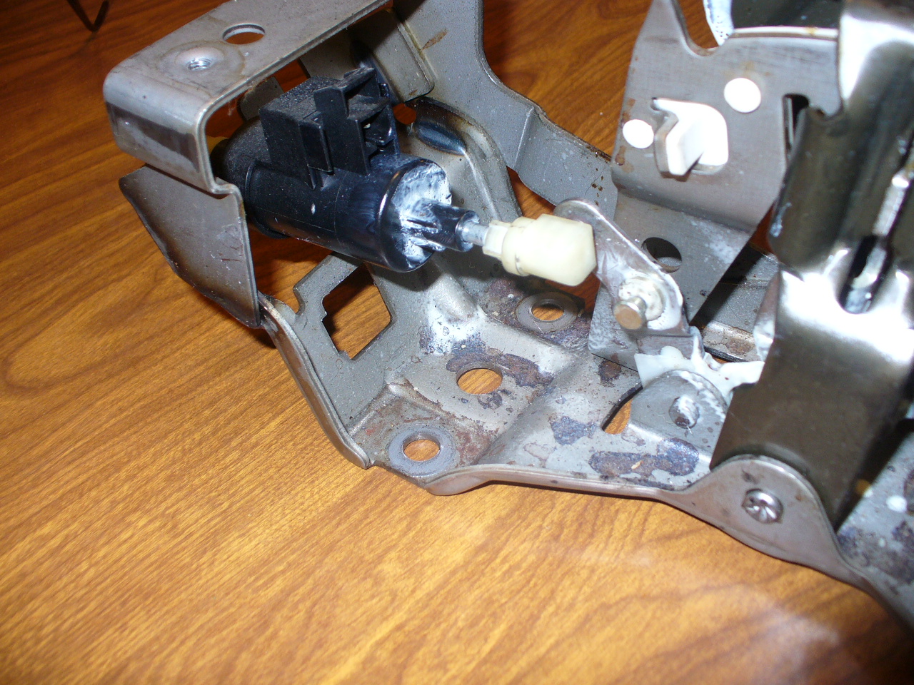

John M Posted May 22, 2012 Author Report Posted May 22, 2012 Update; Took the car to the shop, There was a servo on the shifter prob a $5 part. Well of course a dealer only item where you must but the whole shifter mechanism. Part was $250.00 + 150.00 to install. here are some pics of the culprit. I probably never would have found this on my own. While the car was at the shop I had the timing belt done for the first time. That was $850.00 because the hydro tensioner was needed. Dealer only item for $138.00. You are welcome GM. Quote
1988PhantomFE3 Posted May 22, 2012 Report Posted May 22, 2012 Wow John, thanks for updating us and sorry you had to spend so much... I'll definately remember this in case it happens to me one day. Heck, maybe I should go to the JY and get one of those servo's now! Quote
Crazy K Posted May 22, 2012 Report Posted May 22, 2012 hey all... in the event that that servo was to jamb, UNHOOK IT. probelm solved. Quote
John M Posted May 22, 2012 Author Report Posted May 22, 2012 I see that now. If I had known I probably would have gone with the disconnect option. IF I had only known........... J Quote
