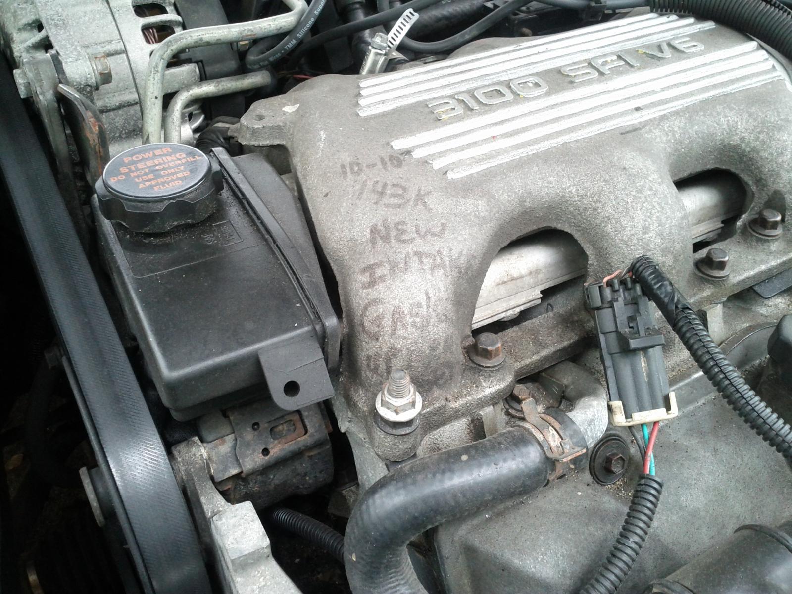

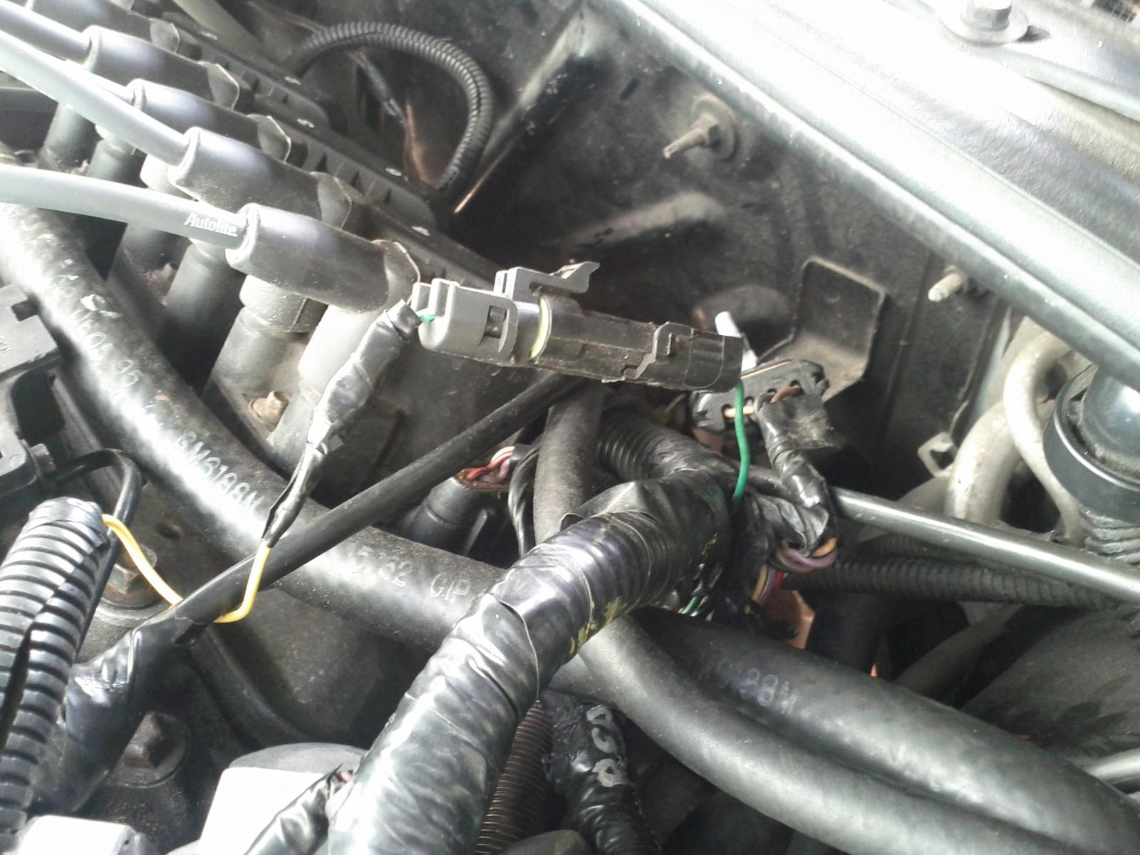

Silentkillzr Posted May 9, 2012 Author Report Posted May 9, 2012 Heres a picture of the temp sender on the tstat, wiring is ridiculous. Never seen anyone write on the intake when the gaskets were done, thats a new one for me lol: Overall motor picture: Quote

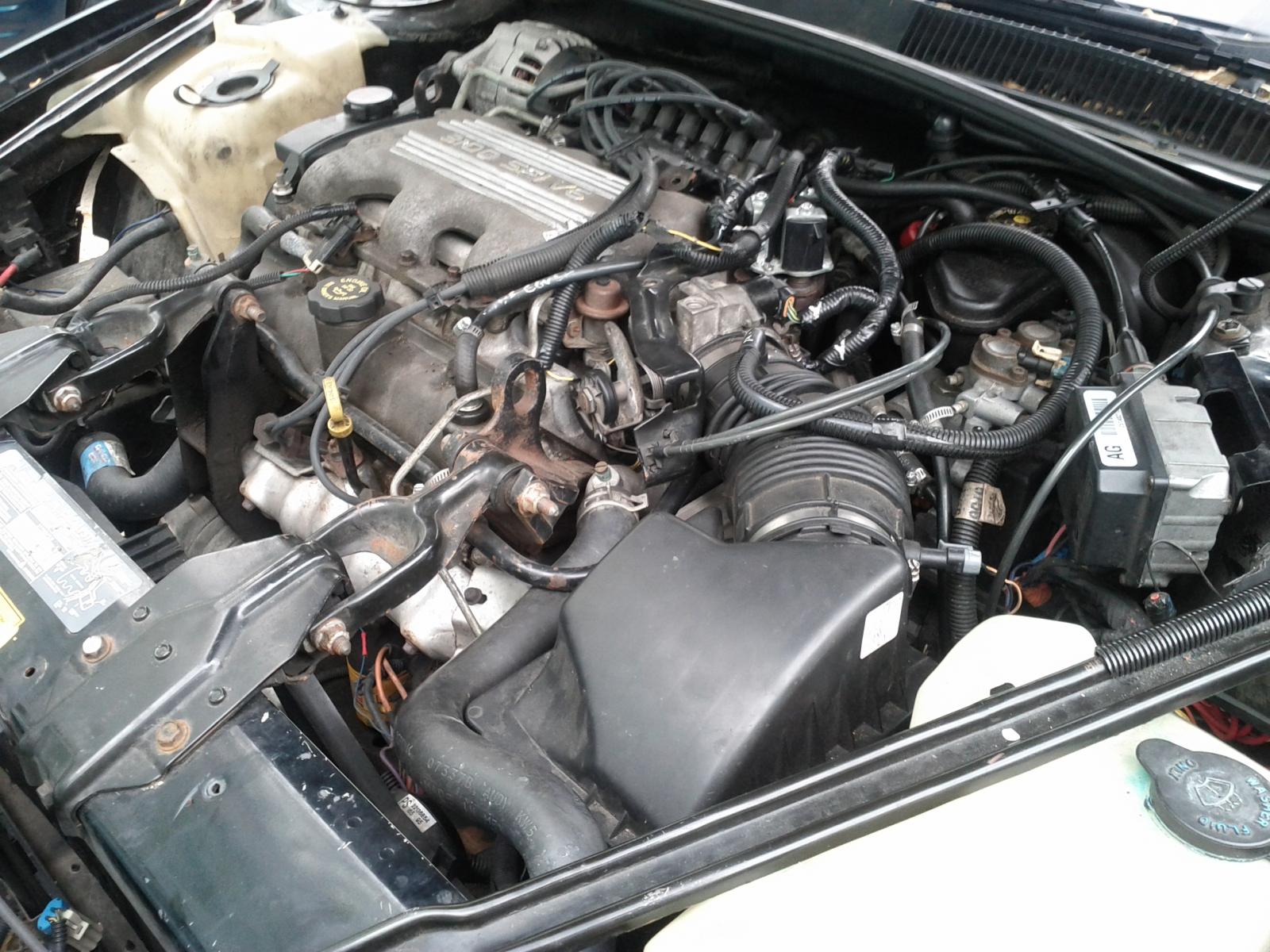

skitchin Posted May 9, 2012 Report Posted May 9, 2012 That temp sender looks a bit nuts - the electrical tape makes me think there's almost no way you're not going to have a problem. Also, not important but you could probably tuck your wires a bit better. Don't have a full engine bay shot, but here's a partial Quote
RobertISaar Posted May 9, 2012 Report Posted May 9, 2012 yeah, pull all the tape off, see what exactly they did, because that looks screwed. much better to have the ECM at least know the actual coolant temp and have a non functional gauge than to have both be wrong. Quote

Silentkillzr Posted May 9, 2012 Author Report Posted May 9, 2012 Yeah... I am going to tuck everything nicer next time i work on it. Clearly the PO did not know the right way around a GM. lol... I am pretty sure the temp gauge only reads accurate when the car is off but key in on position. Where is the temp sensor for the gauge again and what color wires run to that? Quote
revnrob Posted May 9, 2012 Report Posted May 9, 2012 Try in the C100 connector, Position G2, I think it's a dark green Quote
RobertISaar Posted May 10, 2012 Report Posted May 10, 2012 it does eventaully hit the C100 connector, but starts off from a little "stud" on the backside of the head. if it's not present, then it sounds like the heads at least were swapped from a 96-up engine, since 96 did away with the dual sensors and used a single 3 wire or 2 wire sensor, depending on the application. Quote

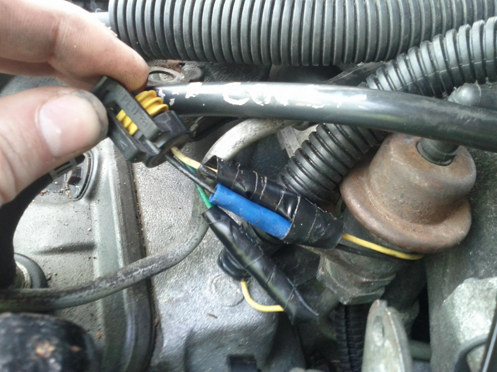

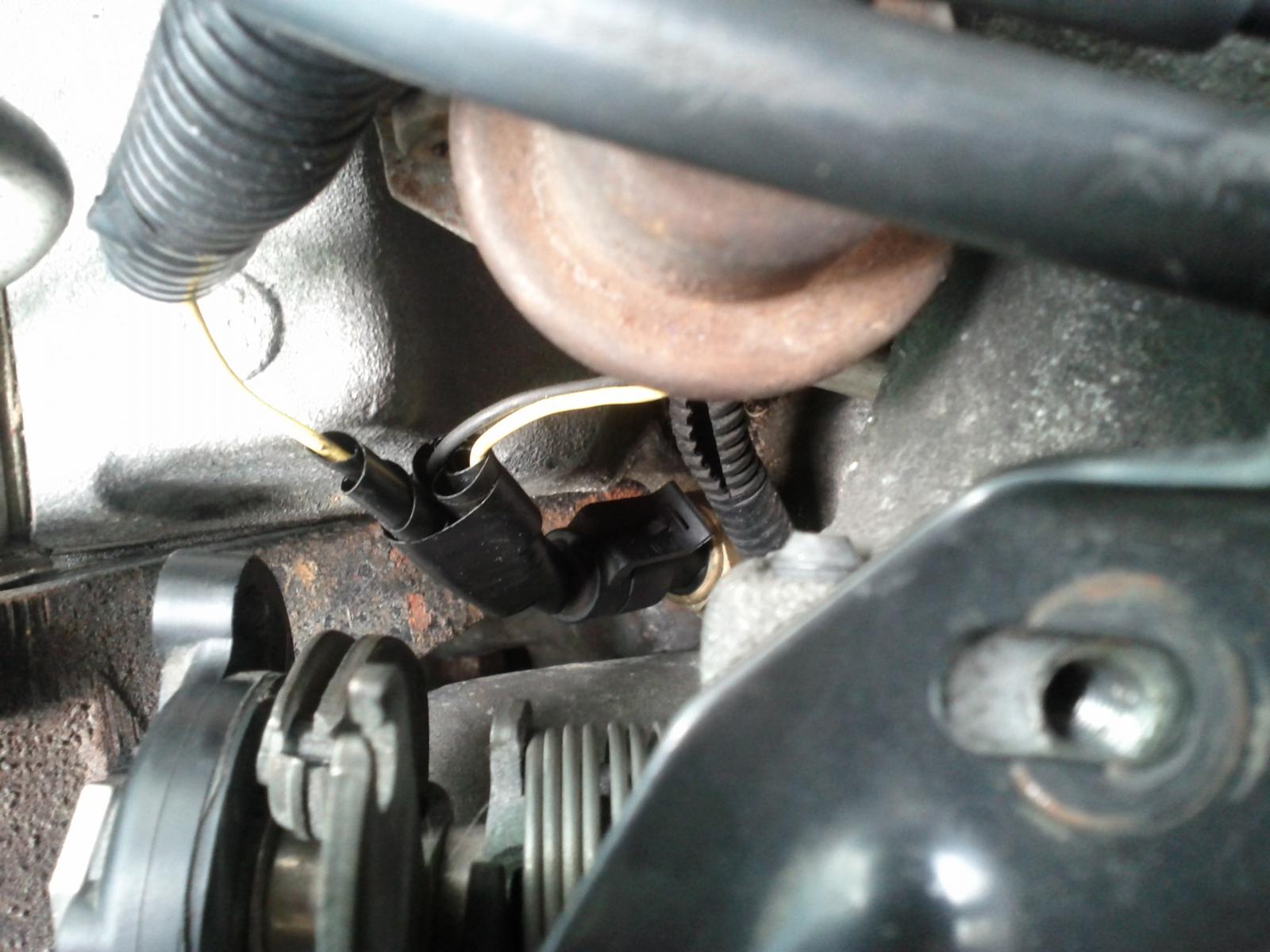

Silentkillzr Posted May 11, 2012 Author Report Posted May 11, 2012 (edited) I am checking this out today, ill get back to you guys with results and pics thanks fellas UPDATE: The sensor turned out to be a 3 prong temp sender, dont worry about two yellow wires, the one is spliced into the green on the harness to the temp gauge. Apparently they wanted to use yellow instead of any other color... regardless i cleaned up the connections and the temp gauge seems to work better, car runs better now, no hesitation really. Now the car still surges, im going to flush the trans and do the fuel filter and see what happens. Am i correct that there is no MAF on my car/motor? Also i did not see a sensor on the back of the heads. Edited May 12, 2012 by Silentkillzr Quote

Silentkillzr Posted May 12, 2012 Author Report Posted May 12, 2012 I've heard a bad brake switch can also cause it to do this - in my car it was like overdrive would engage and then disengage rapidly. Various things were replaced on my car but I think it wound up being a bad ignition coil that caused it. ill check that out thanks man. Can someone take a pic of their 95 gp engine bay with a 3.1... I'm pretty sure im supposed to have a MAF but there is not one existent on my setup.. Haynes manual shows a maf but there isn't one on mine, Shows it before the airbox. Dont see any wires just chilling so im lost. Quote
RobertISaar Posted May 12, 2012 Report Posted May 12, 2012 93-95 3100 W-bodies do NOT use a MAF. Quote
