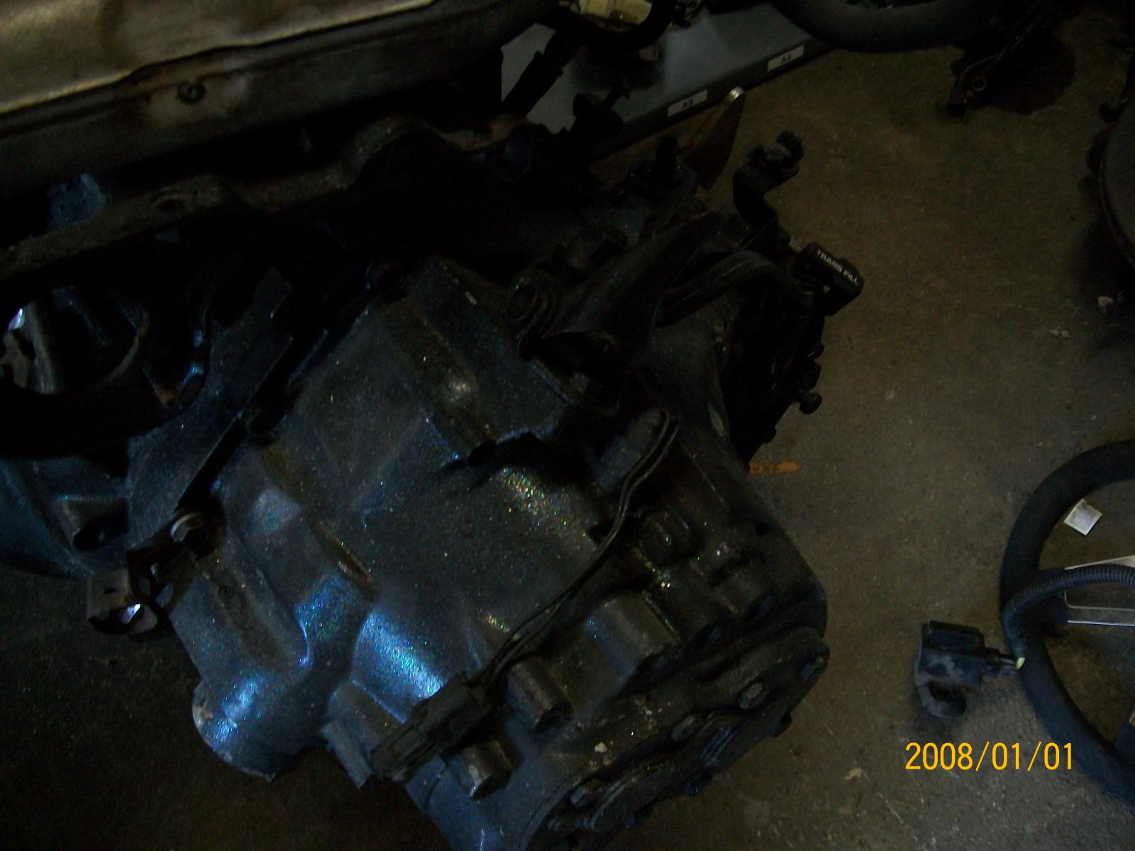

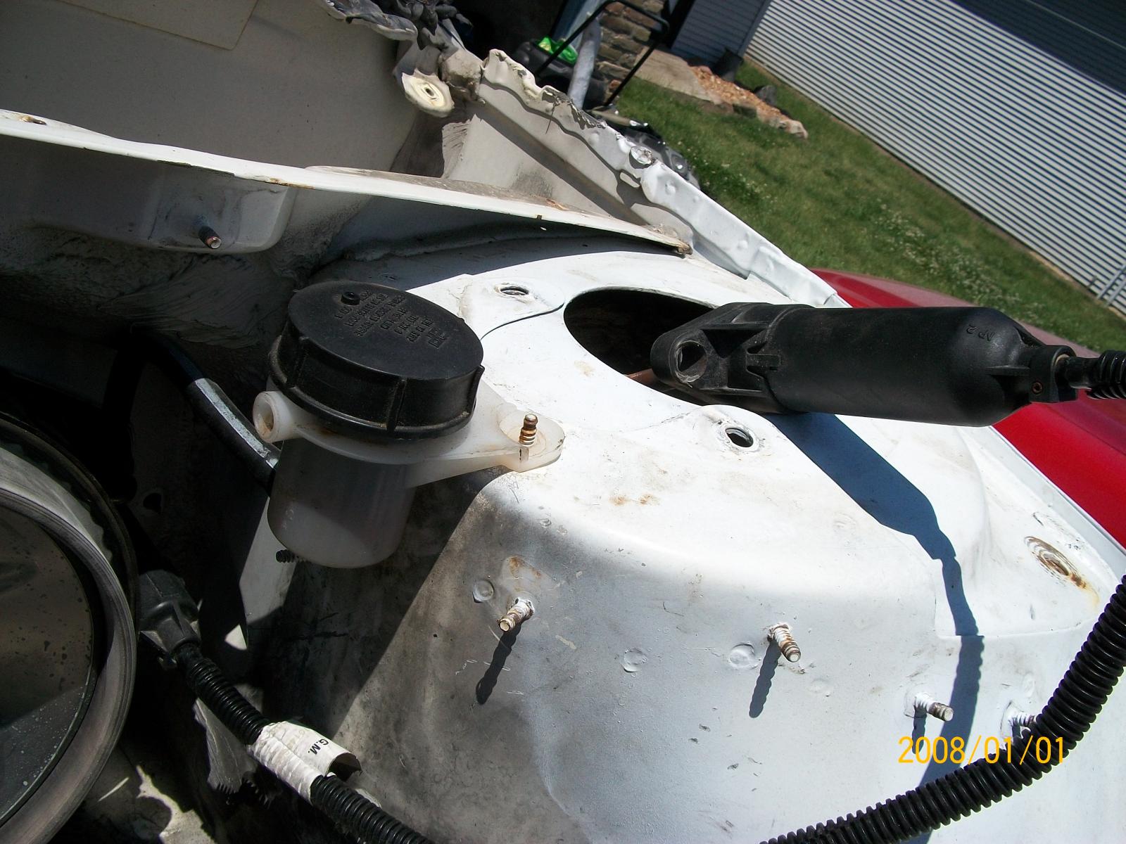

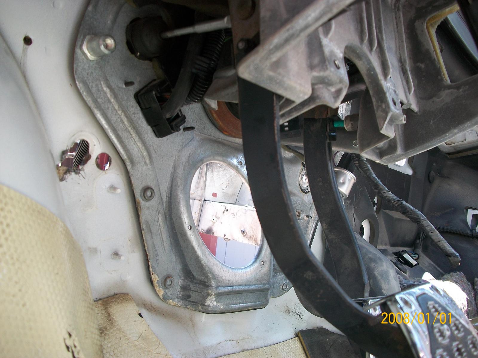

pshojo Posted June 13, 2012 Author Report Posted June 13, 2012 I found 282 trans with everything (clutch system, mounts, brackets, pedals, cables, shifters) $500. Now, trying to figure out to run it on the 3.4 DOHC or L26. ? Quote
19Cutlass94 Posted June 13, 2012 Report Posted June 13, 2012 What you mean how to run it on there? get a clutch, flywheel and bolt everything right up. Then tune for it in the computer. Probably need a custom intermediate shaft bracket though. Quote
pshojo Posted June 13, 2012 Author Report Posted June 13, 2012 i have two cars, one that is DOHC and one that i'm doing L26 swap. Which engine would you put the 282 with? Quote
Bake82 Posted June 14, 2012 Report Posted June 14, 2012 L26 need to worry about oil filter adapter and intermediate shaft bracket. 3.4 need to do intermediate shaft bracket. I vote 3.4. Quote
pshojo Posted June 19, 2012 Author Report Posted June 19, 2012 I found the 282 with all parts for the swap. I pick it up on this weekend. I also found a Reatta in the yard a couple hours away. I'll pick up the oil filter adaptor also. Quote
pshojo Posted June 25, 2012 Author Report Posted June 25, 2012 I picked up the transmission today. Long drive up to Racine and back. But i think i have all the parts for the trans mission. Quote
