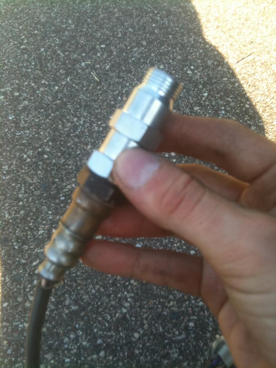

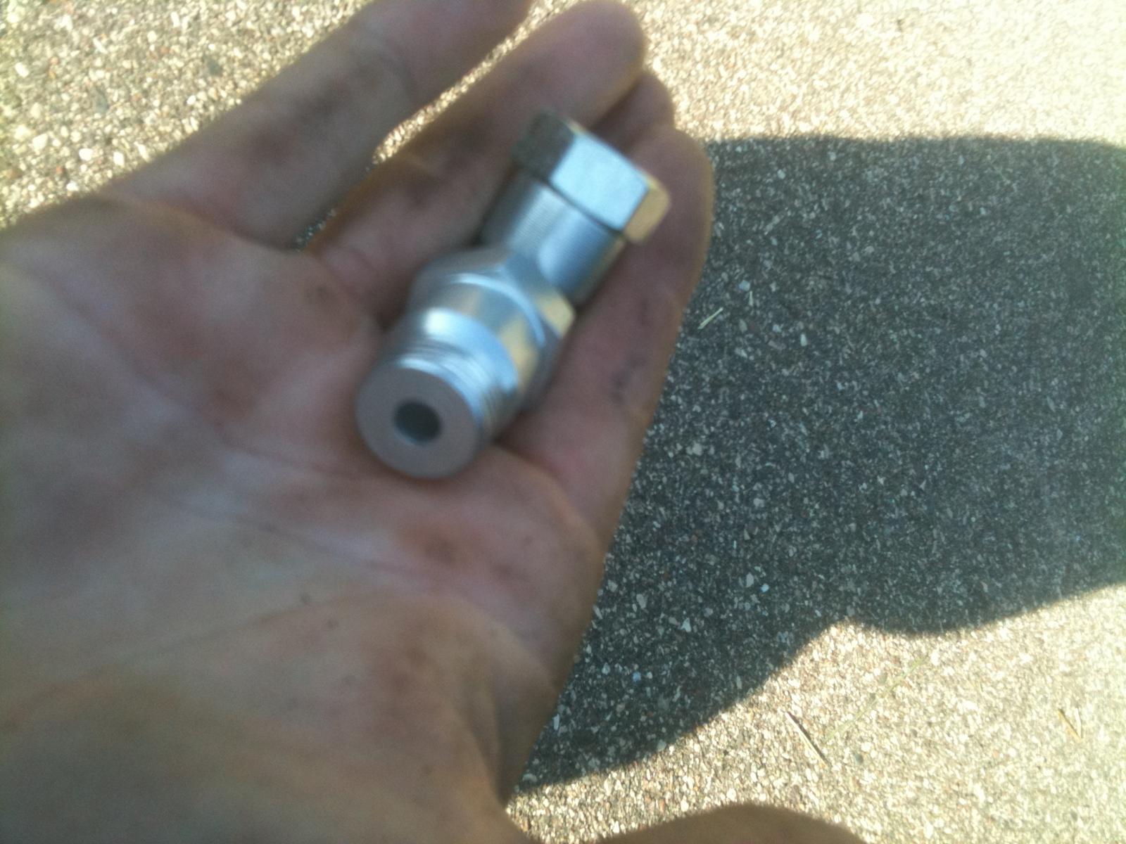

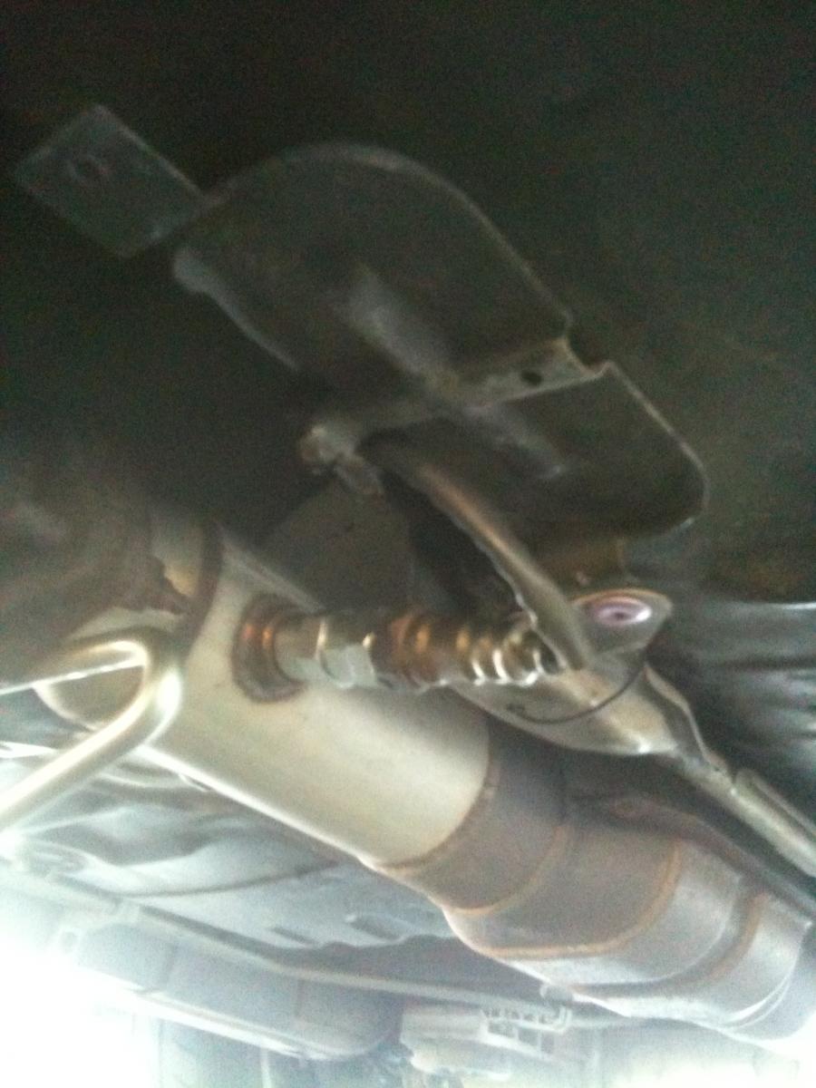

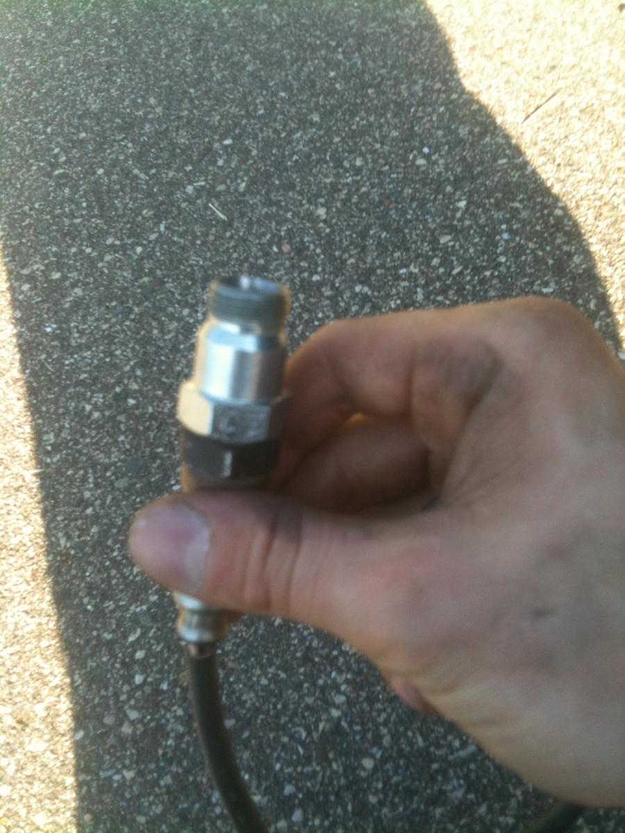

Addicted To Boost Posted May 17, 2012 Report Posted May 17, 2012 use a spark plug de-fouler, they work well from what I've seen. http://forums.evolutionm.net/evo-how-requests-questions-tips/114931-how-install-spark-plug-anti-foulers-remove-ses-cel-light.html I did this to my GP today... so far, no more check engine light! I bought a package of 2 of them, drilled one out so the O2 will thread all the way in and have a small amount of airspace around it, then threaded the O2 and both of the anti-foulers together and installed them in the exhaust. Pics below: Quote
alec_b Posted May 17, 2012 Report Posted May 17, 2012 Did this trick on my old '99 Caddy after I gutted the cat. Worked like a charm! Quote
