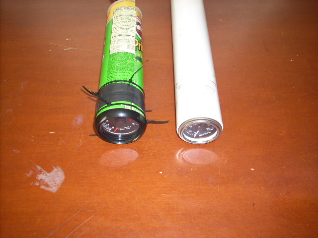

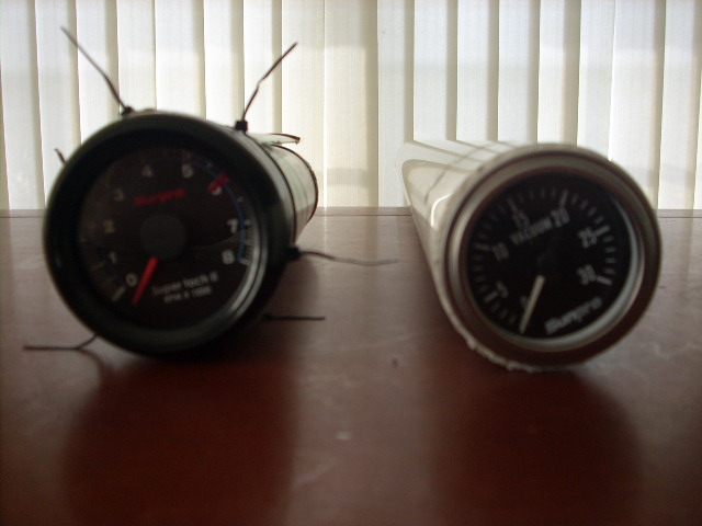

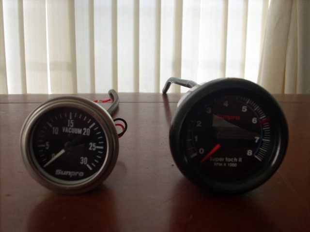

3.1 95' Lumina Posted May 7, 2012 Author Report Posted May 7, 2012 Just a little update on the gauge install. Got my 2" PVC for the vacuum gague. The guy at my local Ace Hardware gave me 3 feet for a buck For the Tach, i couldnt find a piece of pipe to fit that so im using a Pringles can. Then im fiberglassing the entire pillar and painting it either the interior color or a flat black to match the faces of the gauges. As for the routing of wires through the firewall, I still havent found a hole to route them through so im just going to drill a hole right by the floorboard and route them through there. Quote
3.1 95' Lumina Posted May 7, 2012 Author Report Posted May 7, 2012 Here are some pics of what im working with. Quote
