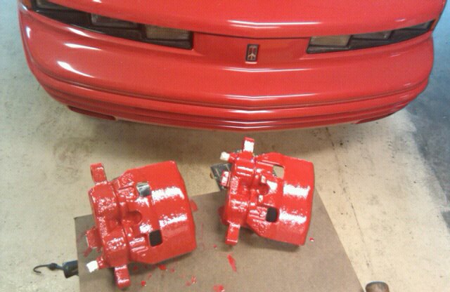

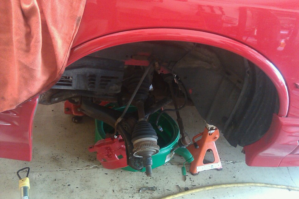

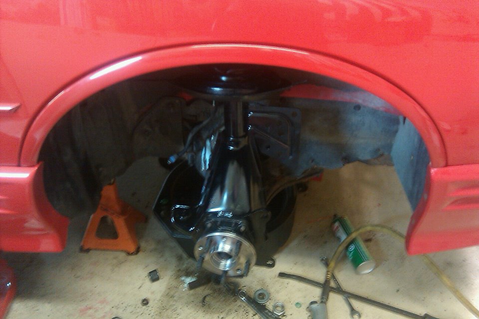

pshojo Posted May 20, 2012 Author Report Posted May 20, 2012 I've started my Cutlass Vert project. First thing was to upgrade the brakes to 96 11" brakes. Pulled out the old struts assemblies and replaced with 96 Cutlass with FE3 suspension. Took them to have sandblasted and painted with epoxy. Replaced the wheel bearings while I was add it. Also replaced front calipers and painted with Epoxy brushed paint. Quote
