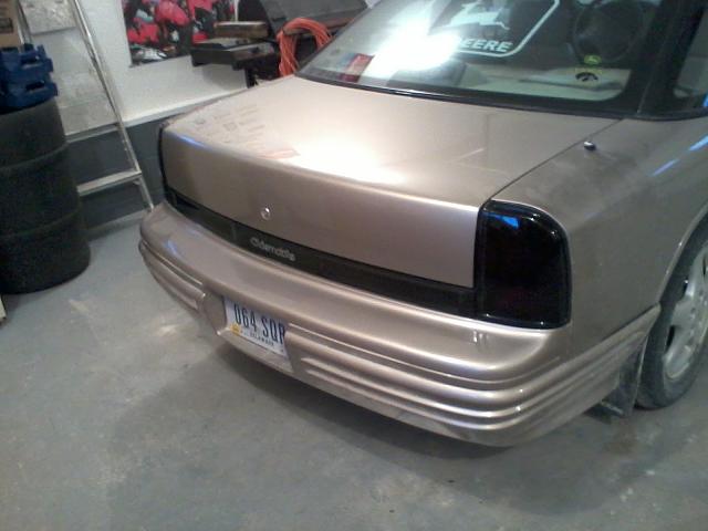

oldscsc Posted May 1, 2012 Report Posted May 1, 2012 (edited) Sprayed is the only way to go. As has been said, it takes a LOT of applying and sanding to get Niteshades to look good (glossy). On to the (non-W) pics, sorry... Excuse the gross bumper, it's gone now Edited May 2, 2012 by oldscsc Quote

pshojo Posted May 2, 2012 Author Report Posted May 2, 2012 That does look nice. I am thinking that blacked out lights would look good on my all black Cutty. What brand of spray did you use? Quote

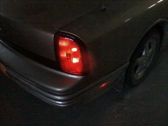

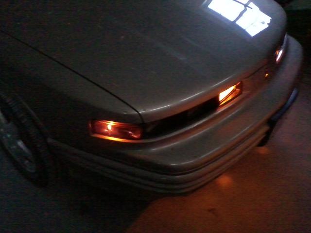

mhildebrand Posted May 2, 2012 Report Posted May 2, 2012 I went with the VHT, wetsanded before and between the 2 coats. Then 6 coats of clear, wetsanded between coats again, and after the final. Then buffed them with polishing compound. all lights have the stock bulbs in them. The inside turn hadnt been tinted yet in the pictures. Quote
pshojo Posted May 2, 2012 Author Report Posted May 2, 2012 Looks nice, especially with the indicator and running lights. what sand paper grit do you use for wet sanding? Quote

mhildebrand Posted May 2, 2012 Report Posted May 2, 2012 800 in between coats. i used 1000 after the final, and then buffed and waxed Quote
