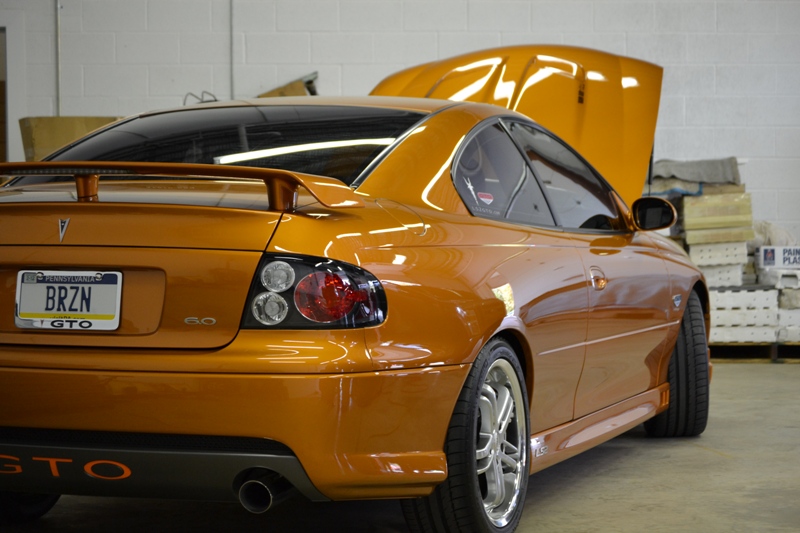

BRZN Posted April 30, 2012 Report Posted April 30, 2012 (edited) Don't have a polisher? Don't go out and buy a cheap one, save your money for a decent one. Also, you'll never remove swirls by hand, you can make them a bit better/less noticable but won't completely remove them. I use my DA (Dual Action) set at 5,000 OPM (oscillations per minute) and can spend an entire weekend Friday through Sunday on a full correction with those speeds: try to get 5,000 OPM by hand! I use a cleaner wax under my rocker panels and on my front bumper sometimes when I didn't remove all the bugs while washing and don't want to bother with claying and waxing. It's also pretty good as a tar remover. Cleaner waxes have fine abrasives in them and can marr the paint, so if using one, start in an inconspicuous spot. There's enough abrasive in them to clean, not polish. By hand a recommendation would be: Wash Clay Glaze to fill minor imperfections Wax, one coat would be fine, two better, of a good quality carnauba wax. This has been machine polished and has two coats of Adam's Americana paste wax with a coat of their Brilliant Glaze overtop: Now that's shiny! Edited April 30, 2012 by BRZN Quote

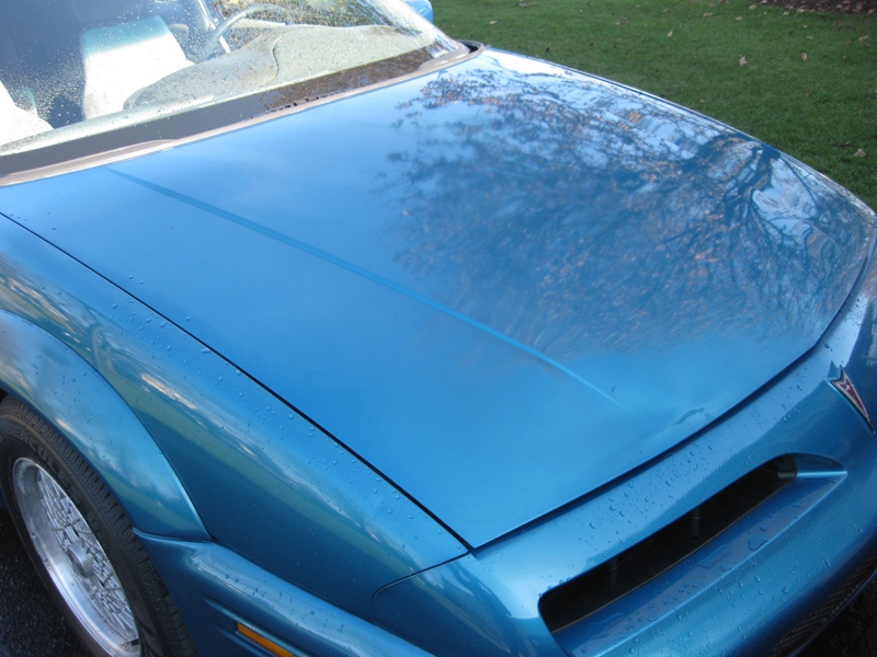

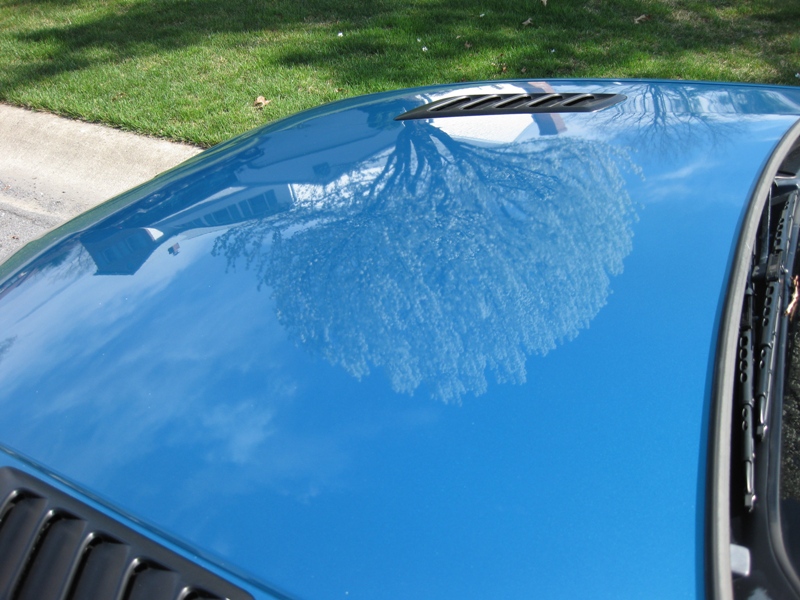

BRZN Posted April 30, 2012 Report Posted April 30, 2012 What the hood looked like when I picked the car up last fall: What it looks like now: 18 year old paint. Washed to remove loose surface dirt. Clay Bar used to remove imbedded surface contaminents in the paint. Machine Polish with a Flex XC 3401 VRG along with Adam's three step process: http://www.adamspolishes.com/p-738-adams-basic-flex-xc-3401-vrg-polisher-kit.aspx I did first wet sand out a couple of the deeper scratches and started polishing with Meguiars 105 on a yellow pad before going through the Adam's products. Topped with a liquid carnauba wax. You'll get out what you put in. There really are no short cuts to really nice looking paint. Quote
