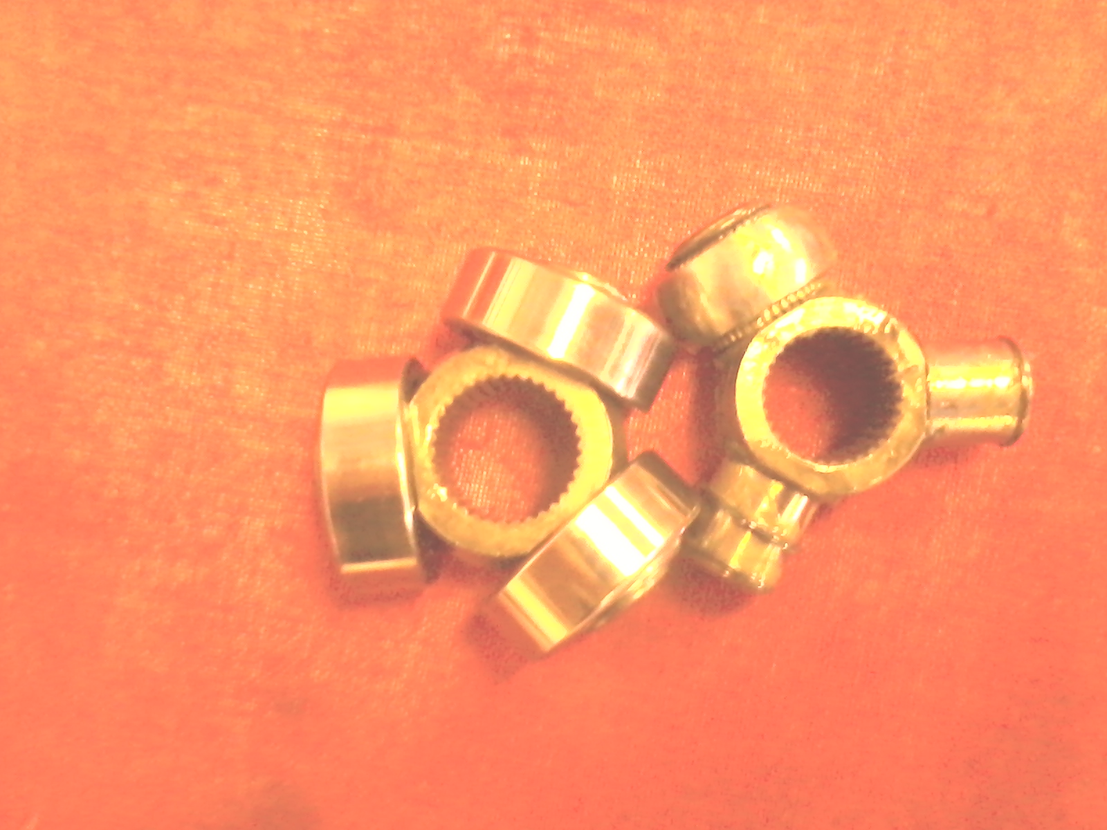

Imp558 Posted April 2, 2013 Report Posted April 2, 2013 (edited) So this weekend the Regal is getting the L67 / 4T65-E HD swap finally. From reading through posts I had the idea that I could swap the tulips from the Park Ave Ultra axles and put them on my axles but you can see in the image the shaft sizes were different, then I put a micrometer on the bearing carrier thinking I would swap the bearings one needle at a time but they were .040" different so no good. I understand the 1998-1999 Monte/Lumina axles work but they don't have ABS reluctors. What's next? Also can anybody tell me if this Gen III Aluminium oil pan is the one that will not fit even with notching the engine mount? Thanks in advance 1996 Regal stock is L36/4t60 Edit, just checked and the 1998 Monte uses same right shaft as my current part number, and the left one has only 34 splines where my tranny has 39 on the left. Thoroughly confused now..... Edited April 2, 2013 by Imp558 Quote
rich17 Posted April 3, 2013 Report Posted April 3, 2013 You need a GTP Inner tulip onto a stock axle. Also i believe the oil pan needs alot more than that to fit Quote
Turbocharged400sbc Posted April 3, 2013 Report Posted April 3, 2013 (edited) rich is right you need the gtp inner tripod and tulip aluminum pan just needs the bracket ground/notched to clear, there is only one aluminum pan part number, if you put the horse shoe up to it youll see where ya gotta grind it, you wont have to grind the steel bracket as much if you hit the aluminum pan with a grinder real quick, just gont go too far Edited April 3, 2013 by Turbocharged400sbc Quote
Imp558 Posted April 3, 2013 Report Posted April 3, 2013 (edited) Okay, the oil pan I can tackle once I have the L36 out so I have the mount, not a problem and I feel better knowing that it will definately work with a little crafting. So what year GTP am I after? 1997-2003? When I look up images of those they say they have 34 splines on the Drivers axle but my tranny has 39, did I do bad by getting it from a P.A.U? Are there any other axles / parts that will work so I have other options? I've never seen a GTP in a wrecking yard around here. I may just have to buy new axles new if there's something I can get. Broke down and bought 2 new GTP CV Shafts to butcher today. Not a single one here in a yard. Edited April 4, 2013 by Imp558 Quote
rich17 Posted April 5, 2013 Report Posted April 5, 2013 The left one should work just fine. I dont think the Park Aves have different insides Quote

rich17 Posted April 11, 2013 Report Posted April 11, 2013 Aftermarket axles are all over the place. Best thing to do if you can is to take used JY units and take them to a CV shop and have them gone through and have them switch the tulips. They'll throw in new bearings and everything and its just about the same price as the reman units. Quote
Imp558 Posted April 19, 2013 Report Posted April 19, 2013 (edited) Yeah I imagine that the tulips and tripods are manufacturer specific, if I had oem GTP axles They would have popped right together My local shaft guy Says he can't even get those parts anymore to rebuild These ones. I now have about $300 into axles but they're new on the bright side. Right now the heater assembly is giving me fits, I want to move it out of the way so I can relocate the PCM inside the dashboard. So far it appears to be held in by two studs through the firewall and a whole bunch of Elven magic. Edited April 21, 2013 by Imp558 Quote
