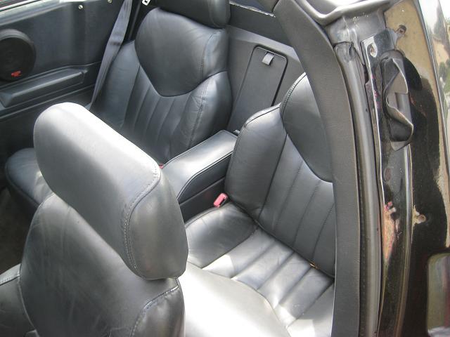

iroc2 Posted April 26, 2012 Report Posted April 26, 2012 (edited) im looking to go from a rear bench to rear buckets. just wondering if theres anything special that i would need to do it. i feel like theres some minor modifications that i would have to do. i guess i really jsut need to track down rear gray/black leather buckts and go from there Edited April 26, 2012 by iroc2 Quote

94 olds vert Posted April 26, 2012 Report Posted April 26, 2012 You will also need the pass through piece that sits behind the buckets. Just make sure you get all of the bolts and other clips you might need to put it on. Those may or may not come in handy. A cutlass supreme convertible with the 3.4l will have rear buckets. 89-93 Grand prix had rear buckets as well. Quote

bg35765 Posted April 26, 2012 Report Posted April 26, 2012 I converted my Cutlass from a 4 seater to a 5 so I could have the whole family in there. So I have nice condition rear buckets and the console in charcoal leather if you want to make me an offer. I also had to buy new seat belt connections that go in the middle so that I would have a lap belt for the person in the middle. In your case I guess you could just cut the lap belt and the latch for the lap belt off. My main concern would be the bolt holes for the center console. IIRC they were in small pieces of metal that were welded onto the floor. I"m not sure if those pieces would have been welded into a car that was going to have a bench seat. Quote

pshojo Posted April 26, 2012 Report Posted April 26, 2012 I pulled my seat out to see if it has the welded tabs, it didn't. So I figured I would end up drilling some screws in to hold the center console. I also swapped out the seat belts, so they would work with buckets. Quote
pshojo Posted April 26, 2012 Report Posted April 26, 2012 Ps, don't forget the metal braket behind the pass through panel. Quote
RobertISaar Posted April 27, 2012 Report Posted April 27, 2012 be VERY damn careful drilling in the area for mounting the rear center console, the fuel tank is right there. i need to do it myself, but i would think if you can get far enough under it and just drill a pair of holes and use some large and short bolts/nuts and probably washers and do it that way. Quote

pshojo Posted April 30, 2012 Report Posted April 30, 2012 I was thinking about doing something similar, but using some type of adhesive on the brackets, and put in place so no drilling necessary. Quote
bg35765 Posted April 30, 2012 Report Posted April 30, 2012 BG35765, What did you do with your storage compartment assembly that was betweeen the rear buckets and led into the trunk? I've been trying to find one, ours is missing some stuff that keeps it all together. If you still have it, would you e willing to seperate it from the rest of the package? You might want to keep it all together and I would completely understand that. I just left it behind the seat. I think I'm going to keep it though as I might convert it back to a 4 seater when I sell it. Quote
