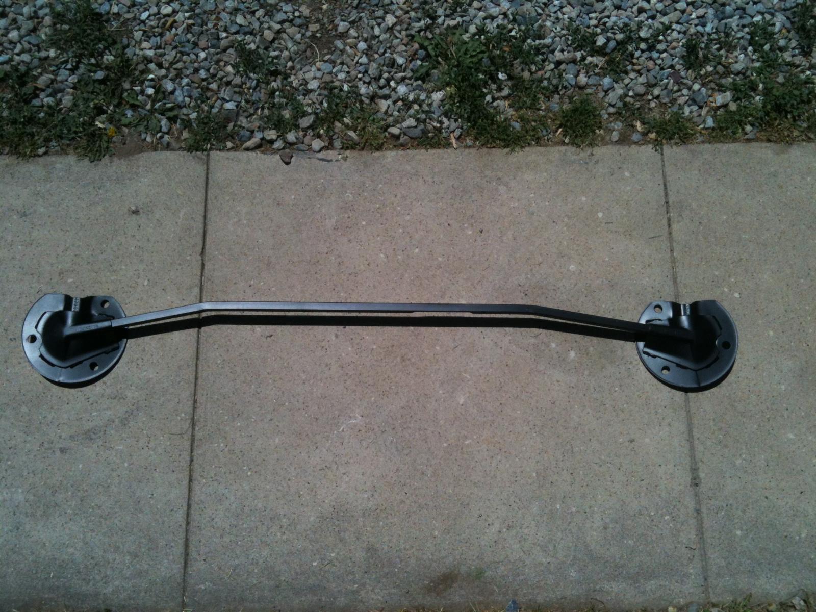

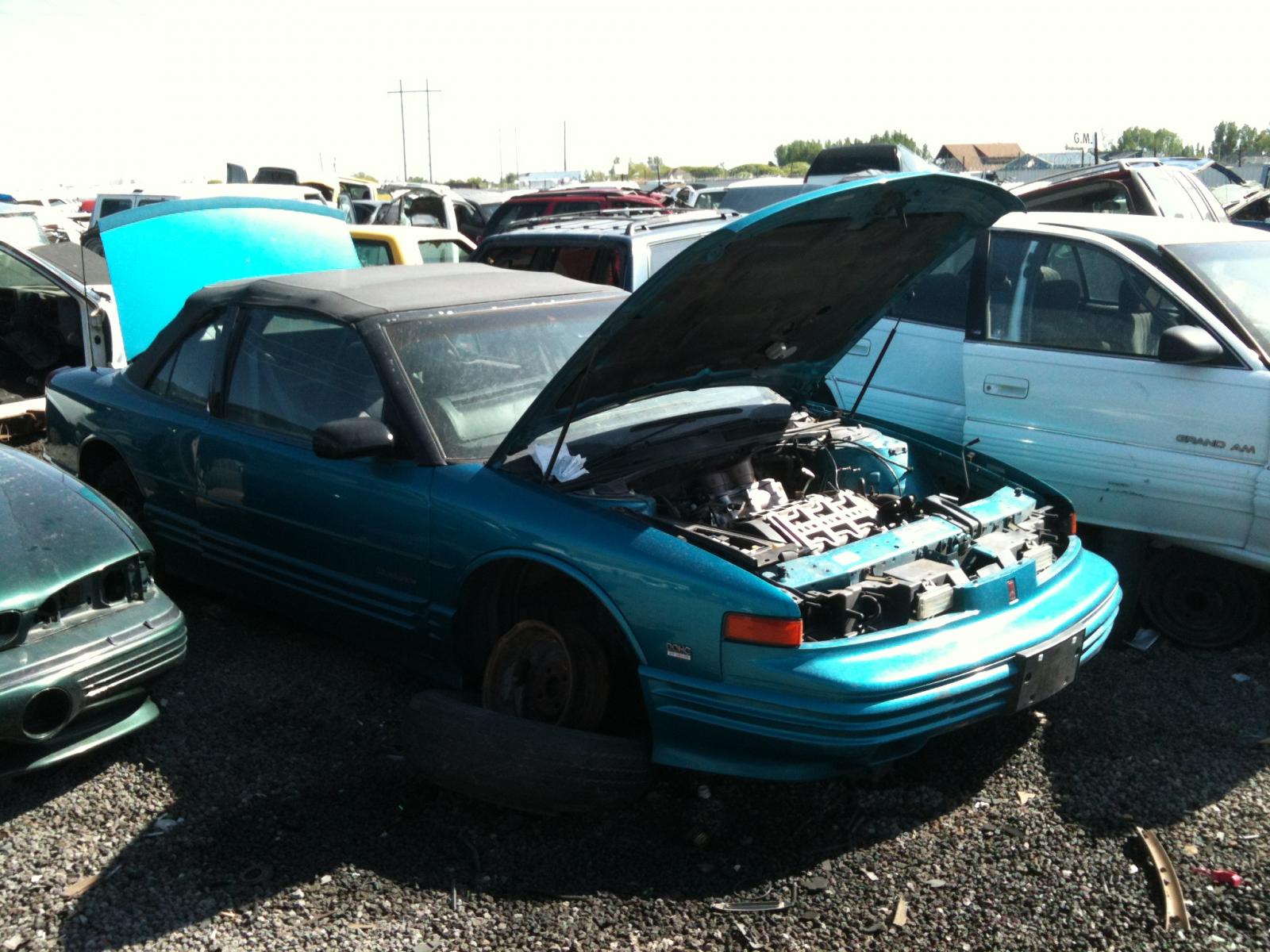

EGTGP Posted June 8, 2012 Author Report Posted June 8, 2012 Son of a bitch.. noticed bubbling in the coolant overflow res when i got home today.. guess its time to price out a gasket set... well turns out my air bubbles were coming from a small crack in the rad where the overflow tube connects right below the rad cap. had the crack fixxed and had a oil analysis done and i did a compression test. all is well!! did pick up a front strut tower brace!! to bad it was from a cutty vert Quote

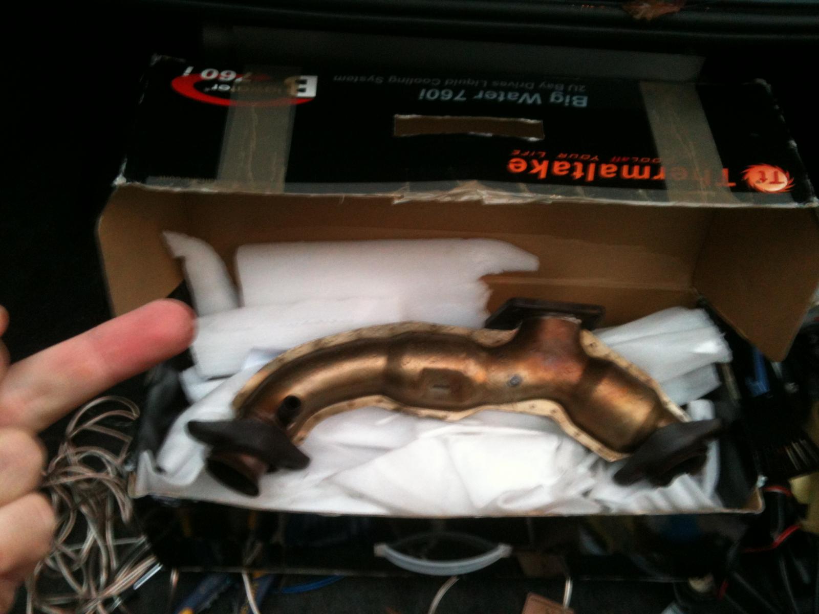

EGTGP Posted October 23, 2012 Author Report Posted October 23, 2012 Matt Inc* repaired crossover ready to be installed.. New intake gaskets injector o-rings and o-2 sensor.. and Its piss pouring rain.. on my only day off for the next week and a half.. and no garage.. I'd just brave the wet If It wasn't 50 degrees out... Guess Ill put It all next to the box of STE parts Ive been neglecting.. Quote
EGTGP Posted October 24, 2012 Author Report Posted October 24, 2012 F--K the rain... Thank god for the 282.. made the job easy. took less then 2 hours.. My god how I have missed the surge or torque.. Quote
