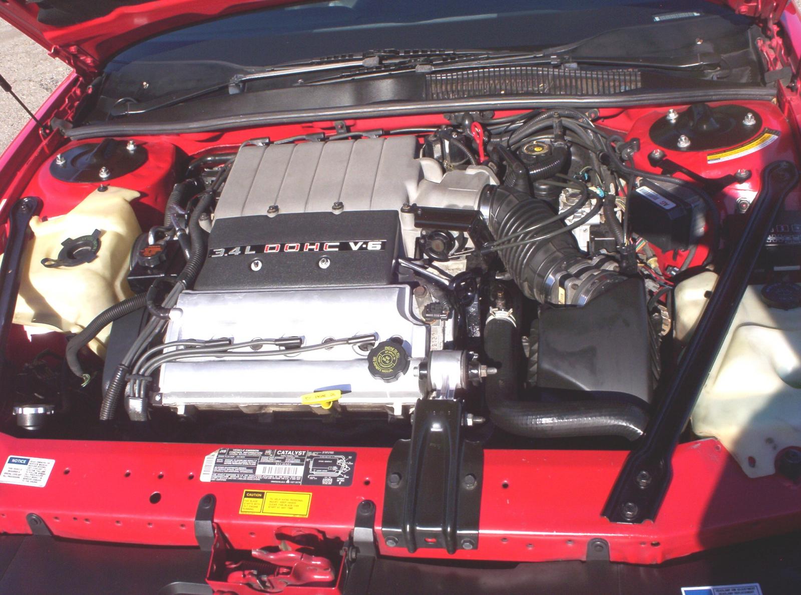

3pt1lumina Posted April 16, 2012 Report Posted April 16, 2012 I usually spray the surrounding area with Simple Green and some type of engine cleaner and let the car run while you hit it with the hose. I usually do not spray the engine directly. Then I use compressed air and blow the big water off of everything, then dry it with a cloth. I usually use the damp cloth and wipe the engine down itself at this point. Then I use a non silicone based tire dressing and spray the area. This is what I've been able to do below: Before After Quote

Addicted To Boost Posted April 19, 2012 Report Posted April 19, 2012 I just use a garden hose with a sprayer, a bottle of Simple Green (or I've been using Shout! on my motorcycles as well) and a toothbrush. Take your time. These are my results of the simple green and a toothbrush method: Before: After: Quote
