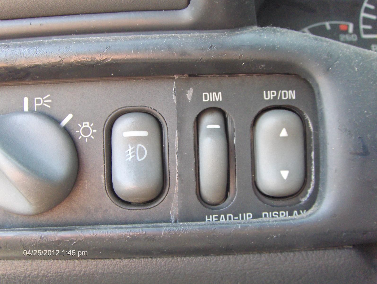

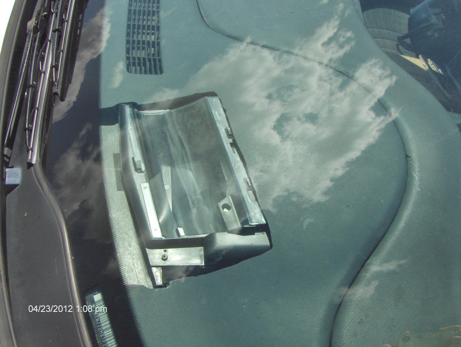

96grandprix Posted April 30, 2012 Author Report Posted April 30, 2012 The defrost cover was prolly the hardest mod. The hud specific cover rises up over the hud unit, and only has a small oval opening for the image. It looks butchered right now, but works. The hud unit i bought is from a 97 and up, so i had to repin about 10 wires in the hud connector. The 97 and up display radio info if you have the correct stereo, which is really nice. The switchs are all the same up to i think 2003. I bought one from a 98 on ebay. With a little bit of work with my mototool i carved out the stock headlight switch assy to accept the hud switch. Had to run a wire from the stereo to the hud for radio info. I dont have any ghost imaging or anything with the image on the windshield. This was a great little mod and I spent about 50$ for the switch and hud unit on ebay, plus 20 at the junkyard for a defrost cover(i wanna keep my original) and some wiring pigtails- i needed 2 or 3 gm wire terminals to add the radio wire. Quote
Addicted to eaton Posted April 30, 2012 Report Posted April 30, 2012 IF I was gonna use the HUD switch from a 97-03 I would have mounted it some where else. But maybe some dime Down the road you can find one. Going to put a six in it? Quote
