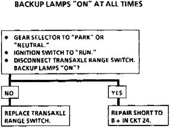

RobertISaar Posted April 10, 2012 Report Posted April 10, 2012 the +12V switched feed for the reverse lamp circuit is a constant hot +12V, so the internals of the switch itself may be going bad and causing the circuit to constantly be closed. Quote

RobertISaar Posted April 10, 2012 Report Posted April 10, 2012 neither does the 95MC, but the fuse and it's wiring is still there. it would more accurately be called the "transaxale position switch" fuse, but GM chose remote compartment release for some reason. EDIT: just to be sure, i checked and there is another +12V circuit used for the shifter position switches for the ECM so it won't effect that. that's run by the TCC fuse. Quote
GP1138 Posted April 10, 2012 Author Report Posted April 10, 2012 Thanks a lot! I just pulled that fuse and I'll have to get that switch troubleshot at some point here. The car only gets driven twice a week as it is but I'd like it to work properly. Quote
