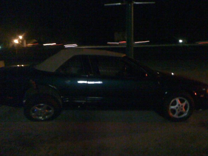

Rick Posted April 9, 2012 Report Posted April 9, 2012 I lost control the other day and ended up spinning out and doing a 360. Strut was torn from its mount and the trailing arm was twisted. Looking at roughly $750 in repairs through a local shop. Me and my dad did the front struts, cv axles but is the trailing arm something we could manage? Looks like my car is bound to have a whole new suspension system virtually..has new front bushings, struts, axles, soon to be rear struts and trailing arms.. Quote

Rick Posted April 11, 2012 Author Report Posted April 11, 2012 do the trailing arms hajust have to be replaced or are the mounts f'ed up They are warped heavily, looks as if it were aluminum foil and someone went at it. Well, one* is warped bad. The driver side is fine. I assume the mounts are okay, the shop didnt say anything of the mounts being destroyed. I will ask them to make sure the lateral links arent messed up when I go to drop off a spare rim and tire to put on the car. Looks like I am getting the two rear struts and mounts replaced, a new right trailing arm, and new parking cable since it either snapped, or is messed up. Then after this week me and my dad are replacing both front axles, *typoed in first post, havent done them yet, new wheel hub, new bushings and something else on the front end. Looks like my suspension is basically going to be revamped lol. Total cost..$700 with about half of the cost being labor. Then I owe another $300 in parts for the front end, so looks like im a grand in the hole for now haha. Quote
94 olds vert Posted April 11, 2012 Report Posted April 11, 2012 Any damage to the body of the car or all suspension related damage? Quote
Rick Posted April 11, 2012 Author Report Posted April 11, 2012 Any damage to the body of the car or all suspension related damage? Thankfully there shouldn't be any damage to the body, the worst body damage may be I need a new plastic piece that punches in on the outside of the wheel well, the molding piece got pushed off, don't know if its salvageable, but thankfully the strut plowed the plastic piece off and not the quarter panel. Car is planned to be fixed by tomorrow, and yeah it should be all suspension related damage. I would post a few pics I took with my dads t2i, but for some reason only one of them saved. The trailing arm literally was warped 90 degrees as if someone held one end and twisted the other side 90 degrees, it was crazy to see. The mechanic said its far from uncommon, or at least for the cars he works on. Quote
