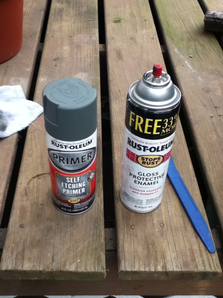

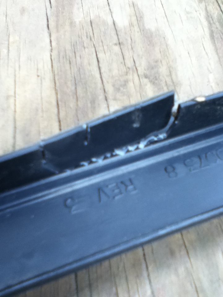

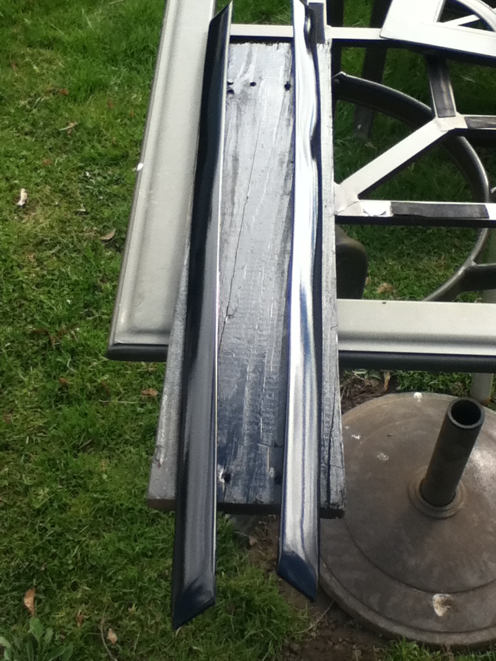

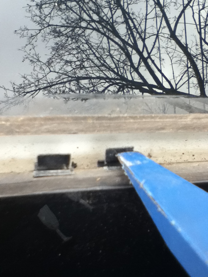

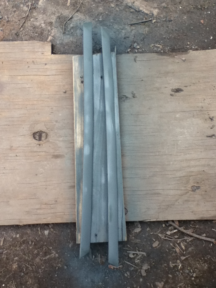

ricklovin93 Posted April 6, 2012 Report Posted April 6, 2012 So i got sick of the faded colors so i decided to freshen up some of the trim pieces Before: Tools: self etching primer, gloss black paint, and plastic prytool (for removal), also used 400 grit sand paper and paint thinner to clean painting surface off (not shown) Removal: Just push the little tabs open to remove the trim pieces, BE careful during removal or you might end up doing this: After primer: after painting: will upload pictures of them installed and with clear coat on them in the morning Quote
94 olds vert Posted April 6, 2012 Report Posted April 6, 2012 Nice! After you put the clear on it will look dull. I'd wet sand it with 1500, or even 2000 grit then put rubbing compound on it. Trust me that will make it look really nice. After that you might be tempted to put wax on it, but I'd wait a while before you do that. Quote
ricklovin93 Posted April 6, 2012 Author Report Posted April 6, 2012 wet sand it after the clear coat is on? Quote
94 olds vert Posted April 6, 2012 Report Posted April 6, 2012 wet sand it after the clear coat is on? Yeah, if you wet sand the color coat you will have small little scratches in the paint. Then when you put the clear on you will be able to see them. When the clear is on you can blend it. Making it nice and smooth. That will remove any orange peel you have. When you wet sand put dishsoap in your water. Will help the wet sanding be less abrasive. Then use a good rubbing compound. I use Meguiars ultimate rubbing compound. I love that stuff removes very small scratches. I cleaned this up washed with dish soap to remove and wax. Gave it a light wet sand (2500) to help the clear to adhere better. After it dried I wet sanded again and then rubbing compound and then a good wax. Looks like new. Quote

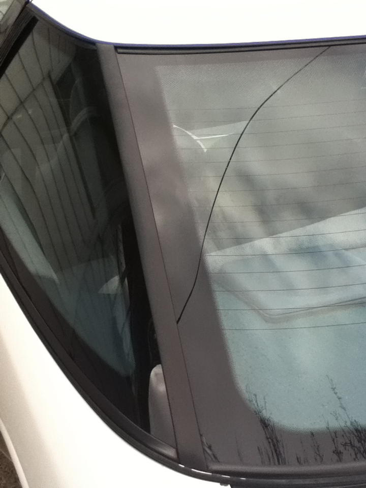

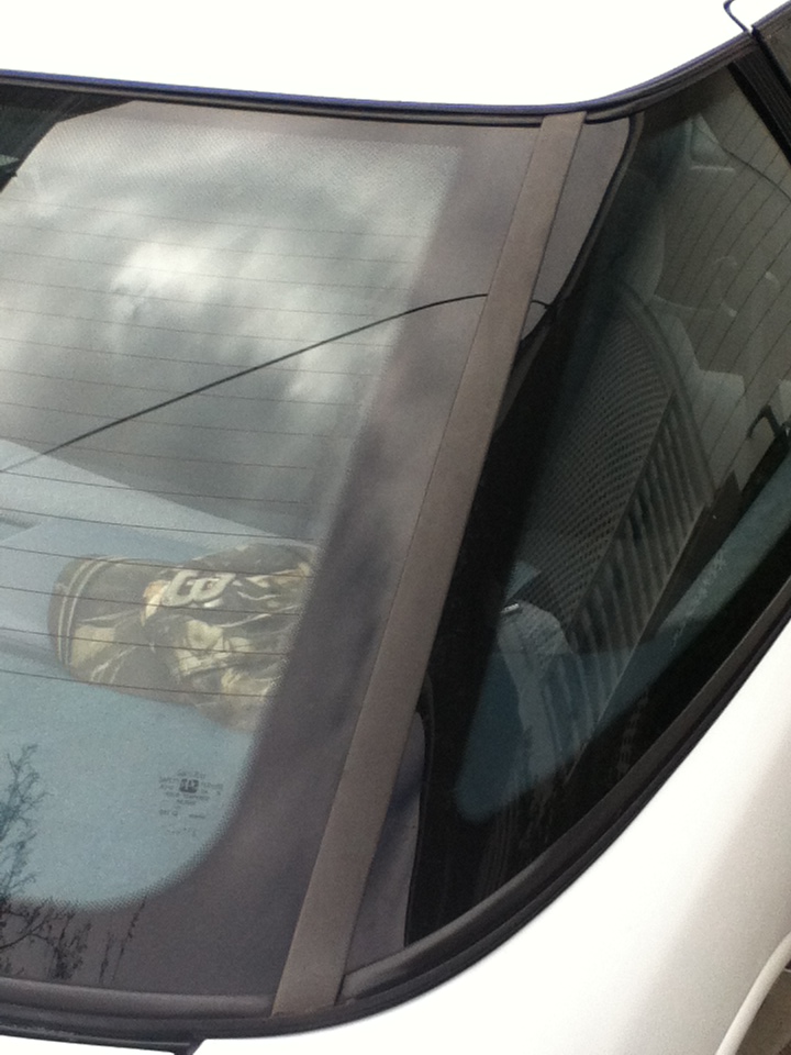

ricklovin93 Posted April 8, 2012 Author Report Posted April 8, 2012 this project has turned into a epic fail........ unfortunately the clear coat did not spray on right, for anyone that does this job skip the clear coat, just do a few layers of gloss black, ill have to swarm the junkyard and find new pieces because mine are trashed oh well Quote

ricklovin93 Posted April 8, 2012 Author Report Posted April 8, 2012 well i used the clear out of a can, and i dont know what happened but it started peeling off and cracking and now they look like shit haha Quote

94 olds vert Posted April 8, 2012 Report Posted April 8, 2012 well i used the clear out of a can, and i dont know what happened but it started peeling off and cracking and now they look like shit haha Did you clean the surface before you put the clear on? Like with mineral spirits? Quote
ricklovin93 Posted April 8, 2012 Author Report Posted April 8, 2012 yea i think i the coats i ut on where way too heavy though because you can see where it was running, what can i use to fill chips in the plastic with will fiberglass bondo work? Quote
94 olds vert Posted April 8, 2012 Report Posted April 8, 2012 When doing the clear. Do a light coat, don't cover the whole thing, second coat cover a little more, but got a little heavier than the first. Third coat put it on so it's the heaviest coat. Make sure you let it dry in between. To fill in plastic if it's in a small area I would not use fiber glass. The fibers in there are hard to work down in a small area. You'd be better off using like a finishing glaze if it's just a small chip. Quote

rich_e777 Posted April 9, 2012 Report Posted April 9, 2012 (edited) Looks good, i just did the same thing with the color of my CS to the same parts. I`ve got about 6 or 7 coats of clear on mine and its been out in direct sunlight, a few t-storms and one flew of going down the interstate and they still look good. Those clips are about impossible to reuse so i took all mine of and used the same caulk you would put around home windows. Cheap and it works beautifullly and you can still cut thru it to remove the trim if you had to repaint it. I let my paint set up a full night and then scuffed it up a little with some 1000 grit, not much but enough to give the clear something to bite on, your first two coats should be light enough they should flash dry but the thried is going to take longer. I wouldnt try to put lighter and heavier coats on just use the same amount each time but keep in mind that after the 2nd or 3rd its going to take longer to dry. P.S. i am a complete amatuer at this and have figured out how to screw it up pretty good but one thing about it is as longer as you havent broken the trim you can always take 600 grit and start fresh. Ive done those window trims, my spoiler/wing, some inside trim and i thought about doing my bumpers next, then on to metal.(insert awkward evil scientist laugh) Ill take some pics tomorrow. Edited April 9, 2012 by rich_e777 got to learn how to spell it the first freakin time. Quote
