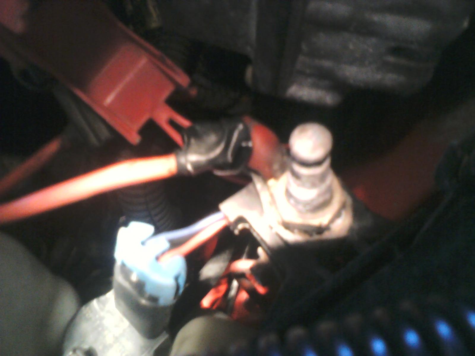

dkas Posted April 2, 2012 Author Report Posted April 2, 2012 Anyone see a problem here? I removed the red cap and looky, looky, I have a wire with electricial tape around it and it appears to have burn marks on it. Do you think this might be my problem? I think this wire needs to be replaced. Thanks Quote
Penglii Posted April 2, 2012 Report Posted April 2, 2012 The pic is kindof blurry, but electrical tape + burn marks is always a good clue. It cannot hurt to replace that wire and see if it helps. Quote
rich_e777 Posted April 2, 2012 Report Posted April 2, 2012 You need a new wire unless you want to fix it yourself, if that you`ll need to cut the wire and redo the connection which is probably going to be a nice litte challenge. I`d just get a new one at a parts store, shouldnt be alot. Quote
AL Posted April 3, 2012 Report Posted April 3, 2012 Also make sure that nut is tight on there... They are known for coming loose Quote
dkas Posted April 10, 2012 Author Report Posted April 10, 2012 Fixed. In addition to the bolts being a problem, there was a bit of extra rubber on the cables that may have been not allowing things to connect properly. The car starts again and stays running. Now just have to replace the wire with the burn on it. Where does the wire at the bottom of the post go to? This the the wire at the bottom of the positive post by the fuse box. Thanks Donna K Quote
