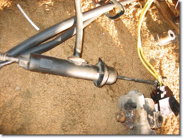

jdcutty1 Posted March 22, 2012 Report Posted March 22, 2012 im in the process of putting my 96 back together and found a leak on the pedal side of the clutch master cylinder. it is the twist-lock style and i have not been able to find one that matches in any part store. mostly because i dont know exactly what car it came out of. if anyone can give me a year/make/model or send me a link to where i can find one, id appreciate it. i stole this pic from another thread, but this is what it looks like. Quote
White93z34 Posted March 22, 2012 Report Posted March 22, 2012 what trans are you using? what does the end of the line look like? Quote
jdcutty1 Posted March 22, 2012 Author Report Posted March 22, 2012 its the 282. and the end of which line? Quote
White93z34 Posted March 22, 2012 Report Posted March 22, 2012 the one from the master. it sounds like you just need one for a 89 2.8/5 speed GP Quote
gtp237 Posted March 22, 2012 Report Posted March 22, 2012 He's right. That is a clutch master cylinder for a 89 grand prix 2.8. I got mine off rockauto.com but I'm sure you could get it at a parts store as well. If you need help bleeding it send me a message Quote
jdcutty1 Posted March 22, 2012 Author Report Posted March 22, 2012 thanks guys, thats the one. Hopefully its the last part that i have to buy. Quote
