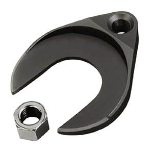

The correct way to remove a half-shaft is with a CV/half-shaft removal claw.
But, hey, ignore what *I* say. Listen to what GM and EVERY manufacture says. :)
To me, it seems foolish to even risk damage because I didn't want to use/buy an ~$45 part. So, I use a half-shaft claw on the end of a puller. Many Autozones have them as free rentals - at least the puller if not also the half-shaft claw.
Just "yanking the ******* out" of the half-shaft to remove it will stress the boot, and may damage the CV joint.
Below is what I use.
NOTE: You may have to grind down one/both sides of the claw/adapter a little depending on the car.
OTC 7507 CV Joint Fork Removing Adapter
Price: $44.60
http://www.amazon.com/OTC-7507-Joint-Removing-Adapter/dp/B0002SRFLC
Good Luck!
