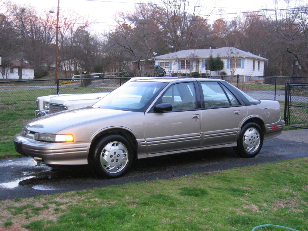

imabadczech Posted February 26, 2012 Report Posted February 26, 2012 OK, so my new old 97 cutlass supreme is one of the nicest cars in my opinion, and I need a little advice. I got my car from my mechanic of 10 years, who got it from a dr who sold it to him due to a bad intake gasket. There was a lot of water in oil but was not run for a long time like that and was towed into the garage. All new intake gaskets and such were done as normal for this 3.1 engine and I have to say, this engine is one of the quietest ever! You can barely hear the car run it is so smooth and quiet. My problem is this. I got her out on the highway for a 25 miles drive yesterday. As I got off the highway, it sounded almost like an exhaust manifold type leak as I could hear the engine more than when it was first started and driven. It isnt a loud banging or anything but you can tell it is a wierd noise. I only hear it when I get on to it like taking off or even reving engine fast a little. Could this noise be the main bearings? It just runs so damn perfect and still idles perfectly with no noise. Would anyone have an idea if I am worrying too much about this or if it is something serious? Thanks y'all for your help Craig in Georgia. Quote

imabadczech Posted February 28, 2012 Author Report Posted February 28, 2012 well, i had a mechanic at a dealership look at my car today. He is a good friend. He said the rod bearings are what is making the noise on the car. Aint that a kick in the balls? I guess when intake was shot, all the water that was in the engine did some damage afterall. I should have known. Glad to find out what it is. My friend said with parts, he would remove engine and replace all bearings that need to be replaced for $1k. I cant go wrong with that as he is a very good mechanic. Quote
