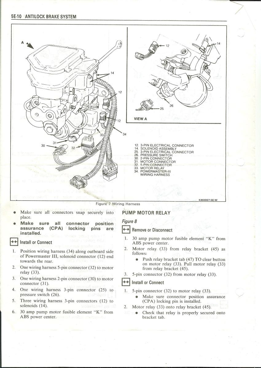

elbago Posted February 17, 2012 Report Posted February 17, 2012 Having problems finding ABS Powermaster parts for my baby. In particular, a relay the Helm Manual calls an ABS Master Relay. Unfortunately no part number is given. The parts books at the local Pontiac dealers in the area do not include the Powermaster braking system. Looking at the switch, it is made by Denso but the part numbers are not legible. I am an office geek type, so if you guys could point me in the right direction, I would appreciate the help. The relay (located below the powermaster unit) had been sticking after the car was turned off. I had to tap on the relay to make it stop clicking. On the way to work this morning, my brakes went out. Plenty of fluid in the resevoir, no leaks. Any ideas? Quote

elbago Posted February 26, 2012 Author Report Posted February 26, 2012 looking for item 33 - motor relay. any ideas where I can find one? Quote
White93z34 Posted February 26, 2012 Report Posted February 26, 2012 Did you try calling SIA electronics? I *may* have a spare one sitting around but I have absolutely no way of guaranteeing if it is any good or not. Quote
elbago Posted February 27, 2012 Author Report Posted February 27, 2012 No, I have not called SIA yet. I do not have a part number for the relay. The exterior of the relay is worn. The relay appears to have been manufactured by Denso and the part number appears to be 055700-8420. I did not want to bother Kevin without a semi-warm and fuzzy that I had a correct part number. Quote
