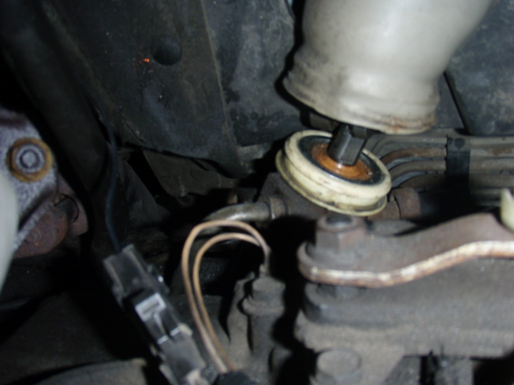

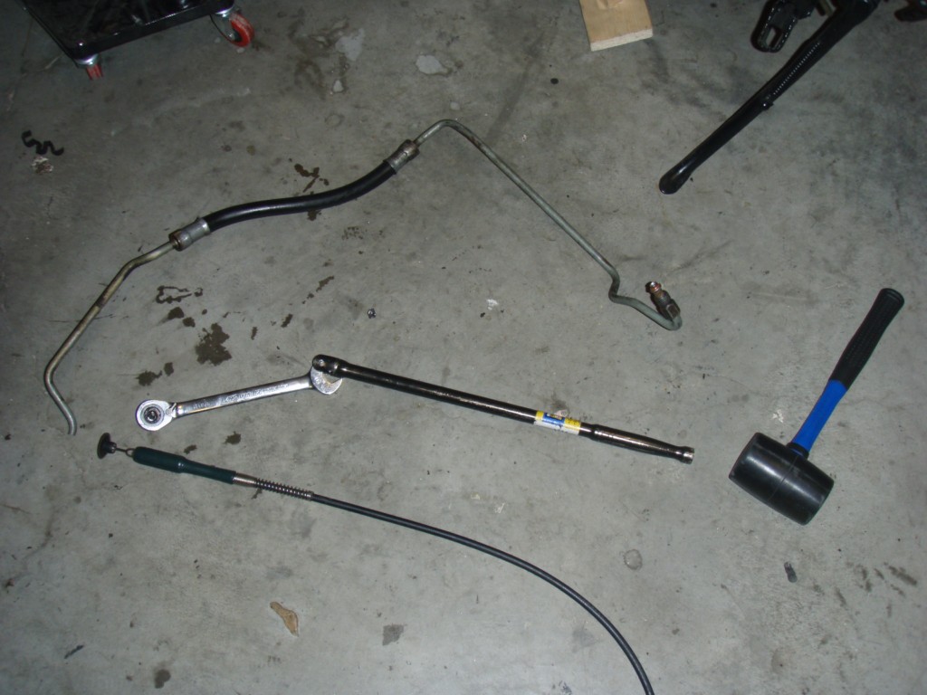

GTP091 Posted February 27, 2012 Report Posted February 27, 2012 (edited) Success! I dremeled the nub off from below to fit the socket I bought over to find there wasn't enough room to ratchet and get good leverage; it wouldn't budge and couldn't get a snipe on either. I put a ratcheting wrench on it hooked the y of a breaker bar on after taking the socket end off and smacked the end of that with a rubber mallet. The last smack I gave it felt like it slipped off and rounded the bolt but it actually broke loose. Long live PB blaster! curse sentence I used when I couldn't get it off with a ratchet 'fuck fuckity fuck fuck' curse sentence I used when I got it off and threw it 'fuck you, you fuckin fuck!' The return line got in the way of getting a good swing with the ratchet I only had about 1.5" swing on the wrench just enough. Not sure yet if I'll change the return yet or not. I probably should but I tried to loosen it and it was just as tight as the high pressure line. Some things should be real tight... others not so much. Edited February 27, 2012 by GTP091 Quote
