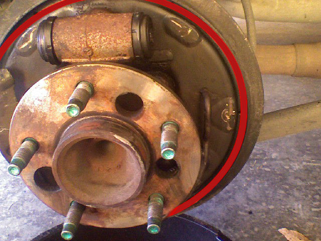

Moldy Posted February 4, 2012 Author Report Posted February 4, 2012 check the hub, the dust shield thing was rubbing onto my hub and making that noise, i thought it was my brakes also..i believe my noise was coming from the same side too Are you talking about this? The backing plate? I put the drums on and checked the clearance but maybe its possible when the wheels are on it rubs? Quote

Moldy Posted February 9, 2012 Author Report Posted February 9, 2012 thanks for the help. If anyone else has the same problem look for wear which will show as shiny marks on the backing plate in the area shown in red. I didn't think this was the problem because I marked the drum where it would be grinding with a marker and mounted the drum turning it by hand and there was no areas removed from the inked parts of drum. For some reason when the wheel is then mounted to drum and car driven then the drum would grind. This was a bit of a trick to diagnose but luckily its fixed and I didn't have to grind much off the drum. Quote
