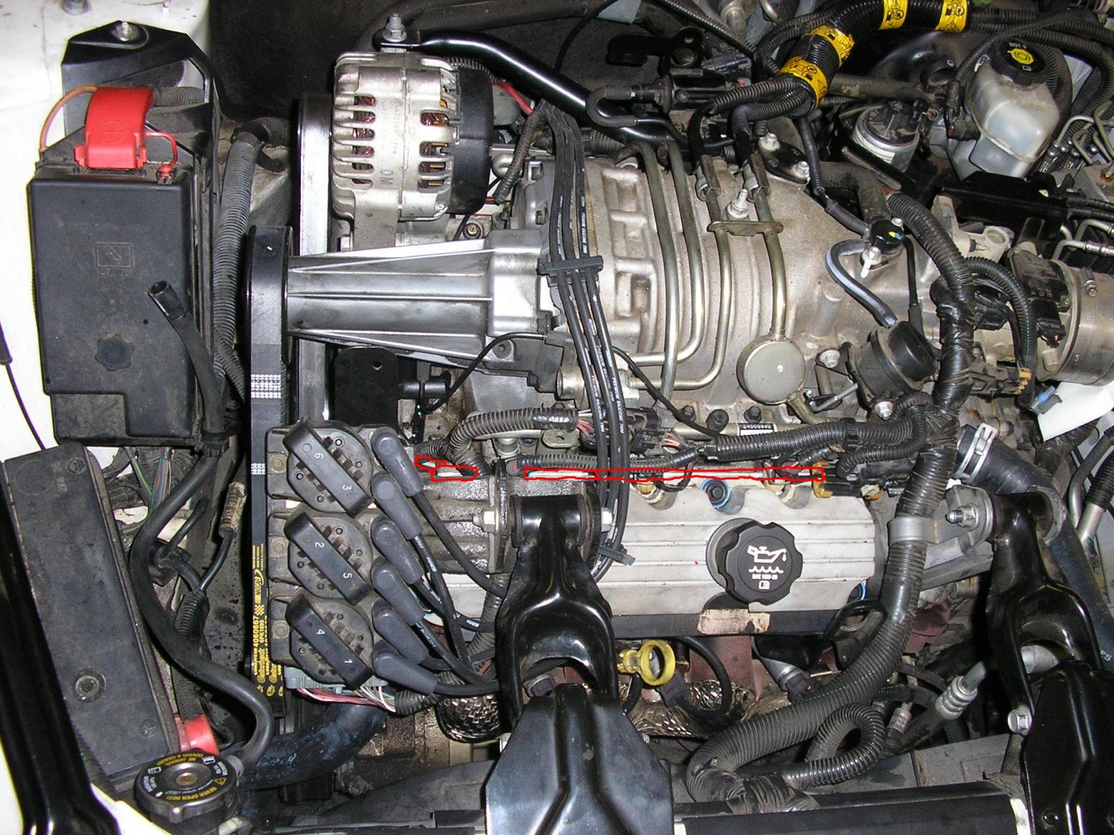

xtremerevolution Posted January 23, 2012 Report Posted January 23, 2012 Before I bought the car, I had my mechanic check it all out and inspect it. He called out the upper gasket and said it needed to be replaced. I brought the car back to the dealer and had them fix it before I paid for the car. My buddy owns a Lumina that he dropped a 3800 into and told me about the gaskets cracking and leaking too. I don't know if they did the lower though. And yeah, if you could, shoot some pictures my way and I'll check it out. Its not a gasket, its the entire plastic intake that cracks near the EGR pipe. That upper intake gasket rarely fails. Its the lower intake manifold gasket and the upper intake plenum that can fail. I'll shoot a picture if I get a chance. Here's a plastic gasket and how it failed: http://i619.photobucket.com/albums/tt273/dahepcat/Bonneville/LIM2.jpg And here's what a metal gasket looks like on a car with the lower intake manifold off http://i675.photobucket.com/albums/vv113/bon2k2k/misc1/IMG_8622.jpg Its sandwiched between the lower intake manifold and the cylinder head. Because its fairly thick (1/4" I believe), you can look at your engine right above your valve cover and right below your fuel injectors (which go into the lower intake manifold), and see which gasket you have, whether its metal or plastic. When you have a metal gasket, it will be very obvious. Here's a picture where you can clearly see the metal gasket on the supercharged version of your motor (which uses the same gasket) http://www.nastyz28.com/~madmike/booh/l67-fixed.jpg I've uploaded another image with the metal gasket outlined in red. Quote
