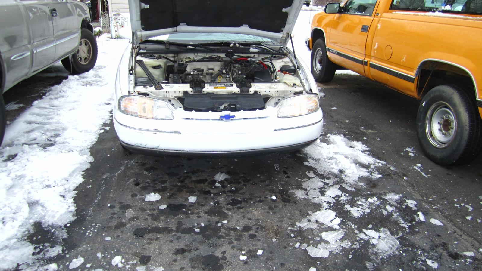

Jprice90 Posted January 22, 2012 Report Posted January 22, 2012 just picked up some Phillip Standard bulbs, man is it a big difference, im glad i did research before i just started buying a set of bulbs, the toenail clippers i had didnt work good at all, so i just used a small set of snips and cut it off no problem, heres a picture, not the best, but you can see a little bit Quote
LuminaPower92 Posted January 22, 2012 Report Posted January 22, 2012 Sorry but............ Maybe try when it gets a bit darker. Quote
xtremerevolution Posted January 22, 2012 Report Posted January 22, 2012 I can tell the difference. The one on the right is vastly brighter and looks much, much better. I'm glad you went with the HIR bulb. You'll love it. Quote
2k2cse Posted January 23, 2012 Report Posted January 23, 2012 I've been thinking about doing this for my high beams for a while. I can't wait to see some night shots of them. So what exactly is the mod? Take a 9012 HIR bulb, which is brighter than most available halogen bulbs, and trim it to fit the 9006 socket. It's essentially the same as getting a 9005 bulb to fit the 9006 socket, but with a much, much better bulb. Quote
Jprice90 Posted January 23, 2012 Author Report Posted January 23, 2012 i agree, the picture isnt the best, my camera was being weird, and i just wanted to get a picture before the battery pack drained but you can tell a difference lol..i was so surprised Quote

Jprice90 Posted January 26, 2012 Author Report Posted January 26, 2012 i got my low beams for like $30? on Amazon, came in a few days Xtreme, do you see the left headlight how in the center of the headlight, theres like a line down the center where the lights not shinning, what is thattt Quote
xtremerevolution Posted March 7, 2012 Report Posted March 7, 2012 anybody know? Looks like it would be part of the glare reducing cap that's inside the housing. Is it visible as part of your light beam pattern at night? Sent from my HTC Awesome using Tapatalk Quote
Jprice90 Posted March 11, 2012 Author Report Posted March 11, 2012 i cant say that it messes with the pattern, my headlight housings are way off but i dont think it affects the pattern if you walk up to it you can see it though Quote
