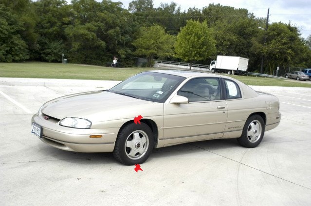

ReBlown47 Posted January 16, 2012 Report Posted January 16, 2012 Just went to the garage to measure each corner where the tires are from the ground to the start of the fender passenger front was 28 inches passenger rear was 28 1/2 inches driver rear was 28 inches driver front was little bit less than 27 and 1/2 inches I wonder if this is causing my constant vibration problem. Quote
55trucker Posted January 16, 2012 Report Posted January 16, 2012 (edited) Proper vehicle ride height is actually measured from the rocker panels to the ground. Measure the front from just behind the front wheels (not via the ground effects kit but the rocker panel itself), and the rear is just in front of the rear wheels. See if those locations give you a slightly different measurement in regards to left vs right. As for the vibration, a difference of 1/2" from one side to another is not a considerably abnormal amount, a vibration while in motion is usually caused by something in one of the rotating masses. Edited January 16, 2012 by 55trucker Quote
ReBlown47 Posted January 17, 2012 Author Report Posted January 17, 2012 What do you mean i measured from where the red x's are on all 4 corners? Quote
Andrew Posted January 17, 2012 Report Posted January 17, 2012 you would only want to compare fronts to fronts, and rear to rear. I doubt many 10+ year old cars are going to be perfectly even. Tire pressure, worn shocks and springs, bad body work etc could all affect this. Also consider that the weight of the car is not perfectly distributed to each wheel. Quote
