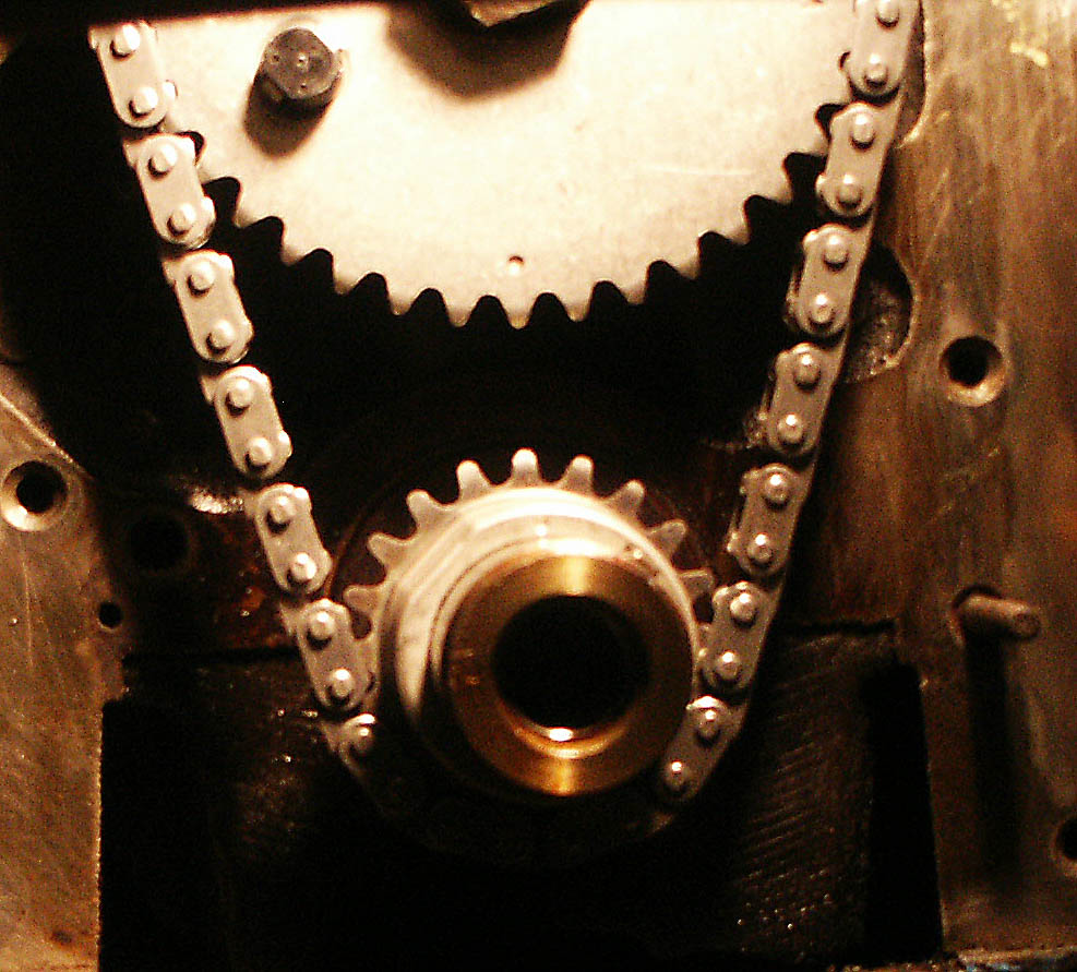

Kimberly Posted January 16, 2012 Report Posted January 16, 2012 I need advice on replacing timing chain in a '93 3800 engine. The cam and crank, as far as I can tell, are aligned. I can not get the cam gear to slide onto the camshaft shaft. It seems very tight to me. How tight are these new chains? Shouldn't I be able to do this by hand and not have to force the cam gear in place? Would the crankshaft gear being off a bit cause problems, do I need to shift the crank back or forth? This is not the first time I have worked on cars. I replaced the cam gear and chain in Mum's 1983 Buick LeSabre without problems. I decided to stick the cam gear bolt in just to hold the gear in place to check alignment. Just need someone that has done this job to let me know if it just slides on by hand, or what. And how much deflection should the new chain have, some, none, what? This is the first time I have gone into a 3800 engine. Quote
19Cutlass94 Posted January 16, 2012 Report Posted January 16, 2012 You should be able to slide it on a little bit by hand, and the rest with the cam bolt. There should be a very small amount of play in the chain, maybe 1/8" or so. But there should also be a dot/marking on the crank gear, which is kinda hard to tell from the picture, a bit fuzzy. Quote
Kimberly Posted January 16, 2012 Author Report Posted January 16, 2012 Yes, my camera is not very good. If you look in the photo you can see a white dot on the crank gear, that is the timing mark. I was told that it would be tight going on but just wanted to make sure so that I did not damage anything. Quote
95 vert Posted January 16, 2012 Report Posted January 16, 2012 I generally have to take a hammer and "tap" on the cam gear to get it to seat. Quote
Kimberly Posted January 16, 2012 Author Report Posted January 16, 2012 The cam gear and chain is in place. Once in place, the chain is not that tight; I guess once it is in proper alignment. There is the proper deflection I would expect to see. The problem was that I was afraid of damaging the chain, or the gear, or shaft or pin and I could not see what was going on since it is just me. What I did was to place a suitable sized mirror resting on the crankshaft and AC bracket that would allow me to see the face of the timing gear. I could see the shaft and pin were in the proper place although I could not push it on by hand. I then put the cam bolt in place and using very light pressure on the socket wrench simply pushed the cam gear in place using the cam bolt. It slid easily into place without any effort. Being able to see the face of the gear and seeing that the alignment was correct did away with my fear of damaging something. Quote
