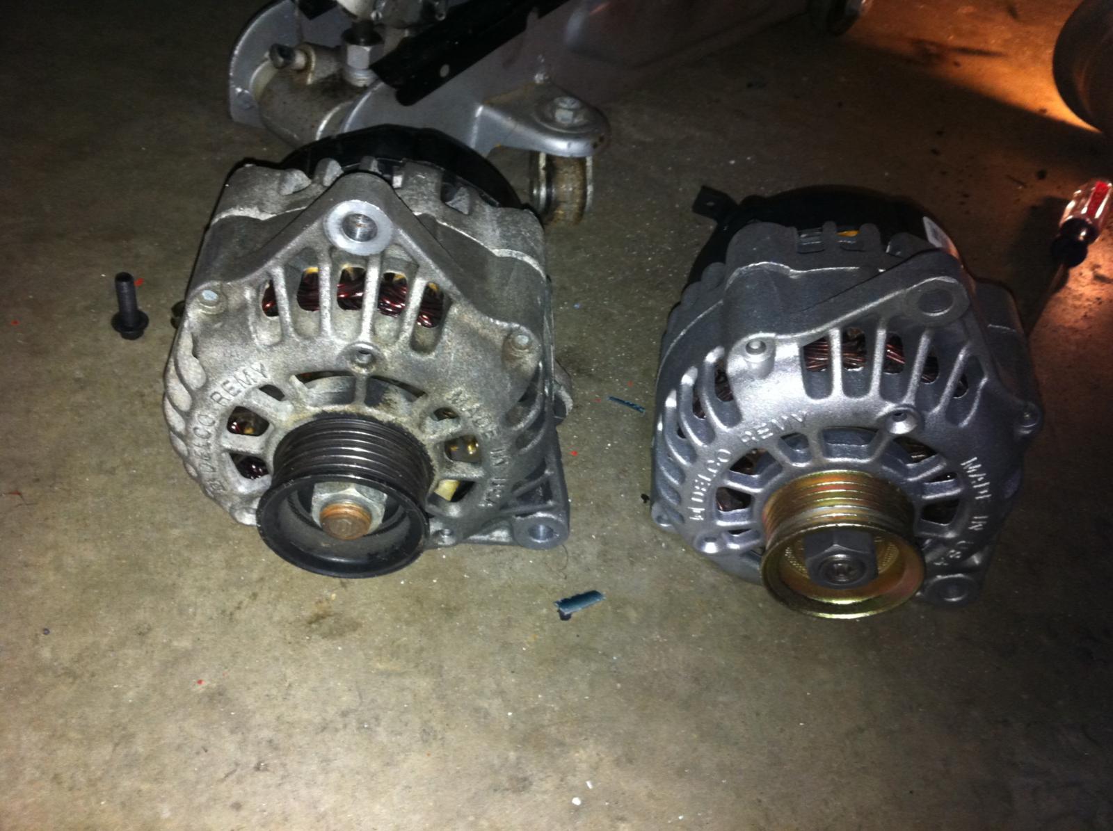

MemphisMan Posted January 3, 2012 Report Posted January 3, 2012 New years day I got the battery idiot light followed shortly by the ABS idiot light. I was on my way to meet Red93Cutlass (Jeff), who was passing through Memphis. We had arranged to meet up so he could check out my Cutty. No such luck. My Cutty died on the side of the highway less than 5 miles from where we were going to meet up. The voltage regulator had failed and the battery had completely drained. I was going 60 miles an hour when I lost all power and my beloved Cutty had to be parked along side of I-40 while I waited for a friend to bring me some tools. He arrived and we pulled the battery, took it to autozone, charged it, and put it back in the Cutty. Ran on battery power back to autozone to have the charging system checked out. Bad voltage regulator inside the alternator. Bought a new alternator and nursed the Cutty home. Started the alternator swap this morning at 10am...finished 12 hours later. 2 trips to autozone, 2 meals, taking down Christmas decorations, and a lot of cussing happened in between. It would've taken less time, but I spent a lot of time trying to get the top alternator bolt back in, which I never did. I did get all of the ducting work put back in place though. My hats off to those who have done an alternator swap on a 3.4 in 45 minutes. I just don't see how thats really possible to be honest, unless the motor is out of the car. I almost feel like this was a right of passage for me because I've read about all of the many things that go wrong with these cars, but I never had an issue. My Cutty is back in business. Jeff, again my appologies for not being able to meet up with you. I was looking forward to it. Maybe next time. Quote

MemphisMan Posted January 5, 2012 Author Report Posted January 5, 2012 Congrats on your first LQ1 alternator replacement. Your first one always takes a while longer. Thanks Matt! Did the internal design of the replacement alternators improve over time or are they the same as stock? Quote
55trucker Posted January 5, 2012 Report Posted January 5, 2012 (edited) Where the Delco CS130 original is concerned.... pretty much the same as the original Delco supplied items, the regulator might be an offshore item, assuming that one purchases a unit from your average over-the-counter mass parts supplier.........unless.....you opt for one of the high output *iceberg* units, such as these builders.... http://www.alternatorparts.com/cs130-cs130d-series-alternators.htm who make use of better quality internals to get that better output/cooling. Don't know on the US side who distributes for this particular builder (or, if one purchases direct from these people), but where I live I make use of an independent builder who will build to suit. Edited January 5, 2012 by 55trucker Quote
