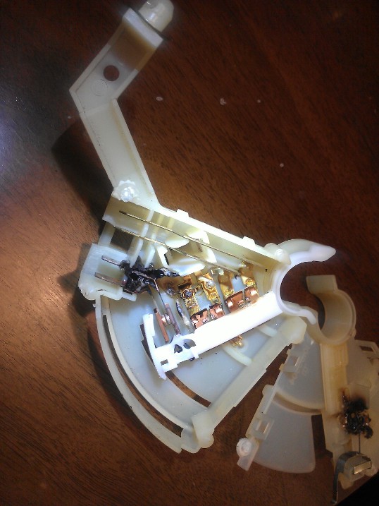

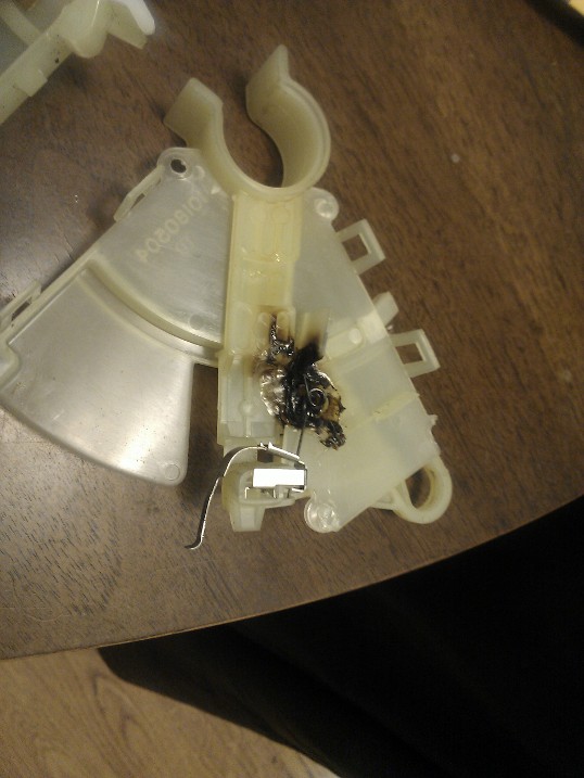

Tabiji Posted January 7, 2012 Author Report Posted January 7, 2012 Thanks, yeah, there is a pinch "bolt" but I cannot get what it is pinching loose to get the column out. I did get the switch out, it is broken. Wonder that I did not blow a fuse. I bought one on e-bay just now and hope it gets here soon. Like a Garth Brooks song, blood and sweat and lots of french words. I can't figure out how it should work. Are there wiring diagrams around for it? Quote
