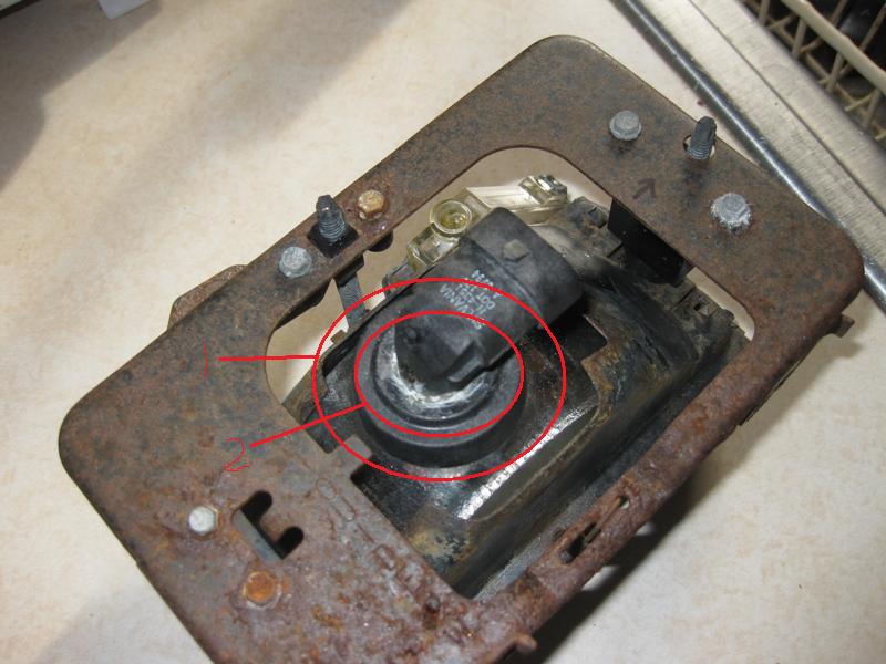

BRZN Posted December 30, 2011 Report Posted December 30, 2011 A bit of help please. What is to come off, the entire plastic piece attached to the rear of the bulb (larger diameter circle #1) or just the center plug part (smaller diameter circle #2)? I chipped three lumps of glue off from around the plug portion, but nothing wants to budge at all. There is a bit of movement from the larger circled piece, but the bulb feels like it's going to break before letting go of the bulb. Quote

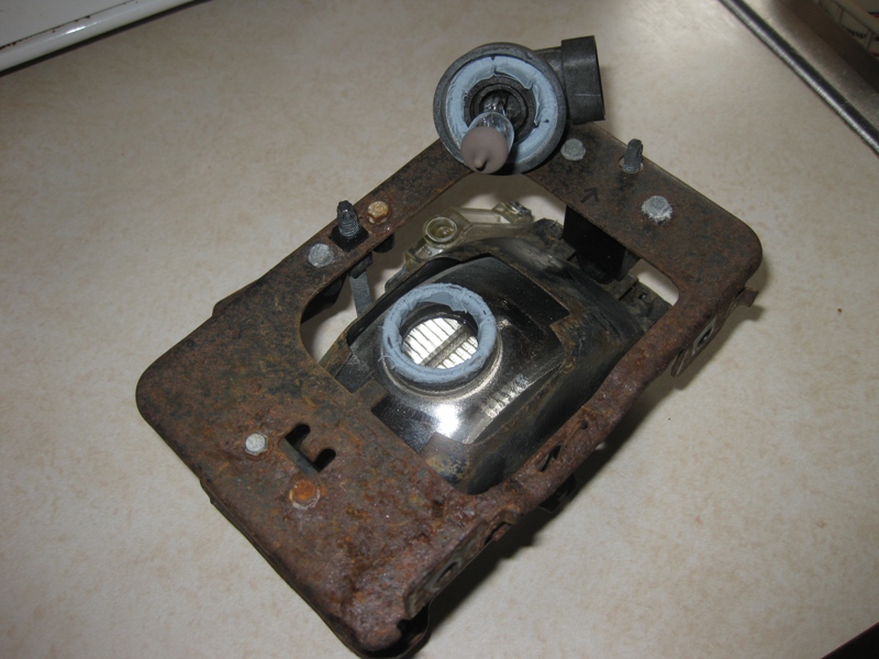

BRZN Posted December 30, 2011 Author Report Posted December 30, 2011 Never mind, I got it: Damn, that thing was tight! Wish me luck with the other three. Quote

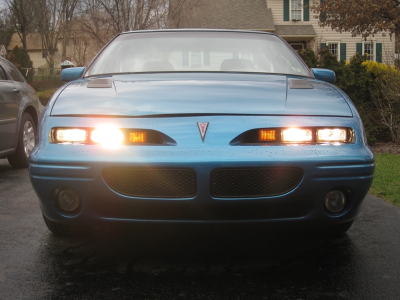

BRZN Posted January 1, 2012 Author Report Posted January 1, 2012 Thanks, no pits on the glass though. If they'd have been bad I'd have probably opted to just replace them. Three of the four bulb capsules fell apart while removing them, one to the point I didn't have much to hold on to to twist and was getting a bit worried. I really believe at least three of the four were still stock headlamps. Finished up yesterday after letting them sit overnight for the RTV high temp silicone that now holds them in place to dry. I had to adjust the passenger side high beam (notice in below pic) but all the others were still good. Now instead of the yellowish light of the OEM's there is a bright, crisp, white light emanating from them. Awesome upgrade! Quote

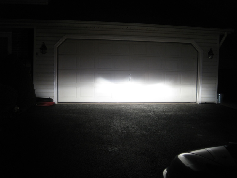

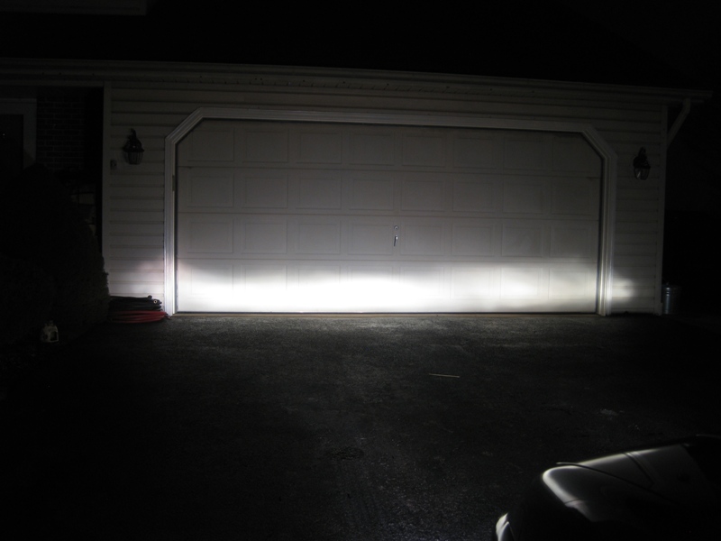

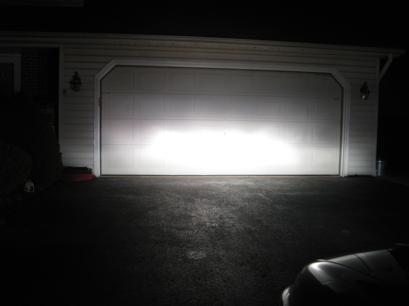

Fraschy Posted January 19, 2012 Report Posted January 19, 2012 Awesome. Would you be able to post a picture of how good the light is now, from the drivers point of view at night? I think I may do this once my car is good to go, since I could hardly see where I was even going, lol. Quote
BRZN Posted January 24, 2012 Author Report Posted January 24, 2012 Woops, I've had the flu since last Thursday an absent from the boards, sorry. Yea, if I get the chance I'll try to snap a pic or two tonight against the garage door. Nothing to compare it against, just how they are now though. Quote

BRZN Posted January 24, 2012 Author Report Posted January 24, 2012 Awesome. Would you be able to post a picture of how good the light is now, from the drivers point of view at night? I think I may do this once my car is good to go, since I could hardly see where I was even going, lol. Here you go Fraschy: Fogs: Right needs aimed better, the adjuster is rusted tight and will deal with it in the spring. Highs: Lows: Looks like I may need to bring the driver's side down a tad. Quote

Fraschy Posted February 7, 2012 Report Posted February 7, 2012 WOW those new headlights look AWESOME! Thanks for posting those pictures! This is a great thread. And I don't see any blue in the light, looks pretty darn white to me. Quote
