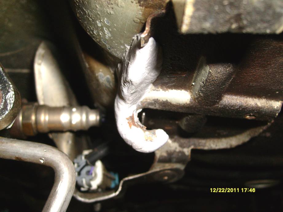

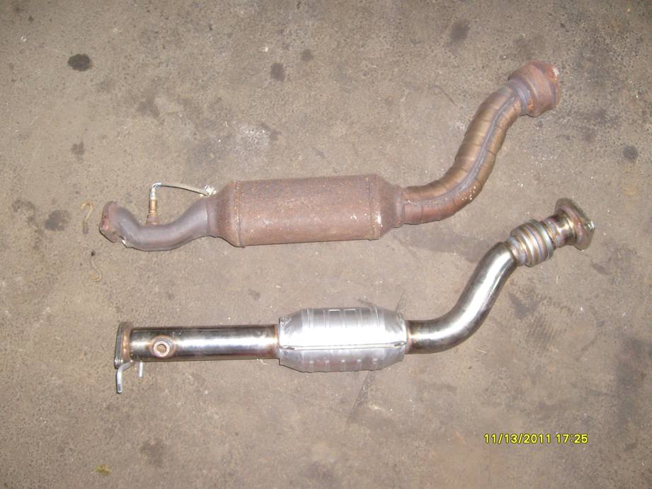

Below are some pictures of the original and replacement cat and downpipe for my 2000 Intrigue with a 3.5L LX5 shortstar engine.
NOTE: The location of the backend O2 on the replacement required me to "relieve" (bang in with a big hammer ::) the underbody (second picture).
