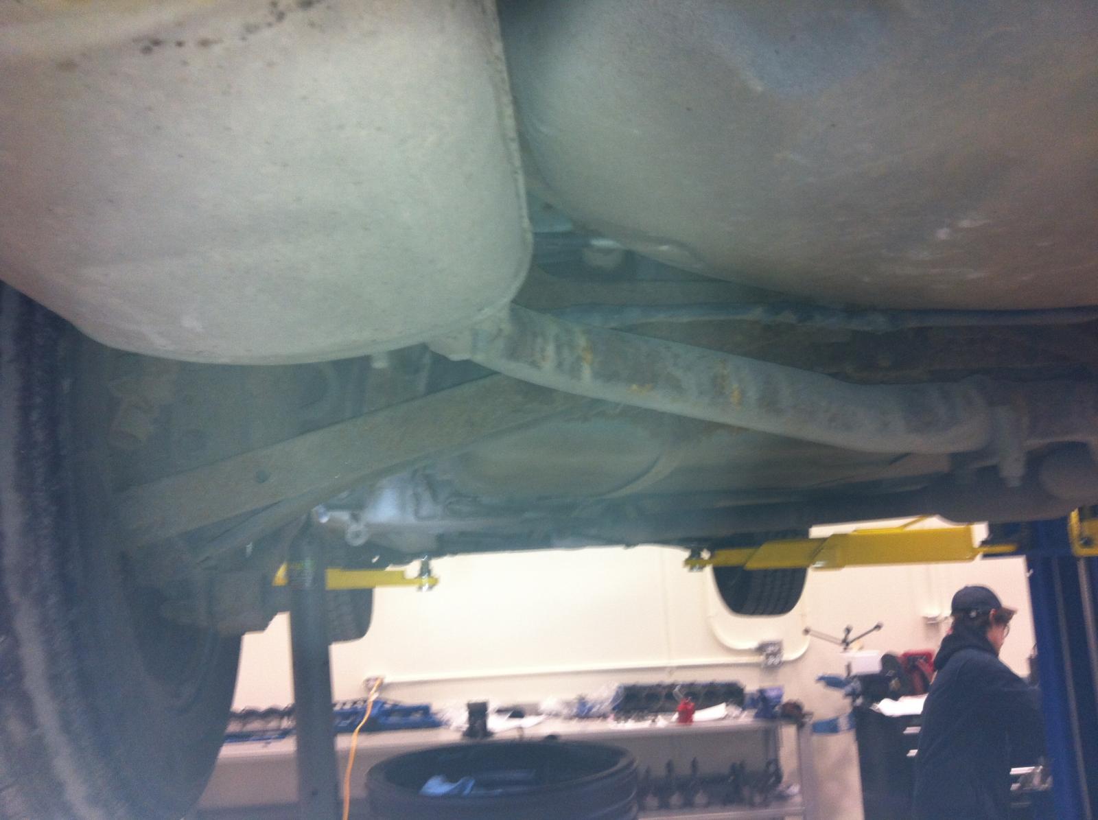

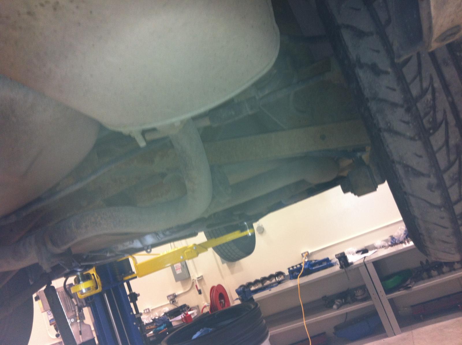

brake Posted December 29, 2011 Author Report Posted December 29, 2011 actually found a couple of pics of my car on the lift. looks like one of the isolators is intact but the other is either missing or fucked. Quote
brake Posted December 29, 2011 Author Report Posted December 29, 2011 (edited) Could the car sagging on one side as a result of the bad/missing spring pad be a potential cause of my uneven tire wear on the rear drivers side tire? Got a wear strip on the inside edge (you can see it actually) Edited December 29, 2011 by brake Quote
xtremerevolution Posted December 29, 2011 Report Posted December 29, 2011 Could the car sagging on one side as a result of the bad/missing spring pad be a potential cause of my uneven tire wear on the rear drivers side tire? Got a wear strip on the inside edge (you can see it actually) I don't think it would cause that big of a tire wear. Have the pressure checked, and have a firestone place do a free alignment check. When was the last time you had them rotated? The pad on the left needs replacing, if there even is one left. Quote
brake Posted December 30, 2011 Author Report Posted December 30, 2011 yeah I'm gonna replace both of 'em. the pads, that is. Haven't had them rotated in forever - I bought the car within the past year and the tires were fairly recent. They've been in the same place ever since. Pressure is fine but it was a touch low in that corner when I last filled them. I just picked up a set of winter tires for the rear - Tires on the front are still good. I'm gonna change 'em as soon as I get the chance (I can mount/balance em myself at school but we don't go back until next week.) Quote
