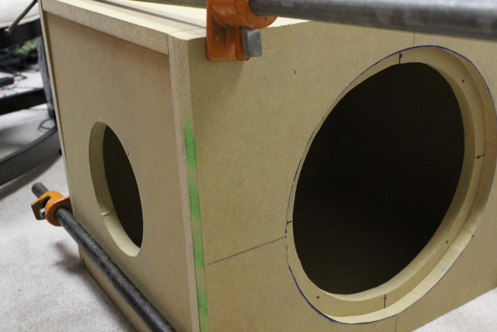

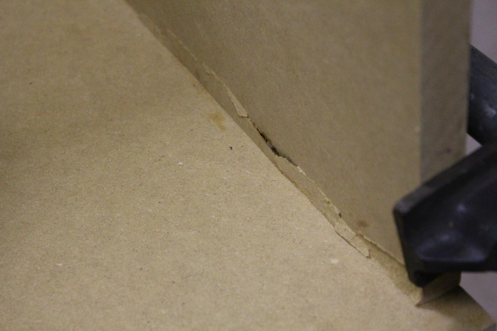

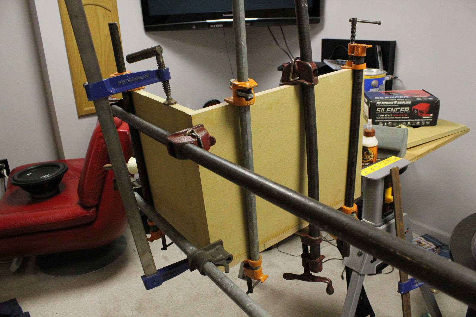

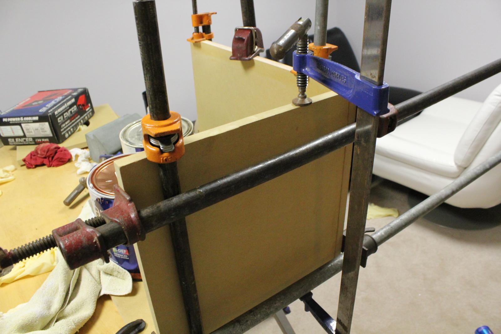

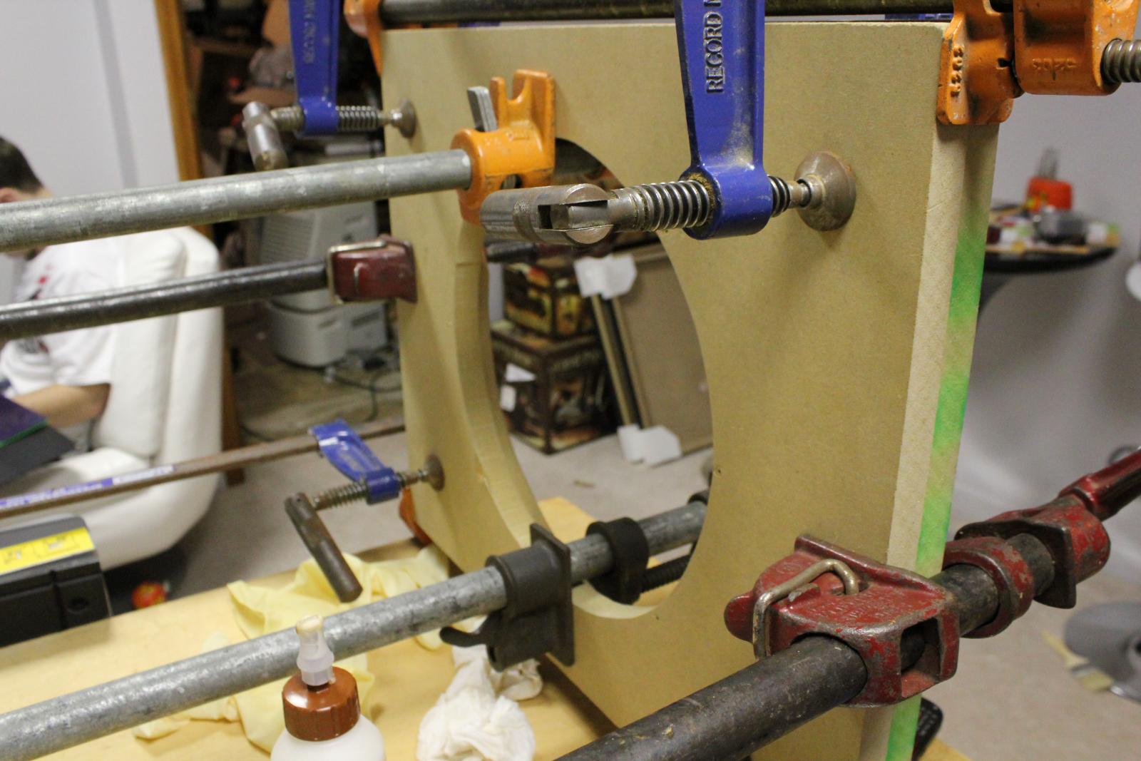

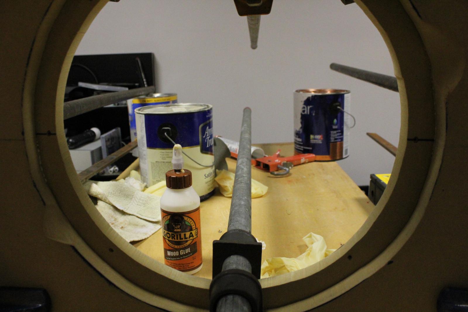

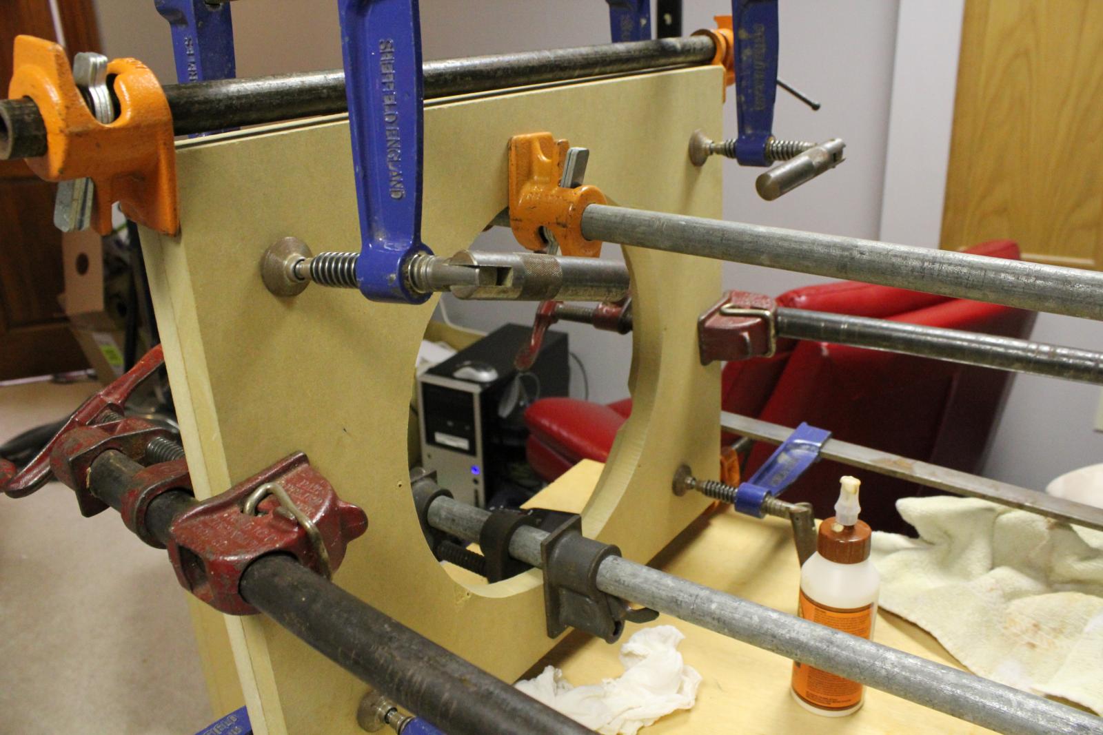

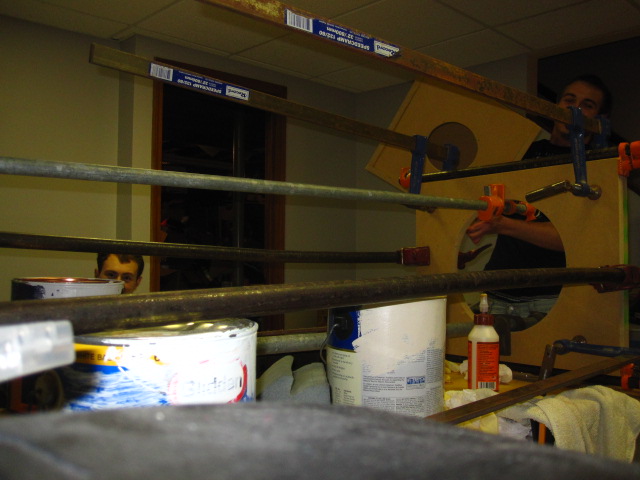

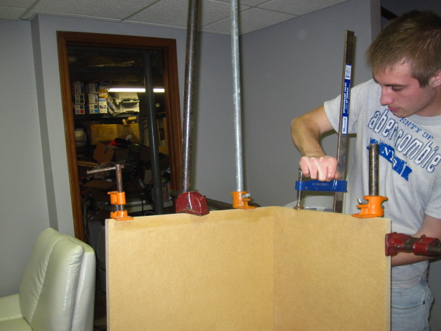

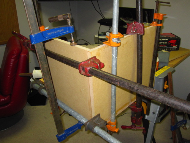

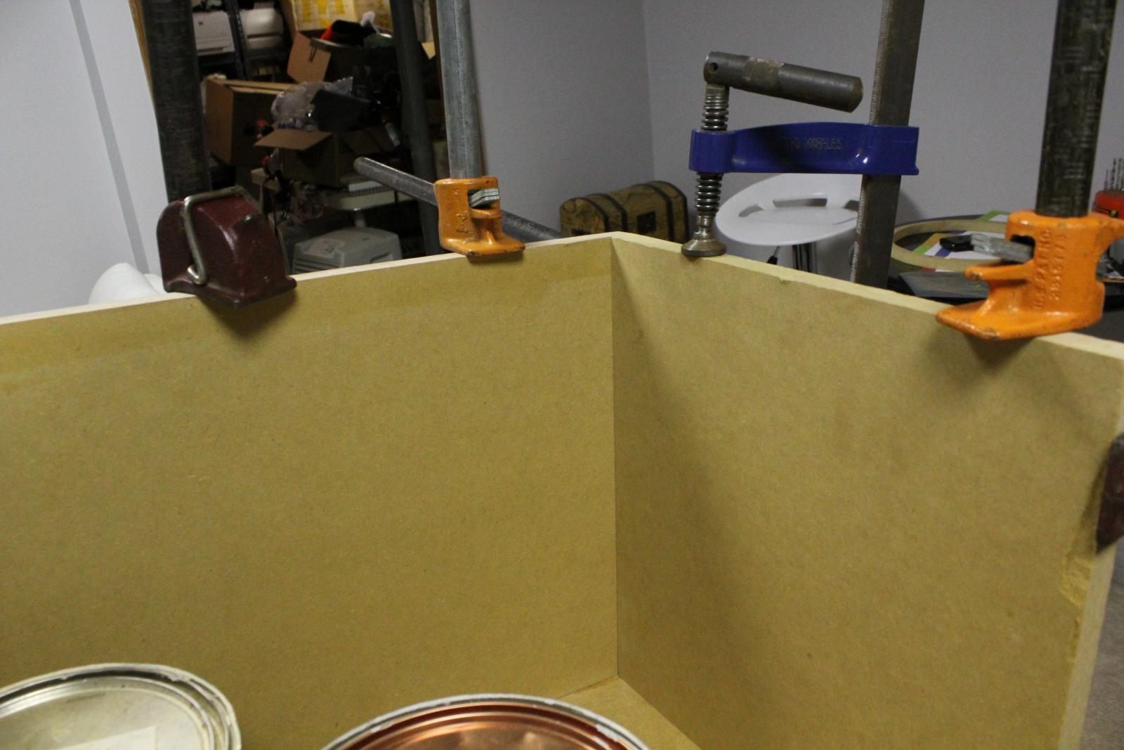

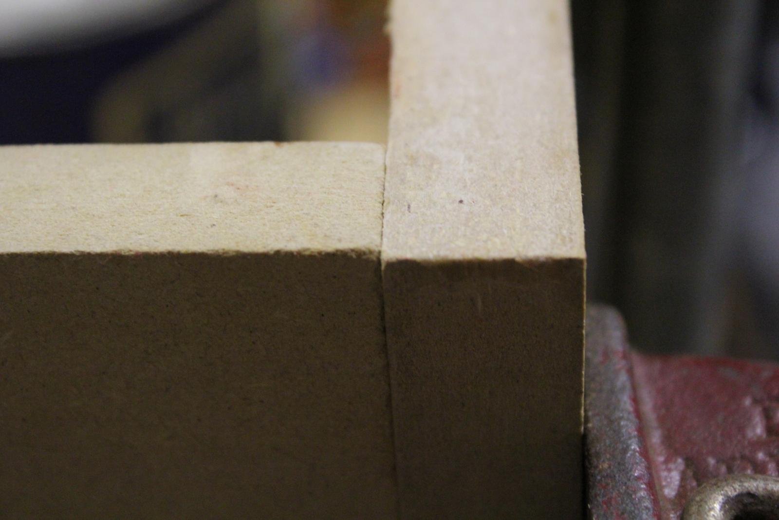

Well having a friend who took wood shop for a few years proved to be great help. Dumbass me ended up gluing the wrong edge to edge after we first test-clamped without glue. How I made such a mistake phases me, apparently I was trying to clean the glue not the best of ways and he showed me a easier way by using a damp/wet cloth instead of a dry one.
Second issue, I am not sure if it was due to being clamped too tightly, but the board ended up angling inwards! We recognized this when fitting the 14.5x14.5 to make sure it fit snugly, when it wouldnt fit we knew we had an issue. Had to clear of glue and re-do. This time it went as a success. One issue however was that im not positive if the MDF splintered a little on the bottom from being tightened too hard. I didnt think this could happen, but thats what im guessing the reason was. Thankfully it wasn't terrible. I will post a few pictures below, im sure you can quickly pick out which photo is of the splintering. Planning on letting it sit overnight and finish it tomorrow after school, this definitely proved to be a 2 man project, maybe 3 especially when using 4ft bar clamps.
Photos:

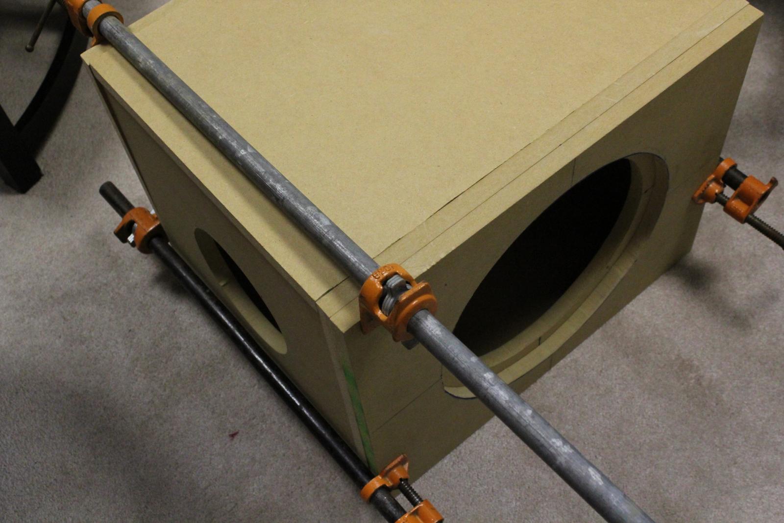

Looks good. 4 foot clamps? Wow, those are long, lol. I don't own clamps longer than 18", lol. They certainly do the trick though.

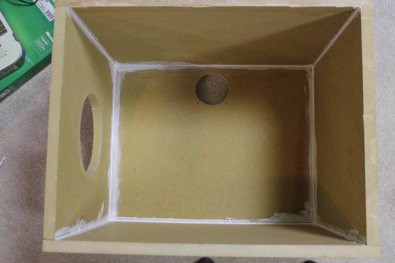

I see what you mean about the MDF splitting where it did. I had that happen to me a few times. Its usually a result of an uneven cut when the MDF is clamped, or if you try to move the MDF after its lightly clamped and it catches on the surface and splits it. It won't be a problem.

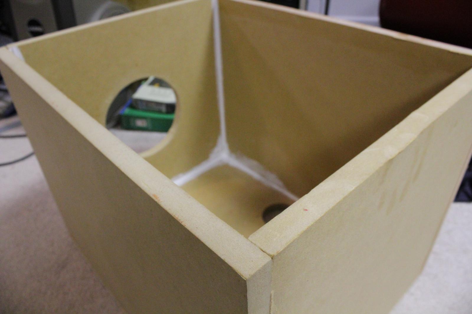

One issue I see that might be a problem is the place where you cut the opening for the port. Have you tried to test fit the sub itself and the port at the same time to see if you have enough clearance? That looks like it might be a bit close.
With regard to the angled panel, I've had that happen too. As you clamp down, you'll see that the panels move. I usually loosen up the clamps a bit and use a rubber mallet to tap the panel back into place. It takes a bit of practice to get it right, and it certainly doesn't help that you're using such large clamps.
That said, it looks like you've got the general idea on how it all needs to be done.
:thumbsup:
Yeah the four foot clamps were used for my neighbor to straighten very long boards for his deck, so a little bit excessive but they get the job done. And yup the port clears a good 1-2", thats why I clamped it together without glue first to make sure it all fitted.
Off to school, should see some more progress when I get home!

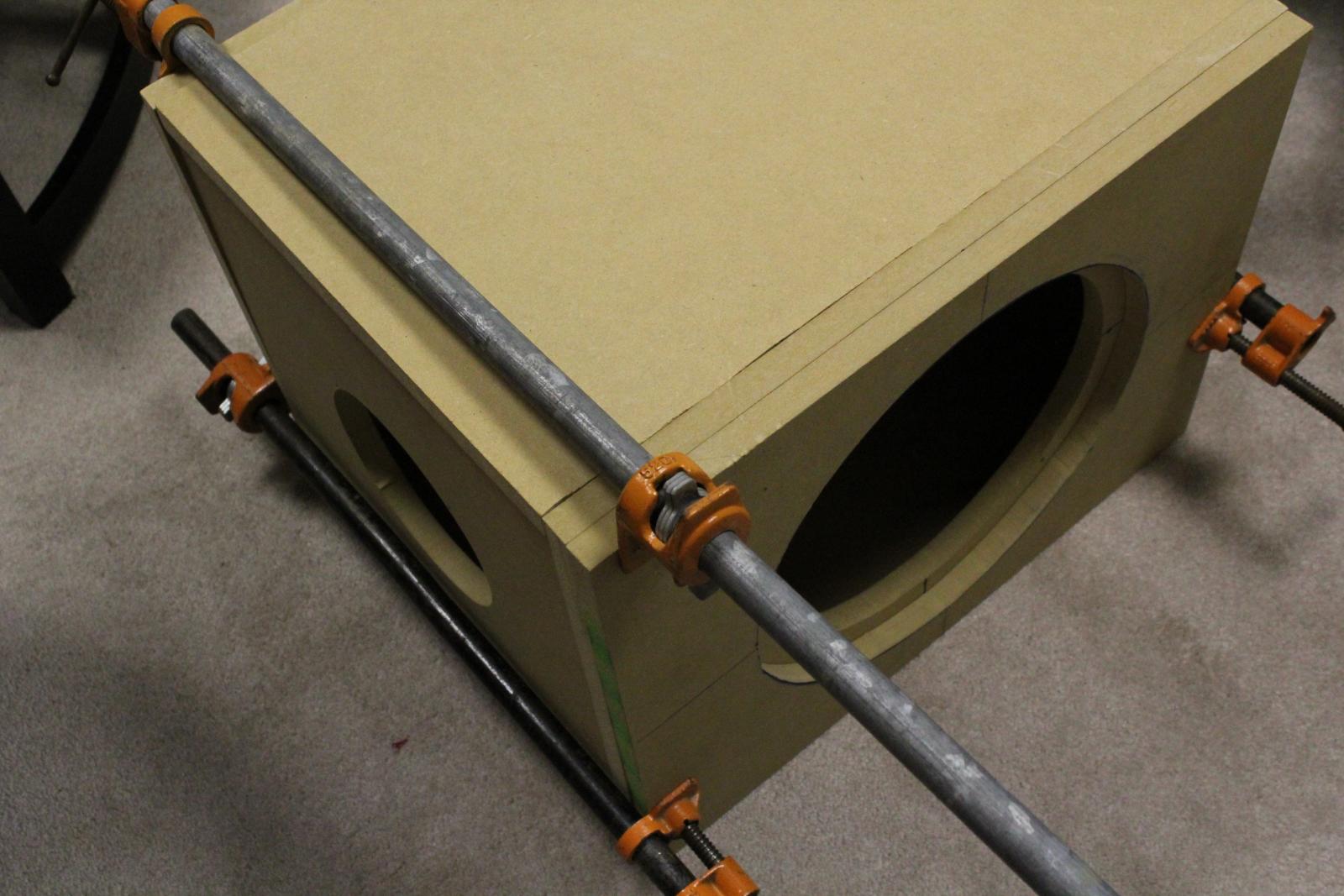

For the next panels is it okay to remove the other clamps and use them to clamp the next pieces?
Yeah, you'll be fine removing the other clamps once the wood glue dries. With titebond, I only wait about 20 minutes before removing the clamps, and by that point, there's no getting the panels apart.

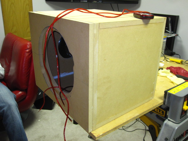

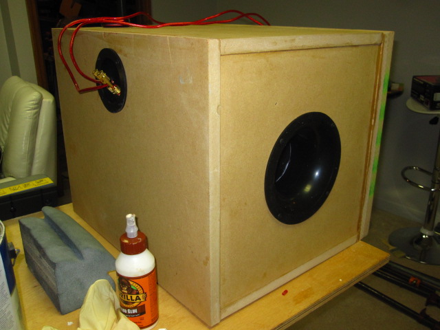

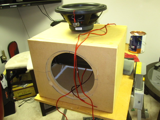

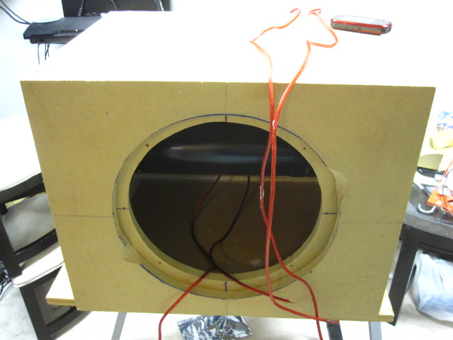

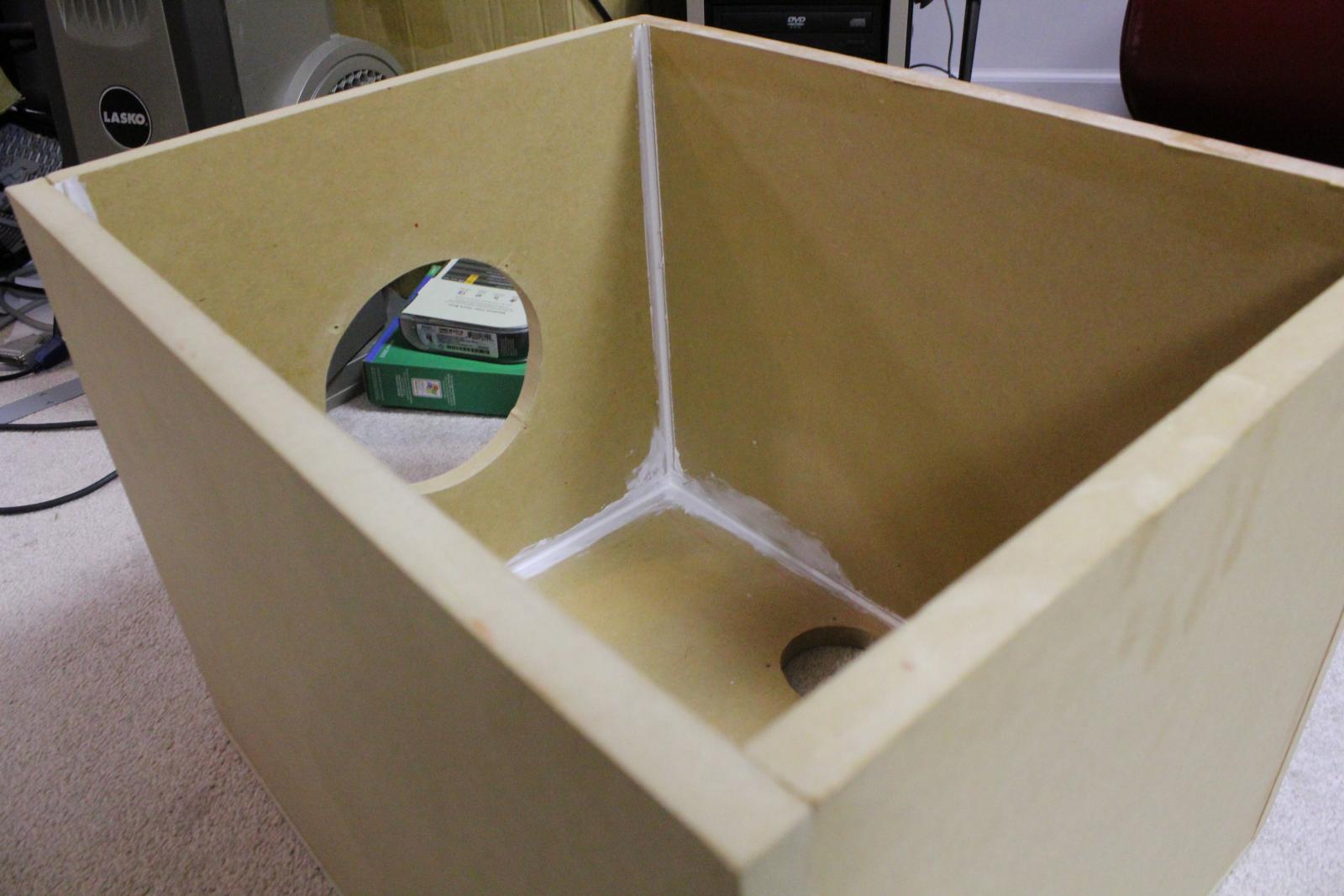

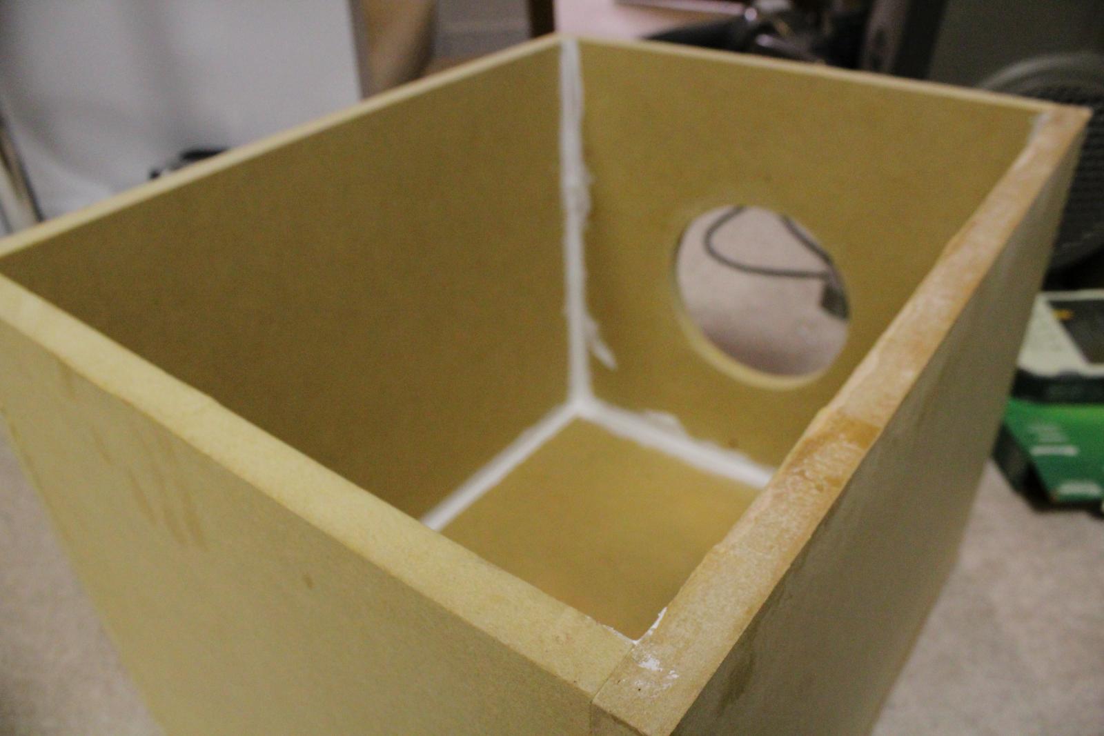

Just finished. Wood is 100% glued together. With the issue of splitting, and the fact a clamp got accidentally bumped (4ft clamp=MAJOR P.I.T.A) and took a half inch out of a corner. Thinking quickly we let the wood still clamp, soaked the piece in glue and held in place a few minutes then smearing caulk over it (left over silicon caulk from dining room being re-done) and it held up, even clamped well and is very unnoticeable. Since I had the silicon caulk I figured it wouldn't hurt to line the inside corners with it and did so, you'll see the white on the inside on some pictures.

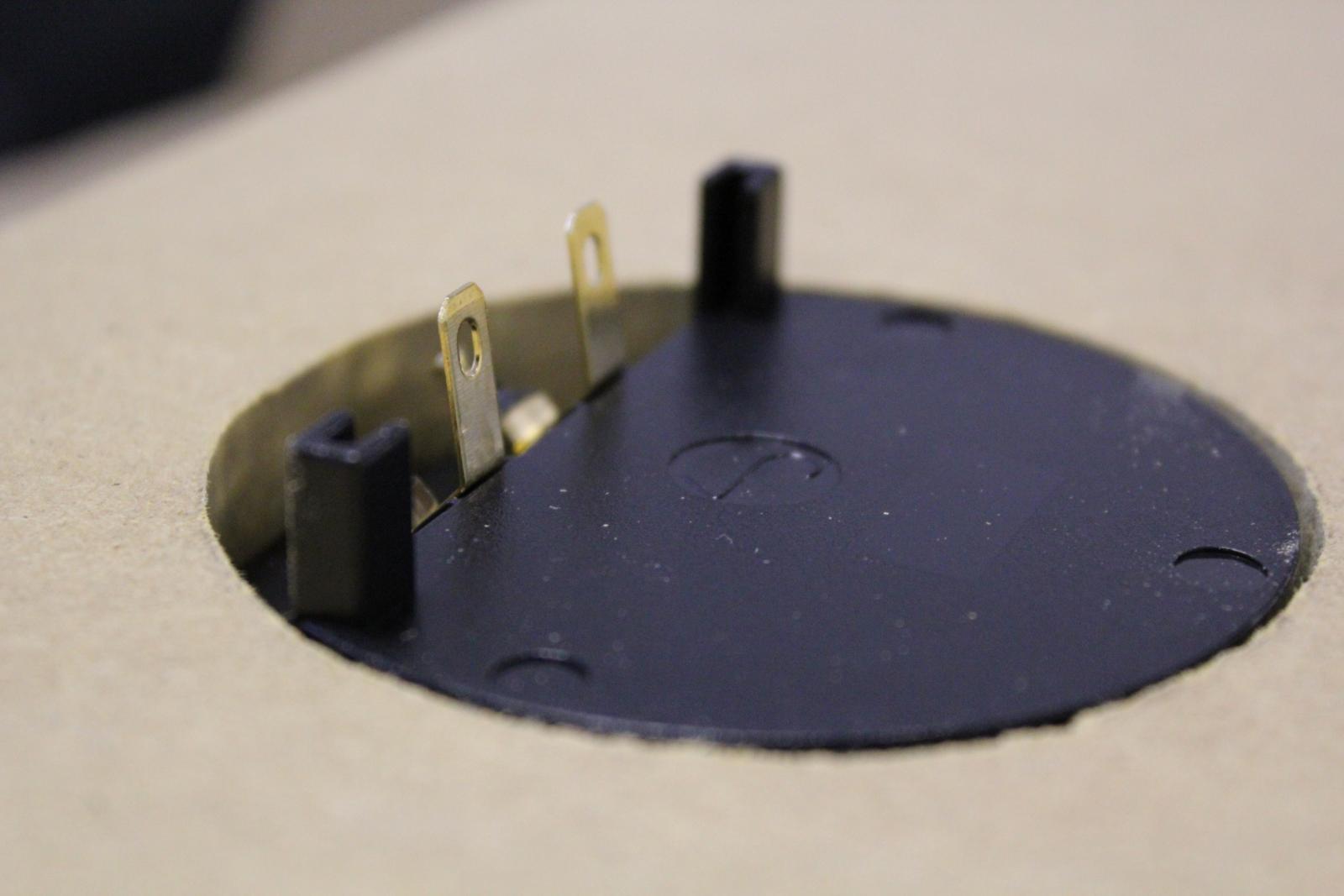

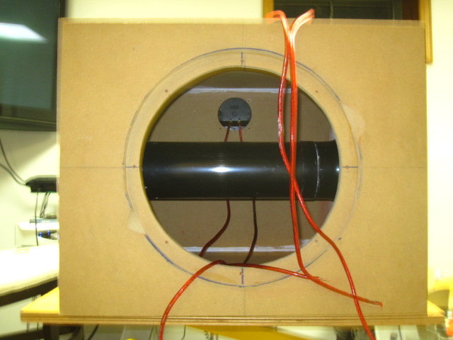

I remembered I had the 12 Gauge line from the Bazooka sub, cut that up and used it to run from the terminal to the woofer. Then from the terminal to the amp using banana connectors. Me and my Dad also then soldered the wires to the terminal cup so they are very solid.

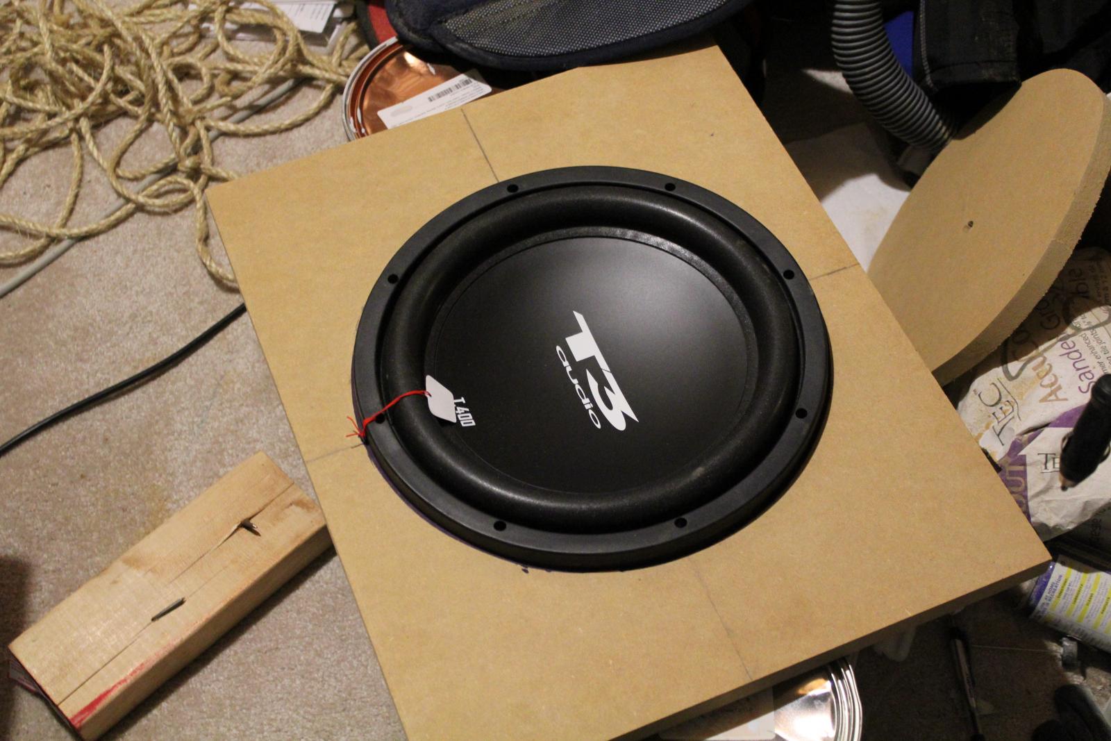

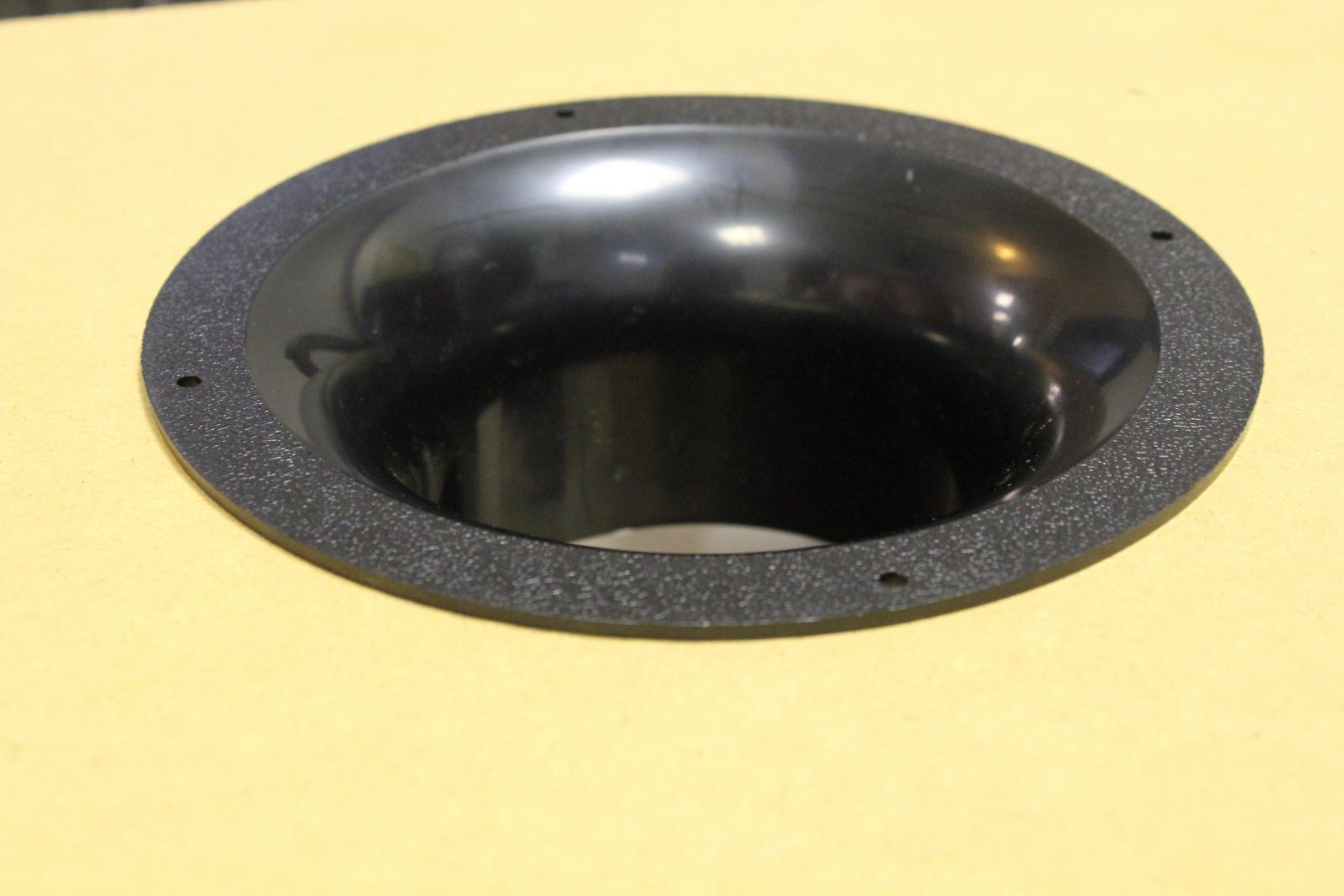

The port is screwed in along with the terminal cup, the last thing is the sub woofer which I haven't installed yet because i heard the fumes can be damaging to the woofer.
After it cures for 24 hours, which would be roughly around 6pm I will be dropping it in for a test run in the trunk!
Looks good! Good work. You didn't need the caulk, but it didn't hurt anything either. I'll bet that thing is rock solid now, lol. MDF boxes are nearly bulletproof. So long as you keep it away from moisture, it will pretty much last forever. I'll bet you can't wait to hook it up.
The fumes don't do anything to the sub by the way. People sometimes cover the inside with fiberglass resin and are fine installing the subs. Talk about some serious fumes there.

Trust me, the temptation to go and screw the woofer in and just plug it into the amplifier is very tough to overcome lol. I suppose I have something to look forward to when I get out of school tomorrow, assuming this storm here doesn't turn into a nasty ice storm..33F and its a heavy rain. Just waiting for the mix to start, but we'll see.
Is it worth creating some sort of barrier between the sub and the wood, to create a perfect seal something like a rubber ring, or would a direct screw in work just fine?
Oh I wouldnt doubt if this thing could stop a bullet, it surely could knock someone out though the damn thing weighs a good 20-30lbs, without the woofer!
It actually looks like the sub has a rubber gasket around the basket diameter exactly for that purpose, so the seal should be just fine.

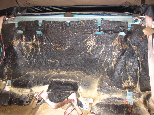

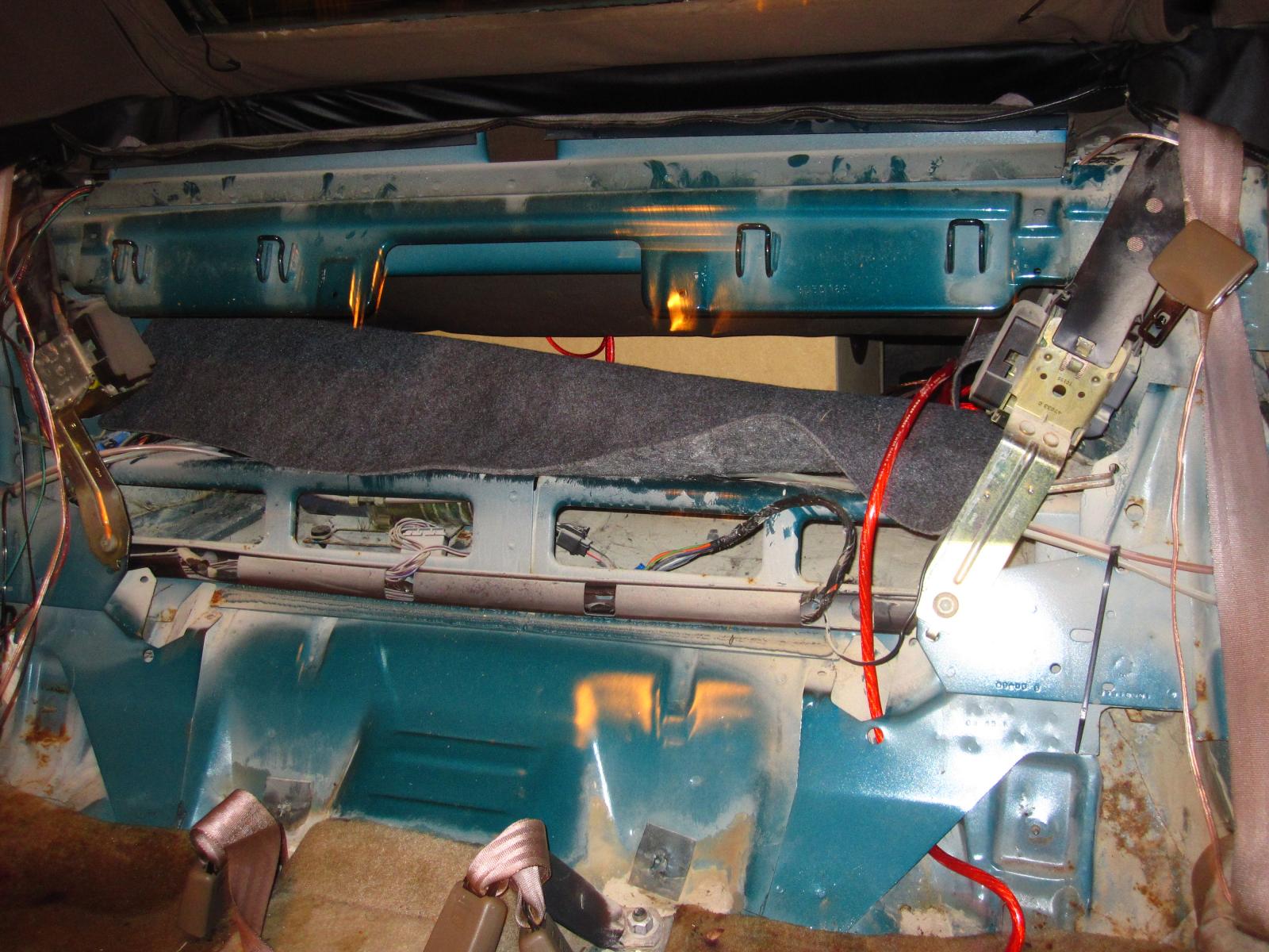

Got through the rear seat and removed the insulation layer.. should make the wiring MUCH easier and allow me to install the amps on a board very easily.
Again..working at night, but how could you pass it up when its 46degrees out at 11pm on a winter night?
Ill do all the hard work tomorrow when its nice and bright out
