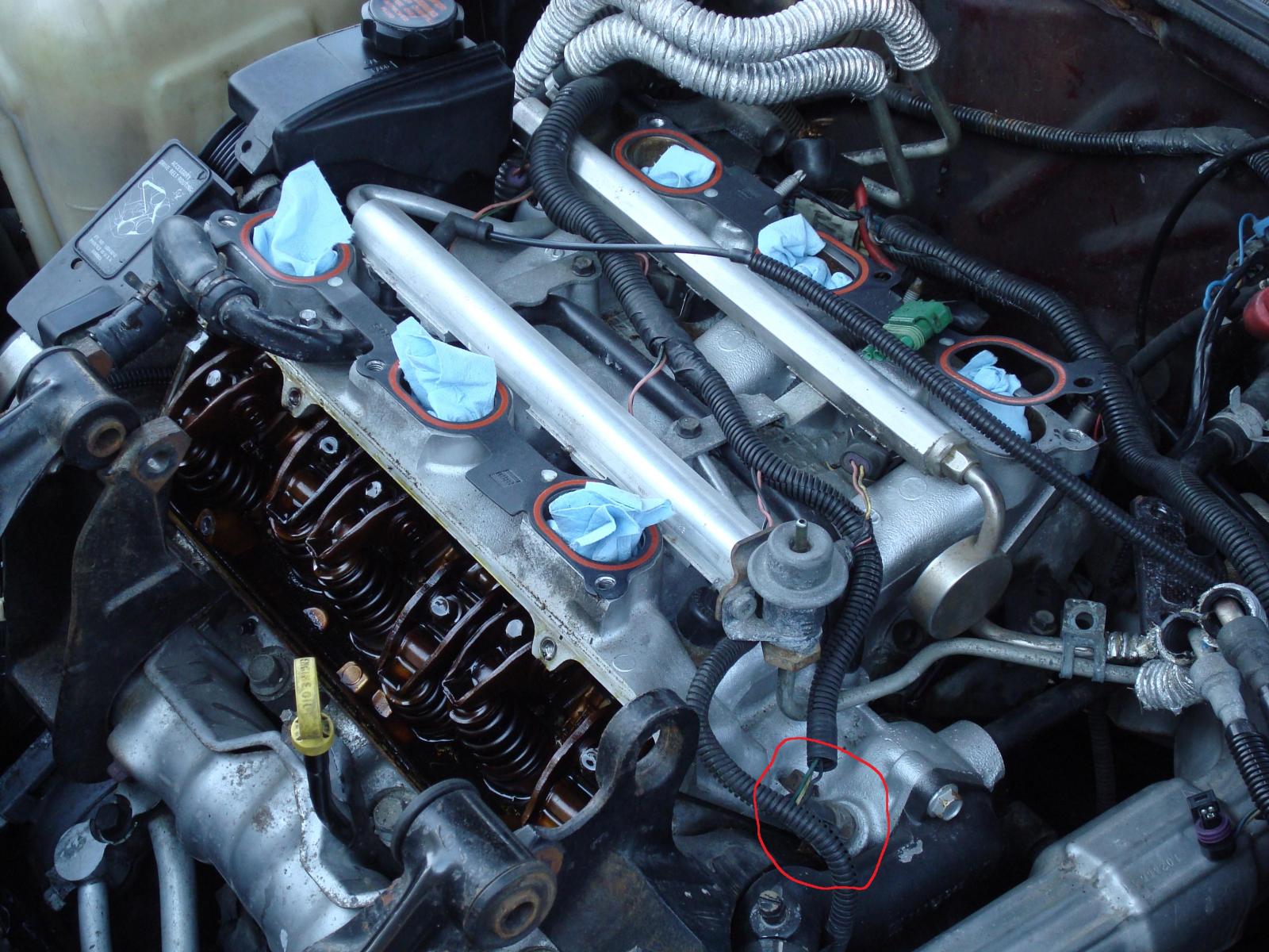

Being a 96 and OBD-2 it should have the 3 wire CTS like my 98. This is the best pic i could find on my computer of it.:thumbsup:
