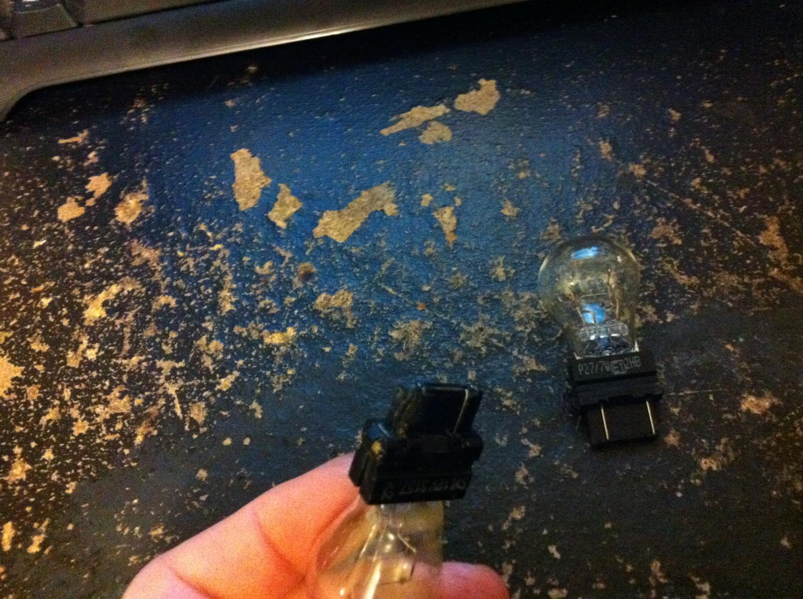

brake Posted December 23, 2011 Author Report Posted December 23, 2011 since you guys have been most helpful, i will repay your kindness by bothering you with another question. this is the bulb that was in my innermost rear d/s signal socket. i noticed it didn't work, though the outermost signal bulb did. neither indicator on that side worked with my 4 ways on. other side is fine.. took the dead bulb out and found this. it doesn't work with a good bulb now. though, the outer d/s signal light flashes with my 4 ways now that the bad bulb has been removed from the socket? seems odd. any idea what happened here? obviously there was some arcing and it burned up but i'd like to figure out why and where i should start looking given the odd operation. Quote
AL Posted December 23, 2011 Report Posted December 23, 2011 Looks like youll have to replace the bulb connector Quote
brake Posted December 23, 2011 Author Report Posted December 23, 2011 eh, no big deal. i could probably throw a rock in a junkyard and find a 3157 socket on whatever car i hit. Quote

rockfangd Posted December 23, 2011 Report Posted December 23, 2011 (edited) just my opinion the new sealed beam is much brighter and worth every penny. but can be expensive. I also find that the foglamps seem to have moisture issues that kill the bulbs prematurely. on my cutlass I replaced the complete assemblies. The connector must be melted and not making contact. replace the socket and bulb. and check for moisture problem in the lense. Edited December 23, 2011 by rockfangd Quote
