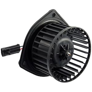

I've seen the following impeller designs for blower motors. The blue one is a new Delco/Delphi/TYC and the black one is Old Delco/Factory Air/VDO....
One has many more fins and it just strikes me as a better design. Did the design get revised somewhere down the line?

AC-Delco makes a big deal about selling an EXACT replacement part, but when I bought one for my '93 Lumina, the new part didn't look like the old one, and the fan had fewer blades, too.
The new AC-Delco motor and fan looked EXACTLY like the Communist Discount Junk heater motor, except the $60 motor said "Made In China" on the box, and the $160 Delco had a "Made in Canada" sticker on the motor.
The old fan was completely dead, so there wasn't much choice--I had to install a new one.
