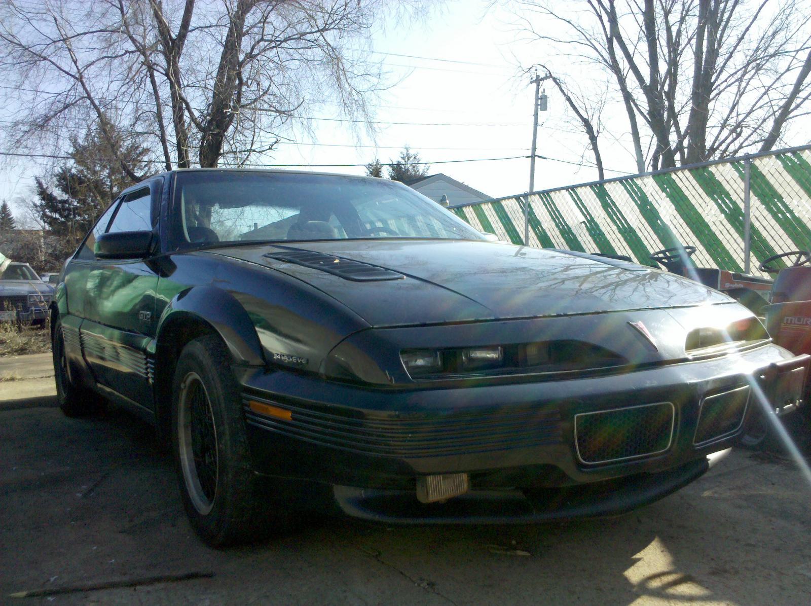

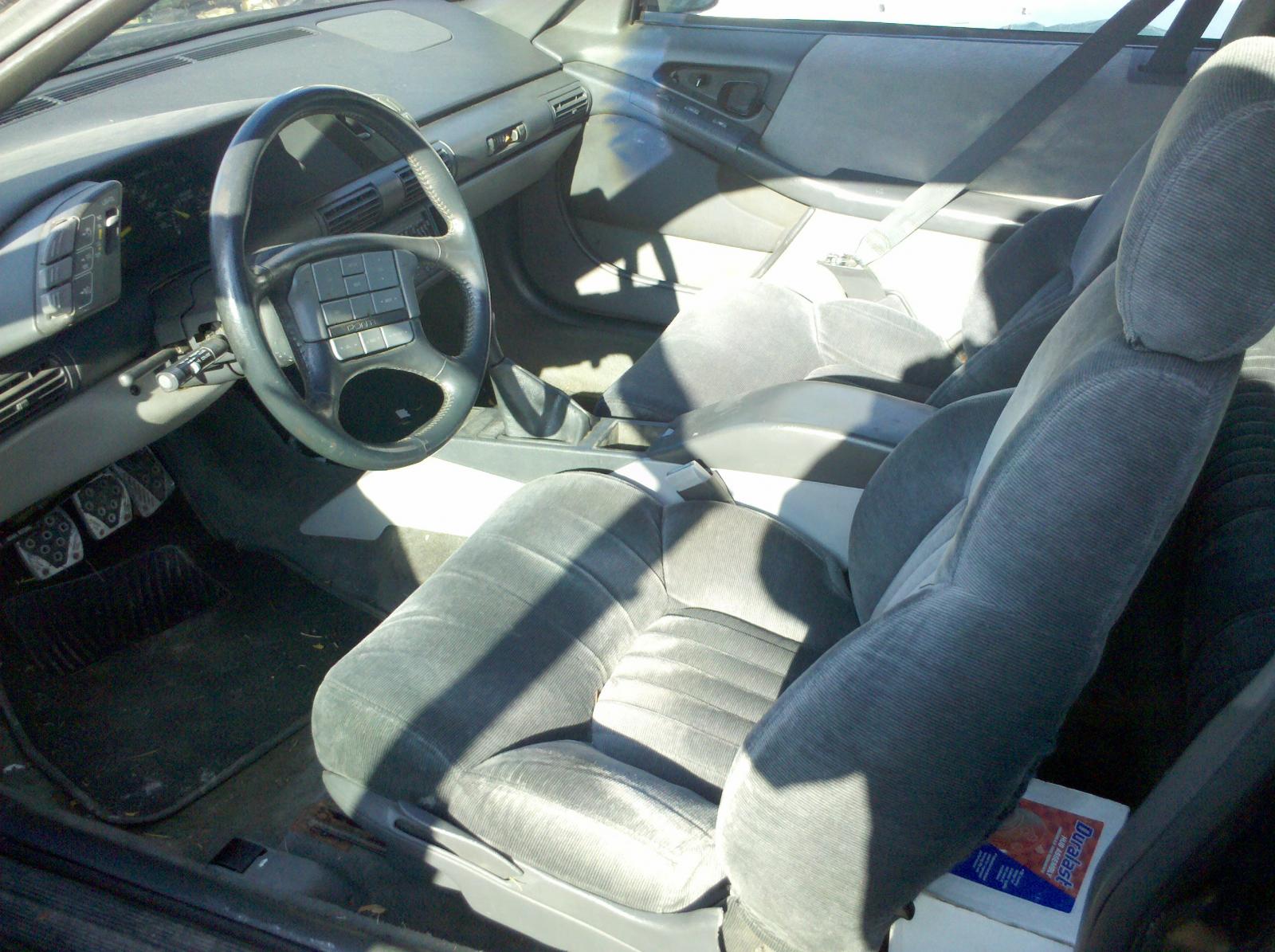

Shifter23 Posted December 12, 2011 Author Report Posted December 12, 2011 Here is the car by the way. I needs a repaint but it is all there. Quote
