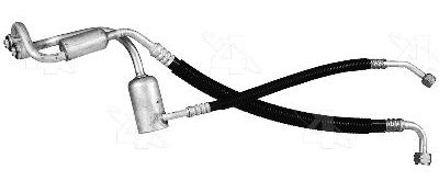

Red Nightmare Posted November 24, 2011 Report Posted November 24, 2011 In the GTP, I recently replaced the battery and noticed the hoses that were cut would not be as hard to replace as i originally thought... It looks like two hoses were cut but I don't know if there was an adapter or what so I will investigate this at a junkyard to see if any other components are missing and if it's practica to replace... Anyways before the summer, i would like to get the AC system in good physical condition and recharge it. Right now I don't know if the compressor or other components are good. Assuming they are - Once everything is in place, will it work if i just recharge it? There is nothing in the system as the hoses were cut (not by me, car was like that when I got it.) I have heard talk about purging/evacuating the system but would that still be necessary? Is there a way to test the other components without the system being charged? Also, the fan and everything work Quote
Red Nightmare Posted November 24, 2011 Author Report Posted November 24, 2011 this looks to be the part that is cut Quote
Schurkey Posted November 24, 2011 Report Posted November 24, 2011 (edited) Right now I don't know if the compressor or other components are good. Assuming they are - How long has the system been open to the atmosphere? AT MINIMUM you'll have to flush the evaporator, the condenser, and replace the desiccant pouch which means a new receiver/dryer, accumulator, or whatever else they're calling it nowdays. Your goal should be to remove every possible drop of contaminated refrigerant oil; and if it was me, I'd REMOVE the evaporator and condenser so they can be leak-tested before reinstallation. Some folks will disagree. The last system I did, ('77 Firebird) the evaporator and the condenser went to a radiator shop for flushing and leak testing. The evaporator tubing had perforated, but the rad shop managed to weld patches onto it, which is good since the parts were discontinued from GM and in the aftermarket. You will have to add the proper amount of refrigerant oil; and you're INSANE if you don't replace every O-ring in the system. If the system uses an expansion tube like the older GM CCOT A/C systems, you're crazy to not replace THAT, too. I kinda think your system does not have the expansion tube, though. Once everything is in place, will it work if i just recharge it? There is nothing in the system as the hoses were cut (not by me, car was like that when I got it.) Wrong. The system is FULL--of AIR. Air that includes ambient humidity, which means water entry into what should be a sealed system--and the water has been corroding stuff ever since. MAYBE it's not so bad inside, but the desiccant pouch will be saturated and useless; and the flushing of the main components will remove most of the contaminated oil. It MAY be that the desiccant is located in one of the aluminum "bottles" pictured with the hose assembly. I have heard talk about purging/evacuating the system but would that still be necessary? The air--and the humidity it contains--absolutely positively has to be removed. That's the purging/evacuating (evacuation) you've heard of. You seal the system, connect a vacuum pump to it, and "vacuum clean" the system with as close to a hard vacuum as your tool can generate. Some folks will say that an hour or less is sufficient...I leave the system under vacuum for as long as I reasonably can; which is to say "overnight" if possible, and never less than four hours. But then, I'm an extremist. Is there a way to test the other components without the system being charged? Also, the fan and everything work There's no good way to know if the compressor is still viable. You can do bench tests on the other system controls. It never ceases to amaze me how some boneheads can ruthlessly destroy an air conditioning system with the goal of "removing weight" or getting rid of "complexity"; and never having a thought for the poor bastard that comes along later who wants the system working again. Edited November 24, 2011 by Schurkey Quote
White93z34 Posted November 25, 2011 Report Posted November 25, 2011 It never ceases to amaze me how some boneheads can ruthlessly destroy an air conditioning system with the goal of "removing weight" or getting rid of "complexity"; and never having a thought for the poor bastard that comes along later who wants the system working again. Let me tell you ALL about that My advice. replace damaged components. replace drier. replace orifice tube. Replace seals in that area. Inspect the condenser, likely replace that too, those go often from rock hits to road salt. Put a vacuum pump on it for a hour or so. measure this with manifold gauges. if it looses vacuum you have a leak. fix and correct. Quote
