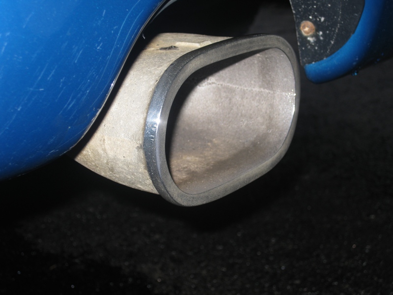

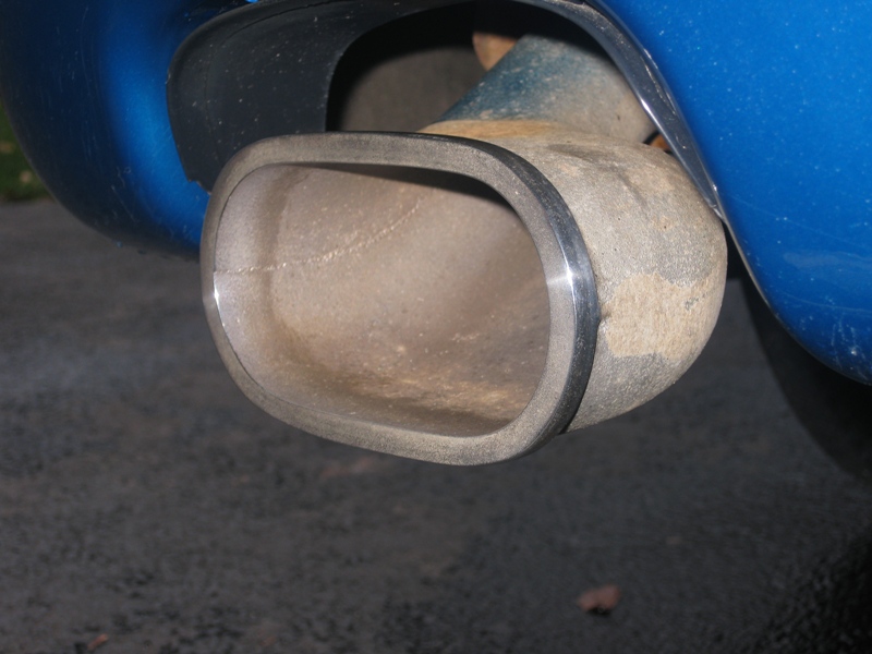

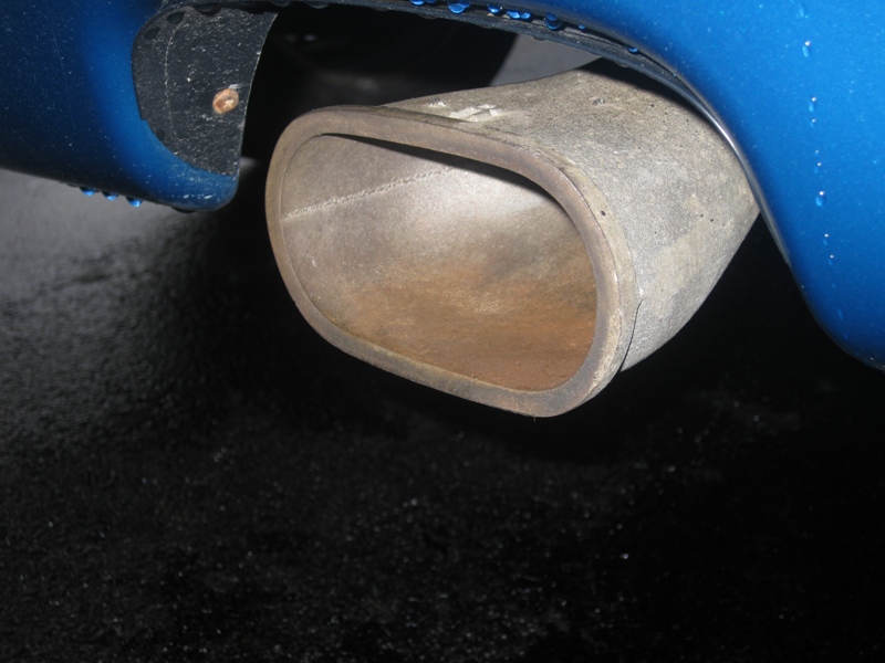

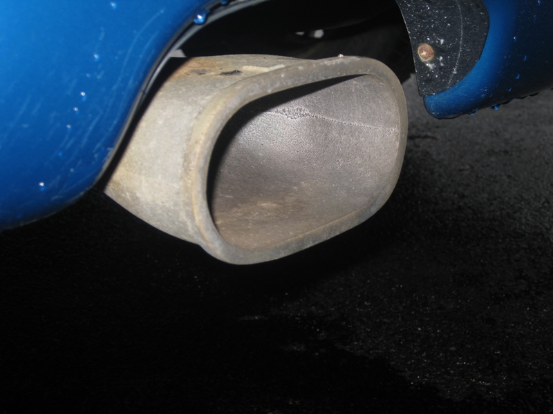

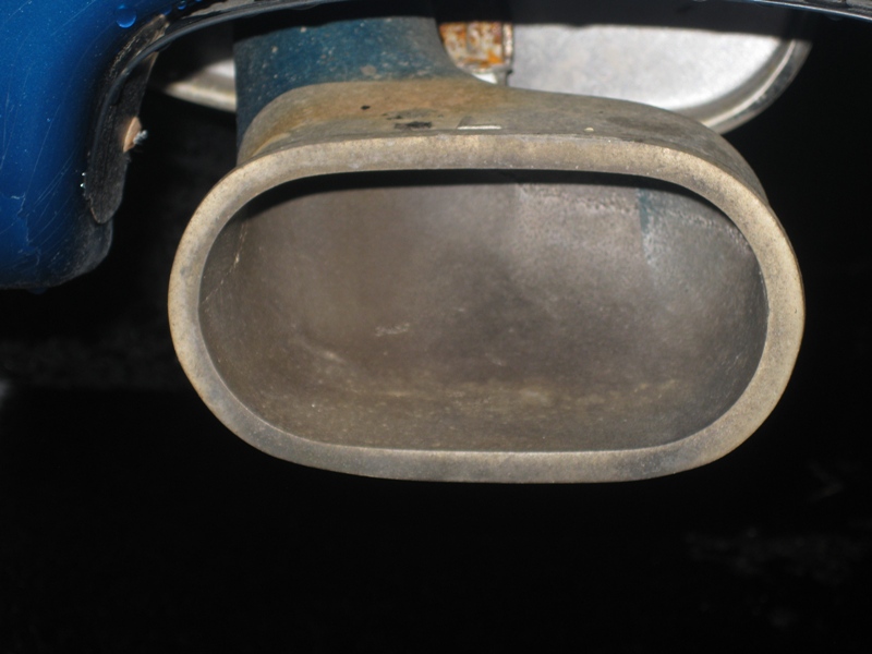

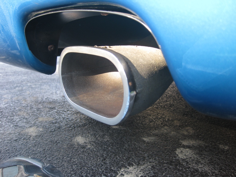

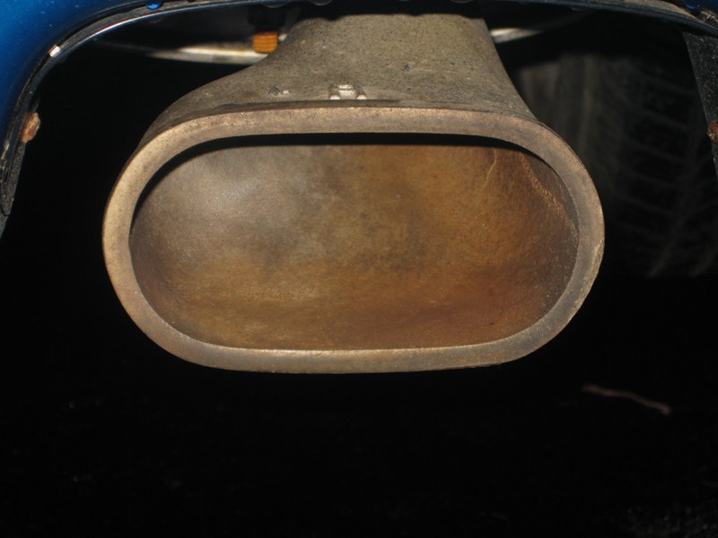

BRZN Posted November 23, 2011 Report Posted November 23, 2011 (edited) Well, I guess they do! 17 years of neglect taken care of in about an hour and a half. WD-40 on 0000 Steel Wool, then Mother's Mag and Aluminum Polish finished with Adam's Metal Polishes #'s 1 and 2. Left Tip done, I'll do the right tomorrow. Too cold out and my hands are sore. Damn! Edited November 24, 2011 by BRZN Quote
94 olds vert Posted November 23, 2011 Report Posted November 23, 2011 Very nice!!! They are very easy to keep clean now. Quote
skitchin Posted November 23, 2011 Report Posted November 23, 2011 I started to do mine - almost seemed like I went through a layer of silver and it started looking dull... is that just my mind or can you go too far? Quote
GOT2B GM Posted November 23, 2011 Report Posted November 23, 2011 Nice , you went a step further than most and did the rim of the tip too, not just the rearward facing face. Quote
GOT2B GM Posted November 23, 2011 Report Posted November 23, 2011 Its cast aluminum throughout so I don't think you can polish too far. Quote
BRZN Posted November 23, 2011 Author Report Posted November 23, 2011 Yea, looking at them, it just seemed to make sense to do the entire lip. I taped off the lip so as not to polish any further up the tip. It's really hard to believe these were polished from the factory. There are, what look like, machine marks on the lip and rough cast marks still on the lower portion of the rear facing lip. That being said, they look so much better polished! Also, agreed you can't go too far. What you use to polish has to contiunue to get less and less abrasive as you go to get a mirror like finish. Quote

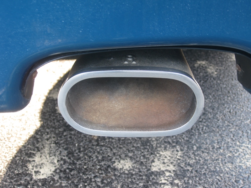

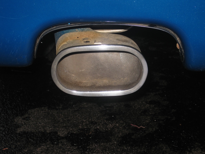

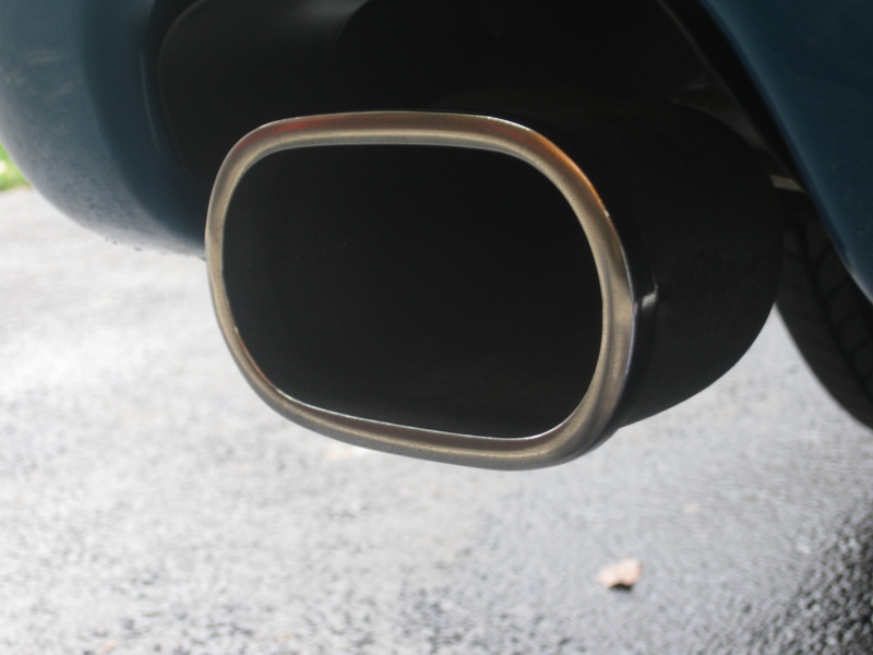

BRZN Posted November 24, 2011 Author Report Posted November 24, 2011 Finished the right side, they came out just as nice as the left side I did yesterday! Befores and afters: Quote
