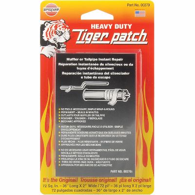

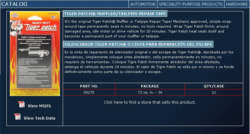

Tiger Patch
Part #00270
ITW VersaChem Tiger Patch Tech Data
I had an exhaust leak at the point where the front pipe meets the pipe that goes to the Catalytic converter. There was no clamp or weld there... it was blowing out the seem pretty good.
I tried using a clamp... I went to AutoZone and the AutoZone associate I spoke to was very helpful. I have a bad back... and some Titanium parts in my lower lumbars... the AutoZone person was kind and enthusiastic about helping me... as he crawled underneath my car to make sure I had the right size clamp.
I had no luck with the clamp. I thought I would have to get it welded. I found this Tiger Patch at AutoZone... I thought for $3.99 it was worth a try.
I followed the directions and the Tiger Patch did exactly what it said it was going to do. It took all of about 5 minutes. It's been about a month and the seal is tight and seems permanent.
***** 5 Stars
Lumina - Tiger Patch Tech Data.pdf

My Tiger Patch Works Like a Charm!... maybe it's just other muffler band aids that are junk... like that plaster bandage mummy wrap crap... Let's be thoughtful and specific... focused... on a single product.
For $3.99 + tax and a not too many minutes of your time... following the directions properly... Tiger Patch has gotta be worth a shot... You want to save money... Yes? ...Tiger Patch could avoid a costly labor charge... You want to save your valuable time... Yes? ...what about the inconvenience of dropping your car off at a shop... where they often find something else they want to charge you for... or wouldn't you want to be using your time to do other things with your car?
At the least... $3.99 could Buy You Time... while you're saving your dough to get that fancy new trick dual exhaust system you've always wanted. $3.99 has saved me a trip to the shop... time and money... I don't have a lot of money... nor do I have a lot of time. I have a pile of other issues that I've been addressing with my car... Tiger Patch is allowing me to do that... 4 bucks plus tax... and there's a great chance the repair is permanent...
I'm an electro-mechanical technician of sorts... and right now I work in the area of facility maintenance at a string of local hotels... I have a long history of fixing a wide variety of "stuff"... and finding quick fixes to buy time... I've used miles of other "band aid" type wraps for other uses, especially plumbing, where the tapes didn't work at all or were temporary at best. I do have some stuff that I use on the job for quick plumbing leak fixes that seals tight and lasts til I can get around to doing the job right... and replacing parts...
Tiger Patch claims it'll outlast your existing exhaust system... I believe it.
I have a treasure trove of goops and tapes of every kind... and I'm always looking for, getting, and trying new products... I gotta tell ya... this Tiger Patch impressed me... in that following the directions, it did exactly what it said it would do... and I was somewhat amazed at how well it did it... and how fast... It was like... I opened the package and boom! ...it was done! ...it's a nice solid quiet strong seal... and when I look at it... I think to myself... yep! I bet that thing will be settin' there after my car has rotted all around it. I'll try to get a decent pic of it to post.
We'll see what happens... I'll follow up on this product periodically... and I hope others pass on their experiences as well.

Yes! I believe it will... is it a hole in the pipe... or is it at a joint... whatever... if it's a big hole you can cover it first with a screen or something... after you wrap it, and before you run the engine to fuse it... you can secure it with any kind of tape or tie wire... but the thing is... wrap it good... heat it up and that's the name of that tune! ...after it fuses... which is rather quickly you can remove whatever you used to secure it with.
When I did mine the pipe was already warm... it was kind of cold out... and it was night... and I didn't have any real good light... the tape was sticking good as I wrapped it... but I wanted to make sure I was getting around the leak real good... you know what I did... I cranked up the engine... I did mine while the engine was running and before the pipe got blistering hot... it sealed the seam/joint up, silenced it, while it was blowing exhaust out of it! ...and then fused up and I was done... Amazing!
I don't recommend you do what I did... you could get a good blister... and maybe have to use a "band aid" (ha!)...
DO IT! and GOOD LUCK! Let us know how it turns out...
