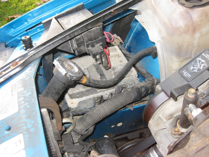

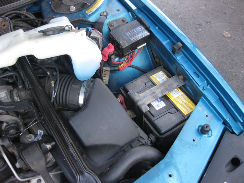

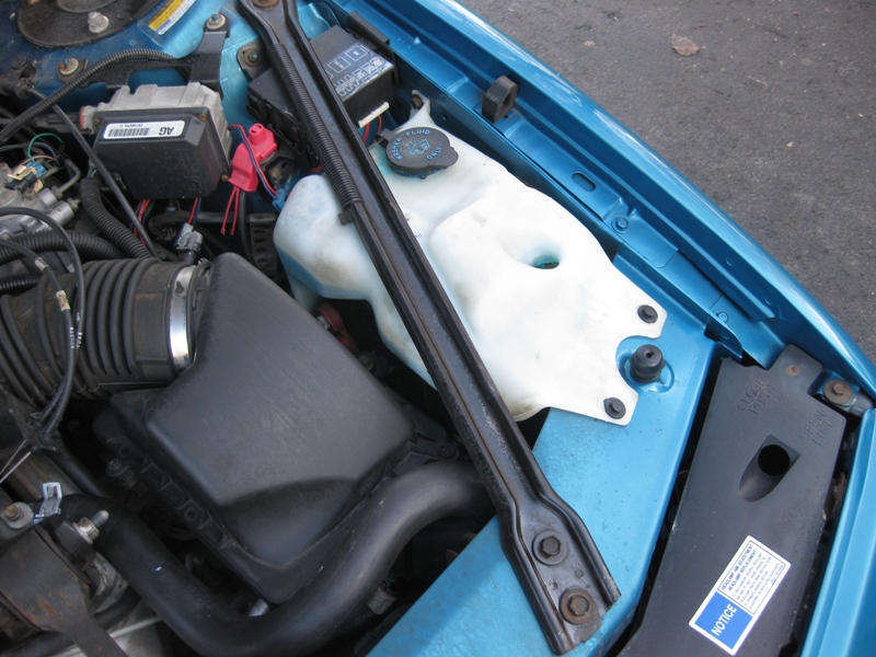

BRZN Posted November 20, 2011 Report Posted November 20, 2011 Who decided to put the battery here on my '94 GP SE? Windshield washer fluid reservoir: What's that hiding under there? All this just to get to the battery? What's this? The ECM sitting over on the otherside all by itself? I'd just think it would have made more sence to switch these two around for easier access to the battery. Quote

Psych0matt Posted November 20, 2011 Report Posted November 20, 2011 How is that so hard to access? A few bolts, move it out of the way, you're at the battery (Not arguing that it's the smartest design ever, but it isn't hard at all) Quote

Euro Posted November 20, 2011 Report Posted November 20, 2011 Don't worry the 97+ cars had this inconvenience fixed The washer reservoir and battery got switched Quote
skitchin Posted November 20, 2011 Report Posted November 20, 2011 Yeah, having the washer jug above the battery or ecm is sketchy, should that ever leak. Quote

brake Posted November 20, 2011 Report Posted November 20, 2011 Foolish spot to put it, but it's maybe 5 minutes more work. 2 bolts on the brace and 1 or 2 on the tank. Quote

pitzel Posted November 21, 2011 Report Posted November 21, 2011 The battery isn't much of a PITA on the 1992 Cutlass compared to the ECM/ECU, which is located *underneath* the coolant recovery tank (which is considerably larger than the one depicted in a photograph earlier. Really not looking forward to the day when I have to drain the cooling system and remove a considerable number of pipes just to replace the ECU. Quote
mra32 Posted November 21, 2011 Report Posted November 21, 2011 How often are you guys replacing the battery where this is an issue? Its not like thats where the fuel filler is. That picture shows that your airbox is in plain sight and air filter service/replacement happens on a much more frequent basis than replacing a battery. Pitzel, you will lose no coolant if you ever have to replace the ECM. Ive had to replace mine but its supposedly quite rare to replace an ECM, anyway. Its a coolant overflow tank, so disconnecting the line to it will not affect the rest of your coolant system. All you have to do is disconnect the line to the radiator filler neck and undo the 2 stamped nuts that hold it on. Should take you no more than a minute. Its more difficult to disconnect the wires from the computer than to access it. Due to its shape, the tank uses more plastic but holds about the same volume as the windshield fluid reservior. It can also easily slide right out of the engine bay. I really havent found a car easier to work on than my old 3.1 Lumina, other than doing spark plugs. And 3 of those are super easy to do anyway, so its still not that bad Quote
