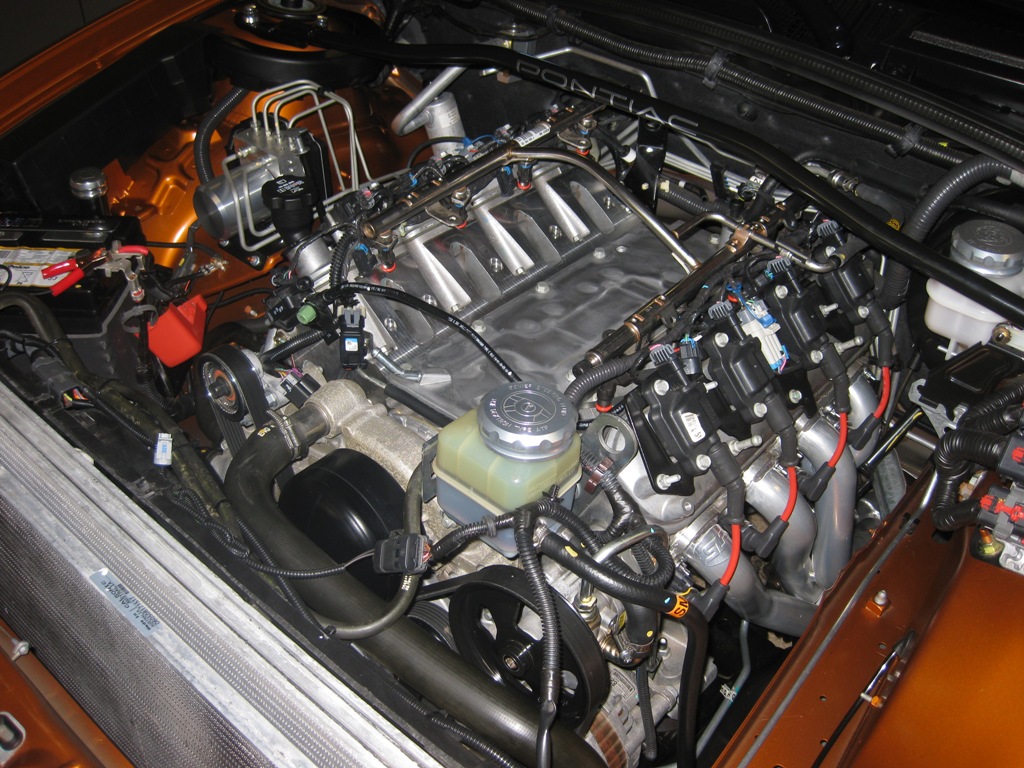

BRZN Posted November 15, 2011 Author Report Posted November 15, 2011 (edited) Oh, I know I could do it, and have many friends that'd be willing to help: I just don't have the time! Kinda' sucks when you put things into perspective: I go to work to make the money to pay someone else to do what I can do but don't have the time to do because I'm at work. Edited November 15, 2011 by BRZN Added a picture Quote
