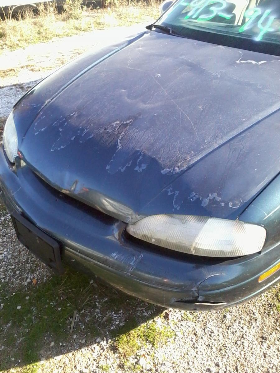

AMP Posted November 11, 2011 Author Report Posted November 11, 2011 For money that is a great buy! oh yeah put a windshield in it clean the interior fix the dents and hood and some paint and it good. Quote

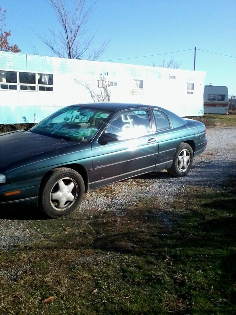

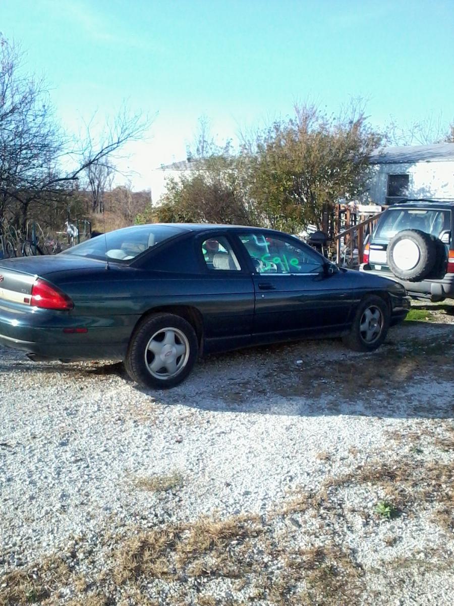

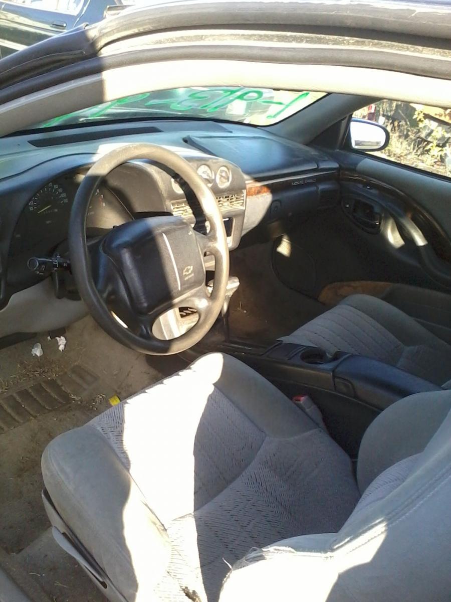

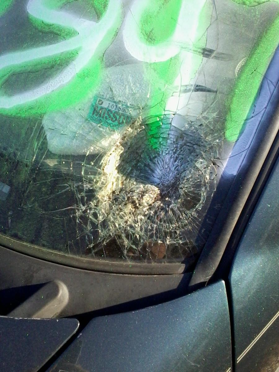

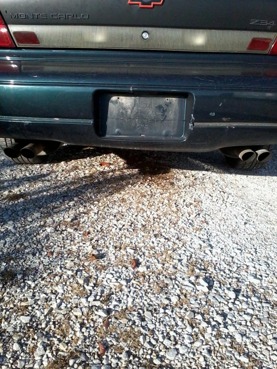

88red4cyl Posted November 12, 2011 Report Posted November 12, 2011 lol i tried to give one away for free (needed a motor) Had new tires, wires batt, fuel pump, and plugs.... same color and all.. no one wanted it! Next time holler at me! I never saw that either... Z doesn't look too bad... Most Z34s I see have most of the options, but that one doesn't seem to have any? That's how my LTZ was, and apparently it was very uncommon for them to be optioned (or unoptioned in this case) that way... Looks like with some elbow grease it'll clean up well though! Quote

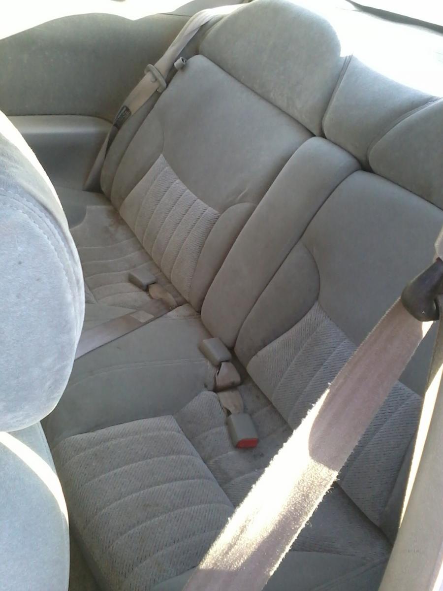

Mel87 Posted November 13, 2011 Report Posted November 13, 2011 Damn not too shabby! Interior looks in nice condition, would probably clean up real nice, along side the engine compartment. Quote
Euro Posted November 13, 2011 Report Posted November 13, 2011 Spray paint for sale signs hopefully you guys can clean it up and make it look nice! Quote

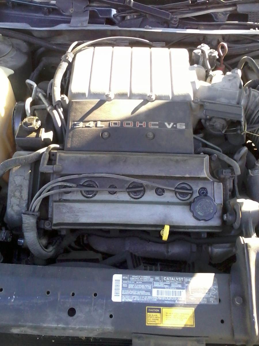

AMP Posted November 13, 2011 Author Report Posted November 13, 2011 Spray paint for sale signs hopefully you guys can clean it up and make it look nice! it was actually some weird color window chalk i believe, came off pretty easy. yeah it should clean up nice go to do some work under the hood found out that the heater core has been bypassed and something else has been too but not sure what it is i think something else to do with the heater core but not sure. Quote
