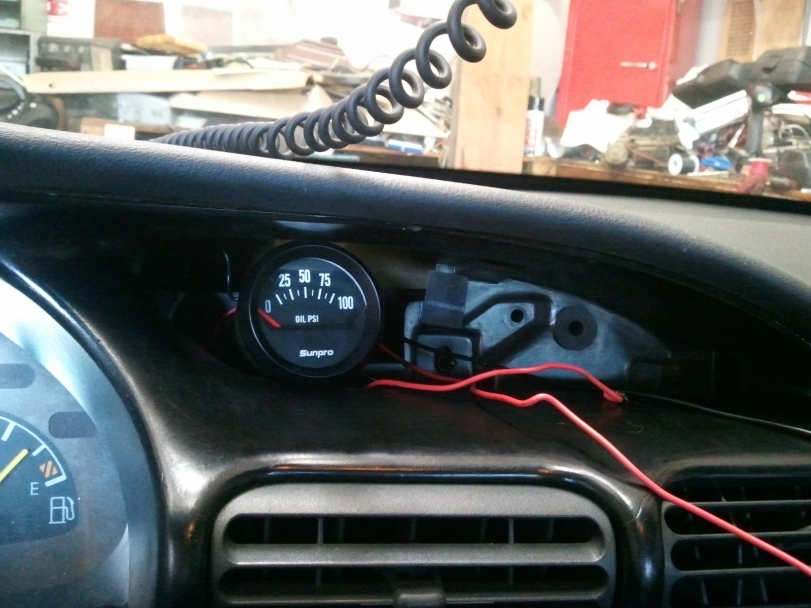

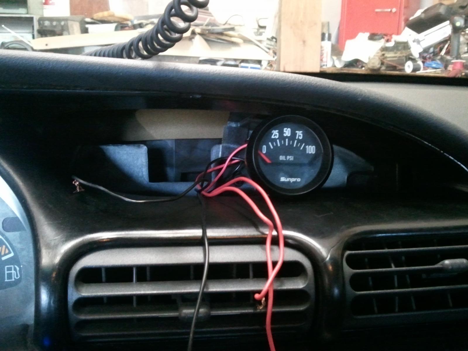

white4d96 Posted November 10, 2011 Report Posted November 10, 2011 My friend gifted me a volt meter, so we made a little 'pod' out of the cubbyhole in the center of the dash. It's the perfect spot for some gauges. I'm thinking about putting in an oil pressure and oil temp gauge. Thoughts? Quote

white4d96 Posted November 10, 2011 Author Report Posted November 10, 2011 Same here, but I figure a trans temp gauge won't really be useful in a basically stock car. When I bought the car they attributed the first motor's demise to loss of oil pressure (I'm thinking snapped cam?) so I figured that would be useful, same with temp. I would love to get a water temp gauge that's more accurate than the stock one, but it doesnt really make sense to have two of them. Quote
skitchin Posted November 11, 2011 Report Posted November 11, 2011 I started doing this! I got a bit stuck on the design though. I had just sort of dived in trying to make it - picked up a cheap sheet of abs plastic and got a hole saw drill bit. TBH where I got stuck was how how to keep it all in place. Also, doesn't seem like you could get more than 2 gauges in there. Might play around with some stuff here in a few, got the day off Edit: Btw, thought it were worth mentioning that I managed to add an oil pressure sensor + keep stock low pressure sensor to keep the dummy light working. Quote

skitchin Posted November 13, 2011 Report Posted November 13, 2011 white4d96 said: Skitchin where did you tap into for oil? I was mulling a filter adapter but if you have a better setup... The stock dummy sensor is on the front of the motor right next to the oil filter. I just used a 1/4" NPT tee adapter and sealed the shit out of the threads. Quote
skitchin Posted November 13, 2011 Report Posted November 13, 2011 Btw I was fooling around and it seems like you could really only get two gauges in that center cubby hole. Even then I think this gauge I have will be a squeeze. Only other gauges I can think to add would be transmission temp, voltage, and amps. I'd be happy just to get this damn thing in place >_< Quote

white4d96 Posted November 14, 2011 Author Report Posted November 14, 2011 That's kinda what I did with mine. It's a frosted plexi insert with a hole cut in it for the gauge. I'm mulling backlighting the plexi with LED's or just painting it. Quote
skitchin Posted November 14, 2011 Report Posted November 14, 2011 Pics? Curious how it's all held in there, if you used the stock back piece etc. Need to get mine mounted before it gets broken. Quote
white4d96 Posted November 14, 2011 Author Report Posted November 14, 2011 I took the back piece out and epoxied the plexi in its place. I'll grab pics next chance I get. As far as securing the gauge, mine came with this weird clamp-style mount that I stuck on it behind the plexi to secure it. I took the clamp off that mounting bracket and stuck that to the gauge. Quote

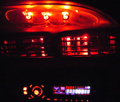

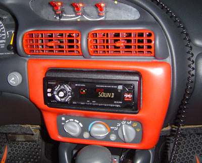

Venom Posted November 15, 2011 Report Posted November 15, 2011 That Grand Am GT panel is bad ass! I wonder how they made it? Quote

jake91 Posted November 16, 2011 Report Posted November 16, 2011 (edited) Venom said: That Grand Am GT panel is bad ass! I wonder how they made it? the guy got the cassette cubby out of a 99 ga, then had a peice of plexi cut out to size, painted it black, laser engraved it so light would shine through, and tapped into the cig lighter for the backlight Edited November 16, 2011 by jake91 Quote
