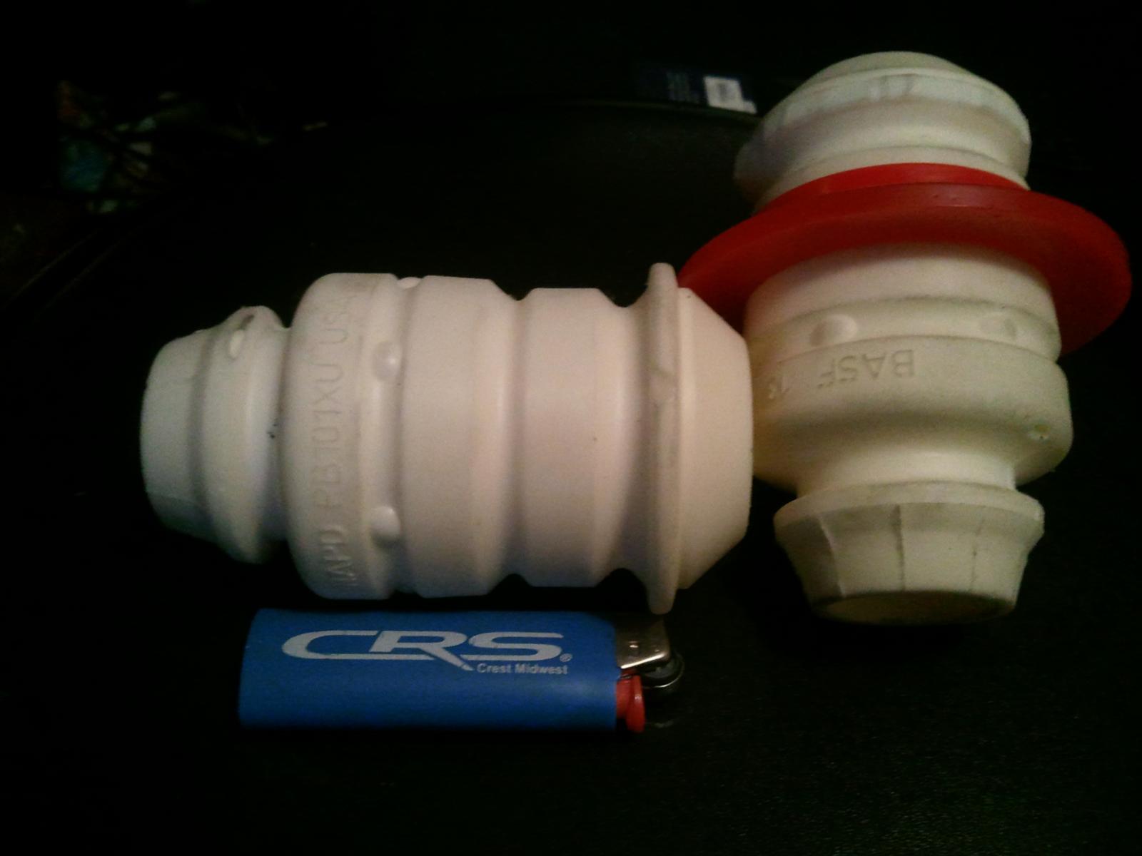

skitchin Posted November 13, 2011 Author Report Posted November 13, 2011 Do you reckon something like this? http://www.summitracing.com/parts/KYB-SB106/ [from other site]"Includes a travel-limiting bumper that prevents the strut from bottoming out; This high quality strut boot keeps dirt away from your strut to prolong its optimum performance." Quote

skitchin Posted November 23, 2011 Author Report Posted November 23, 2011 Just got my bumper/boot kit - the rubber jounce bumper is waaay different . It's a lot longer - proper diameter for the isolator to slide over though. Thought it could maybe work because it gets a bit wider halfway up - but the isolator is able to slide completely up and off. I might be able to hack the top part off that goes into the mount so that the isolator just sits flat against the mount after pushing all the way up... Thoughts here guys? Quote

skitchin Posted November 25, 2011 Author Report Posted November 25, 2011 I bought KYB GR2's. The problem though is I need something to keep the coilover isolator in place - bxx showed how to use a stock jounce bumper to do this, but I'm guessing the bumper he used was GM, and the one I got is KYB. You said your struts came with a mount? Did you order a coilover kit from somewhere or? Quote

AWeb80 Posted December 2, 2011 Report Posted December 2, 2011 (edited) Uh......you don't need those jounce bumpers. Is the weight of teh car on that spring? if not, the spring will compress and then the jounce buumpers will be in the way. You'll have no dampning...it'll be a solid ride. if the weight is on the spring, then when yo hit a bump it's going to jam against the strut housing. take those out of there. Edited December 2, 2011 by AWeb80 Quote
skitchin Posted December 2, 2011 Author Report Posted December 2, 2011 I replaced my mono-leaf with this setup. Problem is there is no upper collar, so the jounce is sort of acting like a floating collar. I'll keep everyone updated... Quote
