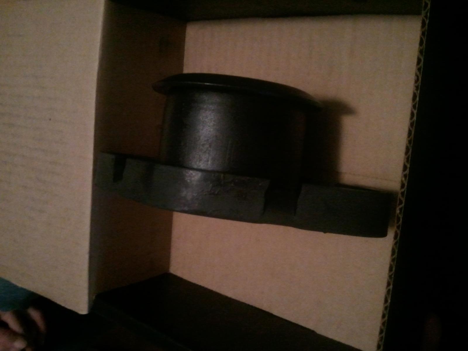

skitchin Posted November 13, 2011 Author Report Share Posted November 13, 2011 Just got my upper mounts and they aint gonna fuckin work - these replacement mounts don't have that lower bellow where the spring isolator needed to slip on  Quote Link to comment Share on other sites More sharing options...
BXX Posted November 13, 2011 Report Share Posted November 13, 2011 THose mounts need to haz the jounce bumper to work. It's a hard urethane foam doohicky that is shoved inside the mount there. It will center the spring and isolator. Not perfect, but cheap and decently effective. Quote Link to comment Share on other sites More sharing options...
skitchin Posted November 13, 2011 Author Report Share Posted November 13, 2011 So these mounts a no go or is there a separate part I can press in? In any event, I don't know why I didn't try to order these from the GM dealership, they usually give me employee discounts even after all these years. Quote Link to comment Share on other sites More sharing options...
BXX Posted November 13, 2011 Report Share Posted November 13, 2011 The jounce bumper should come with the boot kit Quote Link to comment Share on other sites More sharing options...
