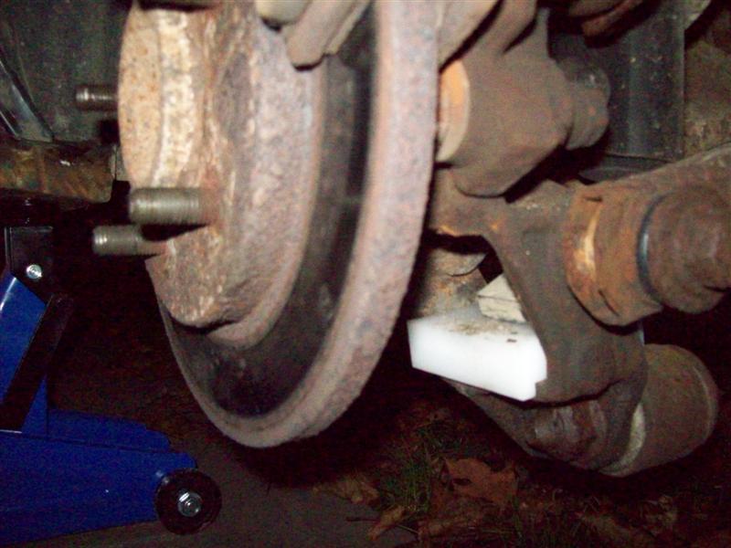

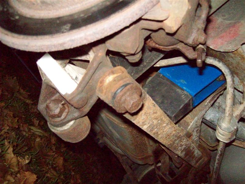

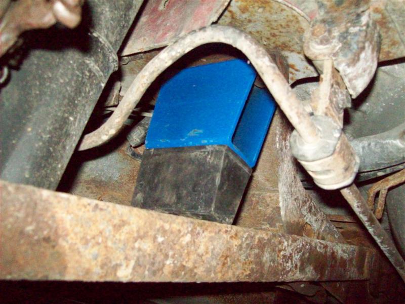

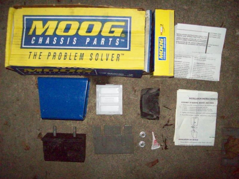

90V6RedHotLuminaEuro Posted November 18, 2011 Author Report Posted November 18, 2011 (edited) Hey People.. Hope you're all having a pleasant day... I installed my Moog K6544 Rear Transverse Spring Isolator Pads and my Moog K6000 Leaf Spring Helpers today... just a while ago... passenger side in the dark... it started snowing (???!!!) just before I finished. I would have finished a bit sooner than I did... if my electric impact wrench with universal joint and 15mm socket didn't throw one of the Leaf Spring Support to Frame bolts under the car and into the grass and leaves and mud... watchagonnado? Below are some pics of the parts as contents of half a box... and as installed... The Helpers came with Shims... but I don't think they're necessary... I did try them on... the car was higher and felt very hard when I pushed down on it... they probably would make for a very harsh ride. I suppose you would need them if you were towing a boat, or house, or something. I just thought of something... I'm not sure what the code is for my leaf springs... I wanted to get that while I was doing the job... attached is a pic of my RPO Codes... if anybody can tell me from that what "firmness" of spring I have... I think it might be a heavier duty one for the Euro... I would expect that.. but it sure looked saggy to me... 22 years old... can't expect too much... glad it's not broken! The job went relatively well for me... I'm not a professional mechanic and this is my first go at monkeying around with the leaf spring assembly... I did the struts this past September... for a more experienced... knows-bunch-about-his/her W-Body person... with a garage (and not a mud pit) and some air tools... could probably whip it out before his coffee gets cold. I have a little cement walkway surrounded by grass, leaves, mud... that I work on. I get one side of the cars wheels up on it so there's still room for my jack, jack stands, wheel chocks, tools, etc... and then I turn the car around and back up onto it the same way... that alone kinda eats up some time... watchagonnado? I jacked up the car... and put a jack stand under the leaf spring... then let the jack down allowing the weight of the car to work for me... the leaf spring sitting on top of the jackstand rose up while the car went down. I then chiseled out the old pads with a good hammer, a big screw driver, and a really good strong putty knife that has a chunk of metal on the end for just such type of pounding. There was room to work, but I believe if you removed a couple of other items... there wouild be more room and getting the old pads out would be a little easier. I did remove the disk brake shields... do I need those things by the way? The new pads slipped in easily. Having a very vintage electric impact wrench was very helpful for getting the lug nuts and frame bolts off and on. If you do the Helpers, make sure you put the rubber part on before installing the metal part to the frame... The first Helper I installed.. I didn't tighten the nuts for the rubber part and it was hard to tighten them with the metal mount installed on the frame. The next pad, I bolted the rubber part on first and that's the way to go. I had to move the car to find my missing frame bolt... thankfully, that didn't take long (sheesh!). After getting everything put back together I gave her the once over. She sits up higher now and no longer looks saggy in the butt. I test drove her on the highway and around the pothole road around my trailer park... making sure to hit all the potholes... I had filled the tires with the max amount of air this afternoon (44 psi)... I just got these tires used... I noticed they weren't holding air so well... probably sitting for a while... I thought I'd max the air pressure for a bit to better seat the bead... The car has a harder ride but not so bad... it was fine for me... and when I adjust the air pressure to the recommended 30 psi... she'll have an even nicer walk. I'll get some pics of how she sits (it's too dark now)... but I think she looks more "Planted"... and/or Sure Footed. Attached is a Pic of my Lumina Before the pads and helpers. Edited November 18, 2011 by 90V6RedHotLuminaEuro Add content Quote

90V6RedHotLuminaEuro Posted November 19, 2011 Author Report Posted November 19, 2011 I've never seen that product before, very interesting. It definitely raises the rear end up and gives new life to an old spring... a slightly harder and bouncier ride... especially with no weight in the back seat or trunk... I no longer have a spare tire, jack, or any of that junk in the trunk... and I believe I may have the least expensive struts ever made... but the car feels more planted with very little sway... if any. It's all much better than what I had... I just changed the struts a couple of months ago... I think the ones I took off were the originals... 22 years old... full of nasty black water... they just fell apart and made a mess on the pavement. The butt end of the car was just dead and flat like a skateboard. It's definitely awake and got some action to it now. I suppose if you wanted to you can shave the rubber block to customize the setup to your own taste. It's an easy, inexpensive fix for a weak or flat leaf spring. John B. Quote

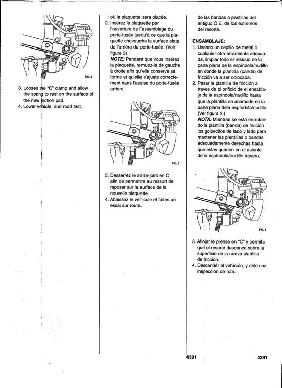

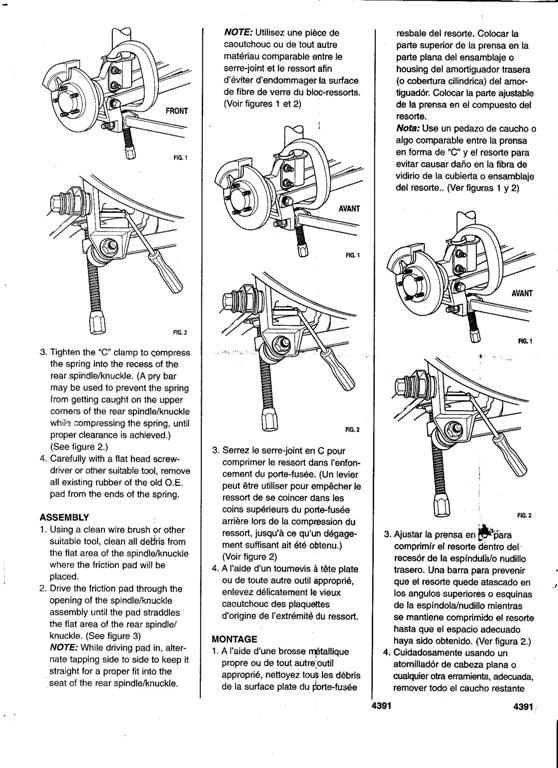

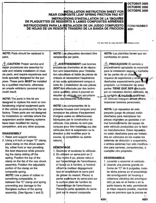

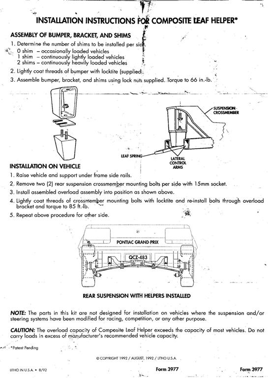

TheDeacon Posted November 19, 2011 Report Posted November 19, 2011 OK, I have a dumb question. Do you still have the instructions from the kit & is there any way you could load a picture of it on here? Please, Please, Please. I'm considering getting this/these, but I want to be as well informed as I can be before I get them and then say, "OH Snap!" Quote
90V6RedHotLuminaEuro Posted November 19, 2011 Author Report Posted November 19, 2011 Hi! Yes I Do... and believe it or not... I kept them for just such a purpose... I'll scan 'em in and get back to you... maybe I can email them to you... later, john b. Quote
90V6RedHotLuminaEuro Posted November 20, 2011 Author Report Posted November 20, 2011 Here They Are... I can email the full sized scans to you if you want... john b. Quote
90V6RedHotLuminaEuro Posted November 20, 2011 Author Report Posted November 20, 2011 I think these will work as download links for the full sized scans... I hope... Moog K6544 Leaf Spring Pads Instructions Moog K6544 Leaf Spring Pads Instructions Page 2 Moog K6544 Leaf Spring Pads Instructions Page 3 Moog K6000 Leaf Spring Helpers Instructions Quote
