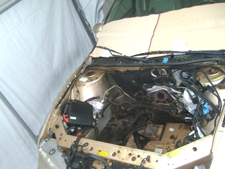

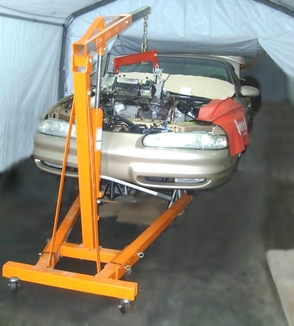

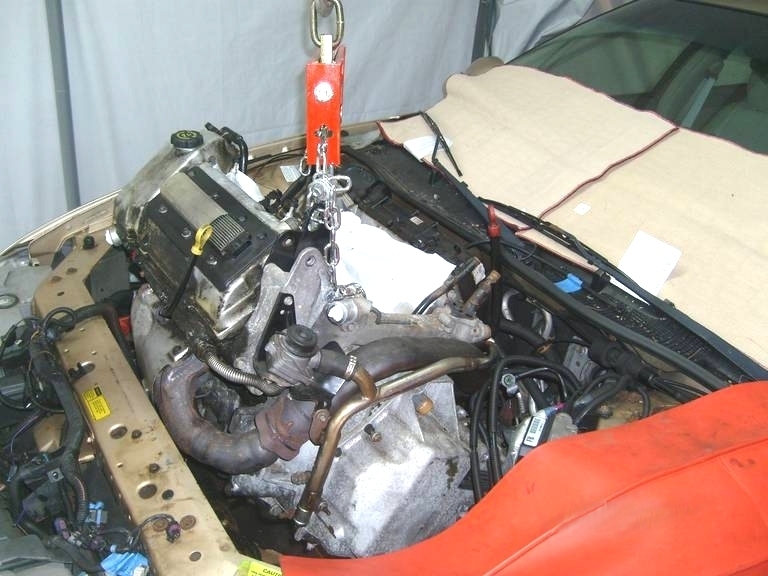

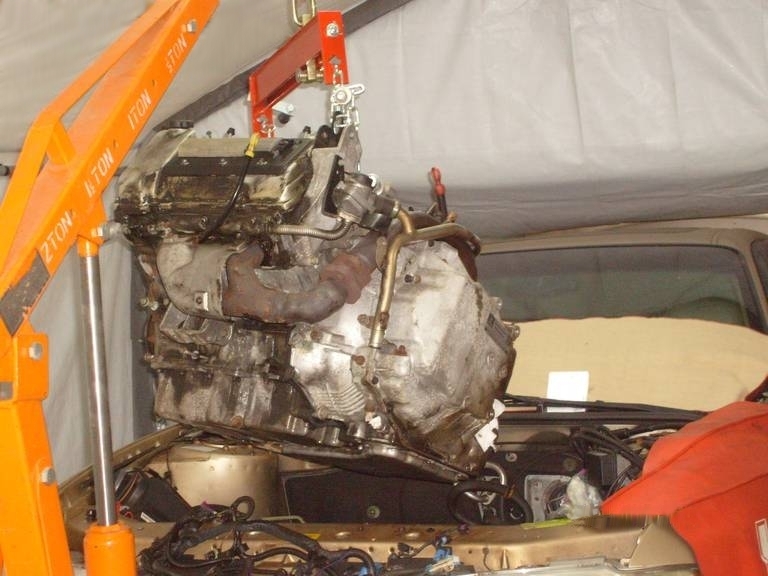

Cutlass350 Posted September 2, 2011 Report Posted September 2, 2011 Some quick pictures of my engine R&R Quote
virtuetovice Posted September 2, 2011 Report Posted September 2, 2011 By the time you tear the engine down enough to get it out, you will have plenty of space to do the work you're talking about. Quote

Cutlass350 Posted September 3, 2011 Report Posted September 3, 2011 My second option is my plan on simply investing $4-$5K and replacing everything. No kidding! So far, I've bought over $3K in parts - not counting the new long block engine! The good news: You can replace the rack with the engine and tranny out, and the subframe still connected. YES! Mine had the classic morning sickness during the winter. It was a PITA to wait ~5 mins to have to drive the car. Even then, the steering was "sticky". Once the weather got better, it was perfect. Hmm, move to Southern Florida or replace the rack? Also, the passenger-side front brake line goes behind the steering shaft. I live in snowy New England. So, that's a great place for sand, gunk, salt, snow, etc to sit on that brake line. I don't know how that super rusty part of that brake line was holding any pressure. It what would have definitely burst in 1-2 years! Now, without an engine, transmission, rack, power booster, master cylinder, ABS, etc, there's plenty of room to work on that brake line. Although, it seems like an extreme method to replace just one brake line. Otherwise, the rest of the Intrigue is in pretty good shape (again, I have a new GM tranny only ~2 years old). One of the head rests for the back seat is discolored. BFD! And, the paint on the spoiler is peeling. I have a few scratches on the car. So, I'll either rattle can the spoiler, or get the whole car painted. A lot will depend on how this mega refresh of parts goes. My timeframe is to try to finish before ~Feb. Also, it seems like GM cheaped out (big surprise) on the flash on the ABS. So, after a while, the ABS module will have flash write errors. GM could have specified more flash, but I guess they didn't want to spend the extra ~$10. The good news is that you can remove the electronics without disconnecting the brake lines, send it to a referb place for ?$150?, get it back, put it back together, and be good for another ~10 years. OR, pay ~$2.5K+ and have the dealer fox it. Quote

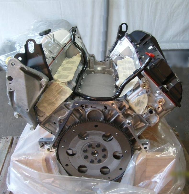

Cutlass350 Posted September 5, 2013 Report Posted September 5, 2013 (edited) Thank you Joe. Not sure how I got attached to an Intrigue ... LOL . Good luck with the tests! Imho, if you do need an engine (or head gasket R&R) and if the rest of the car is in good shape, then put a 100% Brand-new GM long-block in the car for a steal of a price of under $3000! Really, that's a steal. Heck, a POS rebuilt will cost you that. BTW, once these are gone, they are gone for good. Oh yea, GM has been trying to unload these engines for over 10 years, that's why they are so cheap. From: http://paceperformance.com/i-6484856-12458124-new-gm-2000-2002-3-5l-214-cid-6-cylinder-engine.html GM Goodwrench - 12458124 - NEW GM 2000 - 2002 3.5L, 214 CID, 6 Cylinder Engine 12458124 - NEW GM 2000 - 2002 3.5L, 214 CID, 6 Cylinder Engine SKU: 12458124 Pricing: $2599.63 (Note S&H extra ) How the engine comes from GM/paceperformance: Edited September 5, 2013 by Cutlass350 Quote

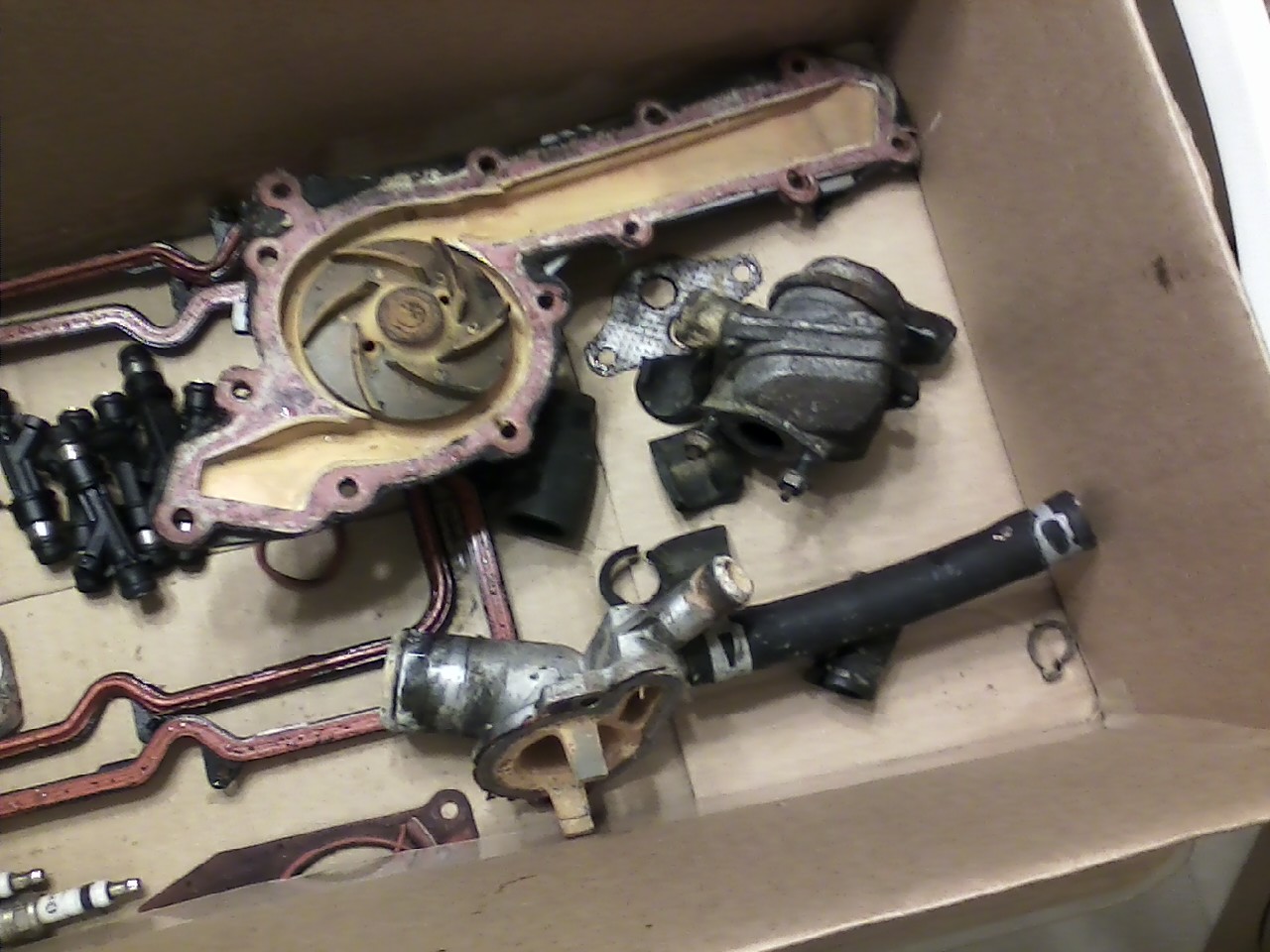

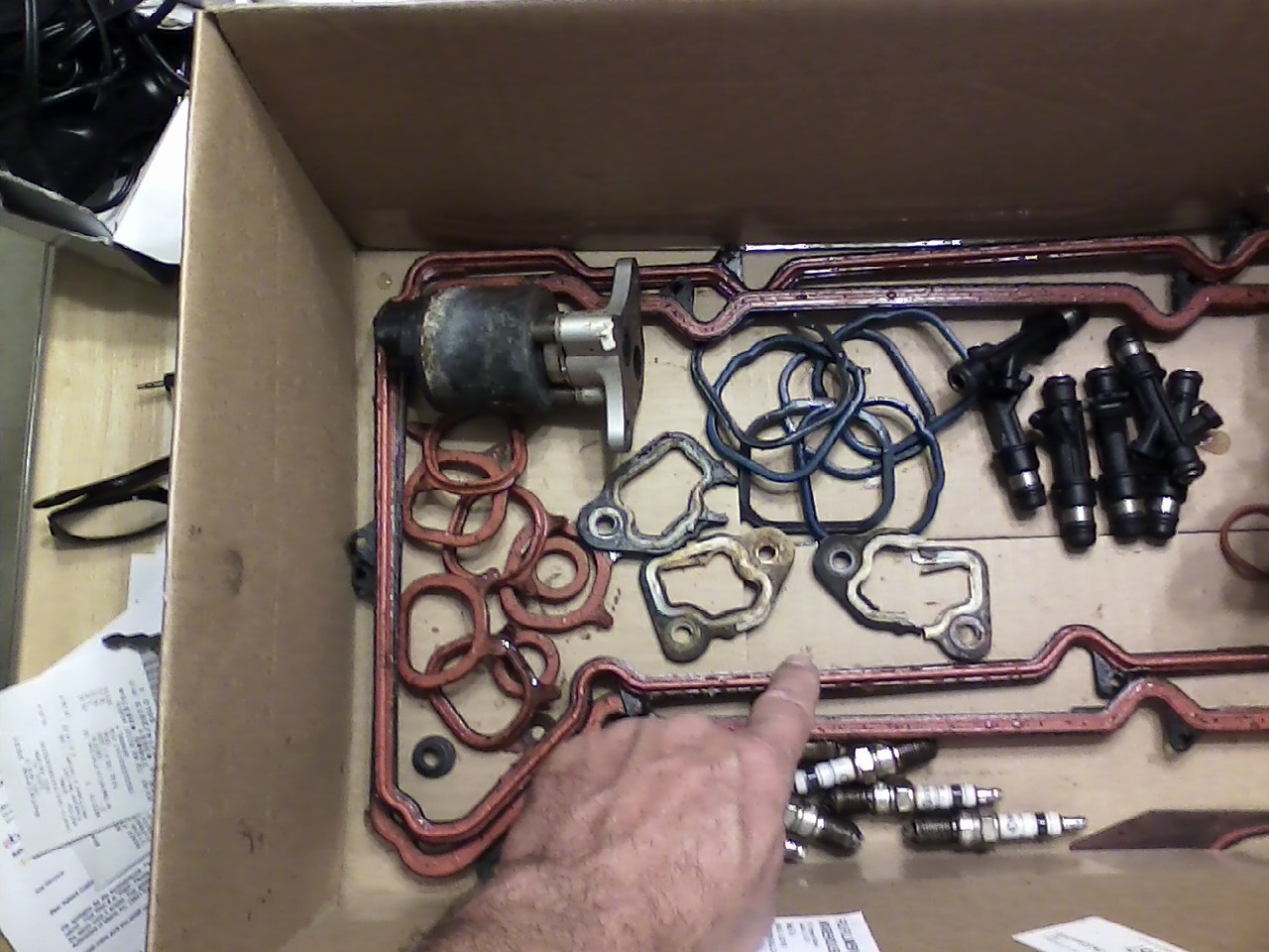

Greazzer Posted October 14, 2013 Author Report Posted October 14, 2013 I invested about 20 hours collectively, and this is what I did. No engine removed, but I wish I did: 1. The dreaded cross-over gaskets; 2. Water pump (AC Delco) and no more getting hot; 3. Valve Cover Gaskets; 4. Plenum Gaskets (x6); 5. Newer EGR and gasket; 6. New spark plugs; 7. New throttle bottle gasket; 8. New AC Delco thermostat housing 9. New Fuel Injectors (Delphi) 10. Removal of about 1 pound of black gooey carbon 11. Oil Change and filer She runs like a CHAMP now. The only casualities were the following: 1. Exhaust donut on front driver's side when I had to remove the 2 bolts to pry the exhaust cross over pipe over about 1/2". I need to replace that as I now have a very low growl. Sort of like it. 2. "Lost" a 13mm Gearhead wrench somewhere in the back of the engine. I hope I find that. It screws up my set of 6. I am very very happy I did this. No more leaking. No more overheating. No more misfire codes. She purrs like the day we drove her home 2001. I cheated a little. The 6 bolts which held on the cross over coolant pipe were shortened by 1/16" or so. One can remove the cross over pipe without removing the exhaust pipe. If you cut off a tiny amount from the PITA bolts, the cross over pipe slides right in. Actually, on reflection, with the slightly modified bolts, I am thinking that if I every had to do this again, I could do it under 3 hours. One does need a very long 13mm gear head wrench, with slight offset. If I had this, then maybe 2 1/2 hours. I did this in chunks of 2-4 hours per day. I wish I could figure out how to post pictures. It was getting late today, but I went ahead and compounded, polished, and waxed the hood. I am going to do one body panel per day. She shines like new money. AND, it has 241, 424 miles on the clock and if you floor it, she SMOKES most of the Rice Burner Tuner cars in my neck of the woods ! Quote

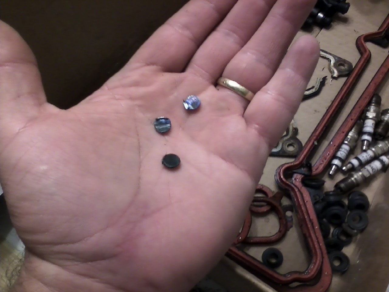

Greazzer Posted October 14, 2013 Author Report Posted October 14, 2013 You can see that 2 of the 3 of the cross over gaskets were completely shot. I was losing about 1 gallon of water a day. Now, I got DexCool in the ol' girl. Also, for all those getting hot and "overheating" issues, I suggest an AC Delco Water Pump. The remans and other manufacturers use a plastic impeller. Here's a picture of junk plastic impeller. AC Delco uses a cast steel one. Also, I forgot to mention that I got my diverter valves changed and my Cali Emissions should be up and running in a few days. NO vacuum leaks ! I got a secondary air pump on order. Just looking for an intact plastic housing Here are the ends of the bolts I cut off. Once the dreaded cross over pipe is removed and the 3 PITA bolts are shortened just a tiny amount, she slides right in AND you can slide it right out too. I had a little problem getting my gaskets lined up. I suggest pushing the bolts thru the gaskets as they are super snug and they wont move a bit once you do that. Here are my thoughts on the dreaded cross over gasket repair: 1. Disconnect the battery 2. Remove air box - filter assembly 3. Remove EGR 4. Remove throttle body AND plate -- its held on by 3 thread studs 5. Remove the 2 bolts which hold the exhaust flange down by the front of the car. If you have Cali emissons, you have to remove the front diverter valve 6. Remove the 6 bolts. You should have a selection of wrenches and sockets in the 13mm flavor. If you have a long Snap On racheting 13mm wrench with offset, great. You can pry the exhaust pipe over about 1/2" and then get another pry bar and slightly tap the bolts out. Like your chiseling the bolts away from the car-- the 2 will shoot out from the car. I am NOT recommending that anyone cut any of their bolts. I take no responsibility if you do. I did this since it was impossible to remove the back exhaust manifold. When I cut the bolts, the coolant cross over component can slide in and out without an issue. I also ran a tap and die to clean up the threads since there was a lot of junk on them. Nice and crisp threads. I used a little permatex just to be sure. So, right now, no overheating, no misifring (I used AC Delco Plugs and Delphi injectors), and no leaking. I used all AC Delco parts or Delphi or Fel-Pro gaskets. In sum, 20 hours, less than $400 bucks and it's a GREAT Ride. GOAL: Detail the car, remaining problems - repairs (less than 10 hours I am thinking and less than $100), and put 300,000 on the clock. That is with an original drivetrain too !!!! Quote
Cutlass350 Posted October 16, 2013 Report Posted October 16, 2013 You can see that 2 of the 3 of the cross over gaskets were completely shot. I was losing about 1 gallon of water a day. Now, I got DexCool in the ol' girl. Here are the ends of the bolts I cut off. Once the dreaded cross over pipe is removed and the 3 PITA bolts are shortened just a tiny amount, she slides right in AND you can slide it right out too. I had a little problem getting my gaskets lined up. I suggest pushing the bolts thru the gaskets as they are super snug and they wont move a bit once you do that. Wow, great job! Congratulations on getting the job done, and at a fraction of the price that a garage would charge. And, thanks for the tip! The diverter valves and the AIR pump aren't cheap. But, they have also lasted over 10 years. How much did you pay for the new injectors? I saw that they go anywhere from ~$27/each for reman to ~$125/each for Delco. Quote
Greazzer Posted October 16, 2013 Author Report Posted October 16, 2013 Wow, great job! Congratulations on getting the job done, and at a fraction of the price that a garage would charge. And, thanks for the tip! Thank you Sir ! That car with 241,478 miles on the clock drives like a dream. I did some little traffic code violations today and the performance is amazing right now. FAST, SMOOTH, and PEPPY! And yes, I called the dealer before hand for kicks and the quote for the repairs and maintenance was over $3,000 ... NOT ! The diverter valves and the AIR pump aren't cheap. But, they have also lasted over 10 years. I always look at the junkyards. I found 2 "new" ones which were clearly recent replacements before the car got junked. They held perfect vacuum overnight before I installed them. They certainly looked new to me. $5 bucks each! The pump is $150 shipped. AC Delco. I am just looking for the bottom half of the plastic housing. They all crumble. How much did you pay for the new injectors? I saw that they go anywhere from ~$27/each for reman to ~$125/each for Delco What ? I got my set of 6 for $154 SHIPPED. These were OEM Delphi, NEW. Got them off Ebay. The old ones had the same exact numbering and markings and they were the originals. They came ready with O-rings, plug and play. I asked the vendor on Ebay to ship USPS Flat rate box $5.80 and he agreed vs $12 UPS ground. This weekend is air box time. I am slightly mod'ing the air box and adding a semi-cold air system. Going thru the fender where the secondary air pump is located. Tight squeeze but I am thinking it will work. The 3" tubing will snake thru there. Just a little concerned over the K&N Cone and fitment issues. I am totally ticked off at myself in doing the brakes last year. I got new rotors, new front wheel bearing hubs, new calipers, and pads. I now want to do the 12" big brake upgrade but I got to wait until these wear out. I think the calipers got a life time warranty and maybe I can sweet talk the Autozone guy into a swap. If so, I will do the mod within a year. Next year, I am replacing the original CAT with the upgrade and the few other mod's which are available. Slim pickings for mods and upgrades. However, all the various R&R maintenance items are pretty cheap after you shop around. I will post my market research and various pricing. I was pretty surprised as to affordability. Once the exhaust leak is fixed, once the air filter is replaced / and - or mod'd, and I swap out the 8-9 different solonoids, valves, which regulate fuel, air, and emissions, it will be time for the RESTORATION -- New Carpet New Headlights Dye the Seats Window Tint She will look like new. Once I buff and wax her this weekend, I will post some pictures. I did the hood yesterday. Today, took the day off. Quote
