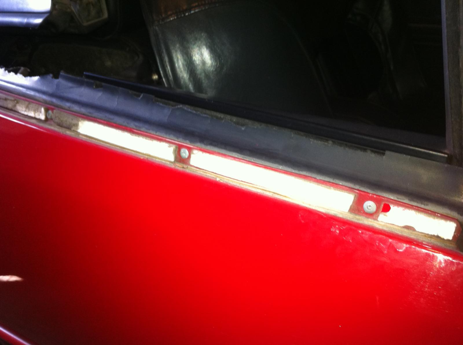

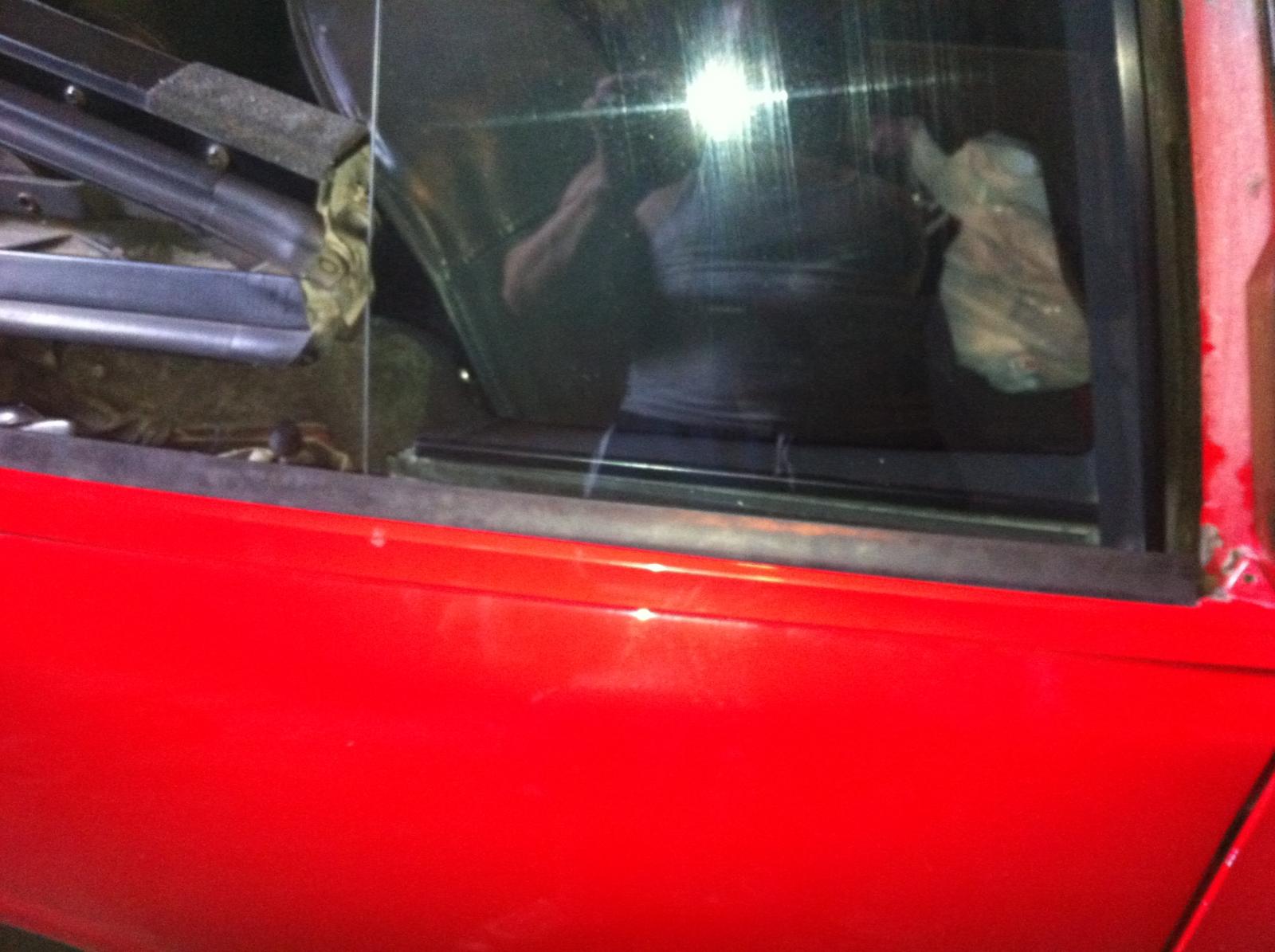

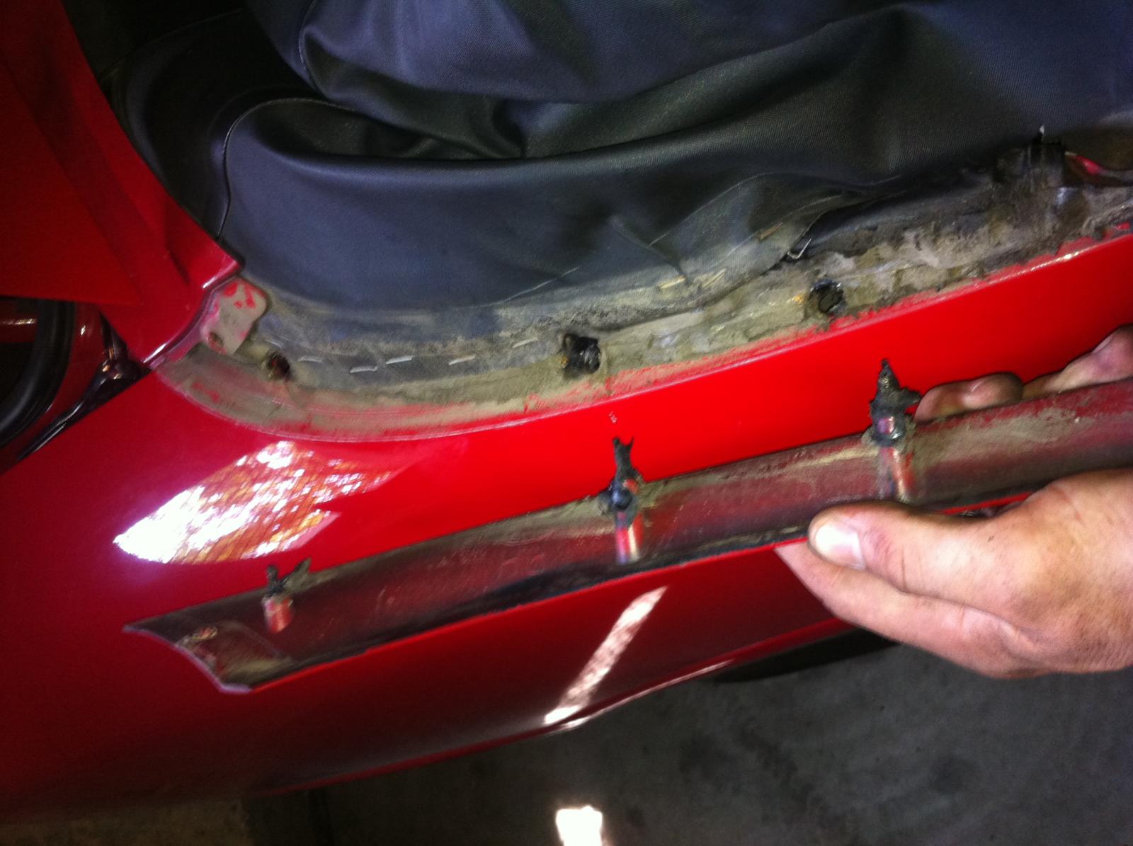

Remove the plastic trim peice.Drill out rivits very carefully!!!! You can break the glass. It will shatter if you hit it. I stuff a couple rags behind the rivets so my drill bit wouldn't go threw. Then take your new peices and pop riviet them in.
To remove the trim there are 3 8 or 9 mm bolts inside the truck. Under that trim peice. I had to crawl inside the trunk to get at them. I hope these pictures help.

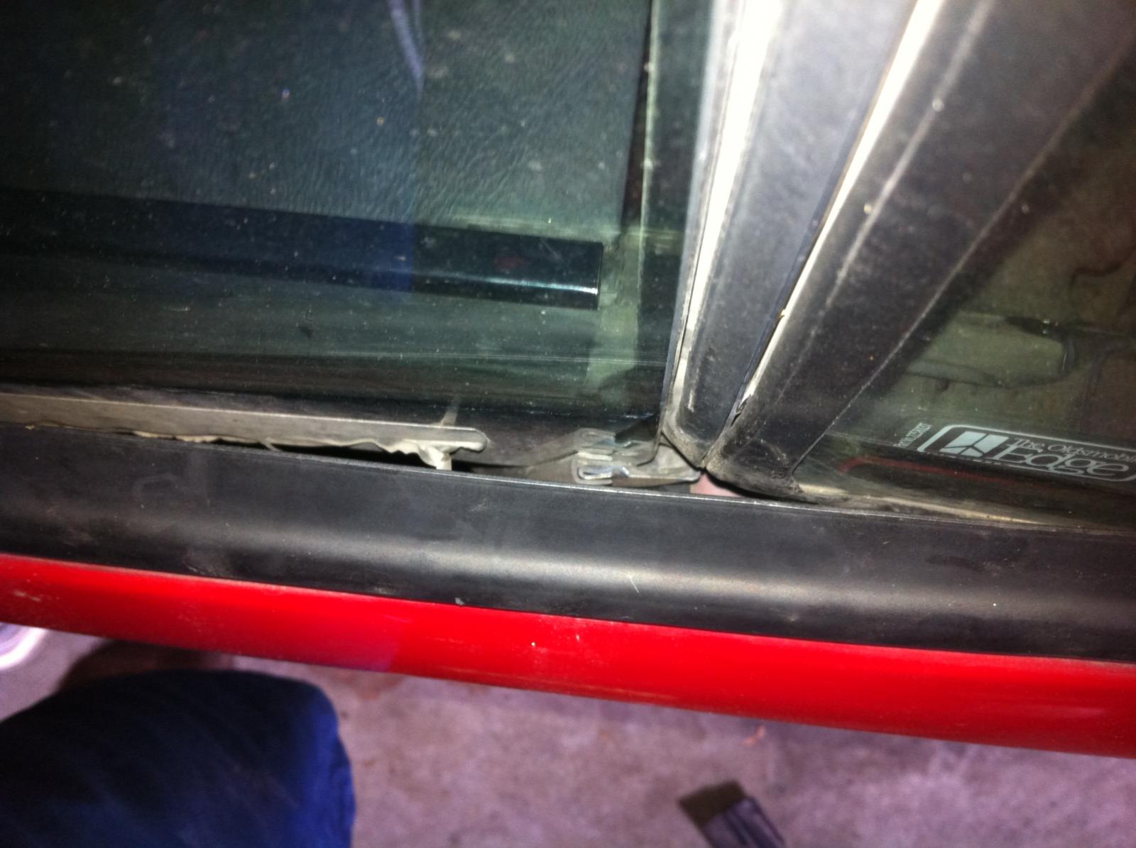

I did this to mine too. I used seals from a camaro door. they seem to be a little thicker where the rubber is attached to the metal part, so I think it pushes out on the convertible trim when you put that back on. They turned out nice but I have a gap between my glass and the new seal, especially on the drivers side. Not sure if that is my fault or if there is an adjustment on the window to push it out.
For the plastic trim piece, don't forget the screw on the B pillar. You have the take the black metal trim off the pillar first to get to that screw.
Edited by xennith
I used a knife to cut that "thickness" down that pushes out on the trim.
